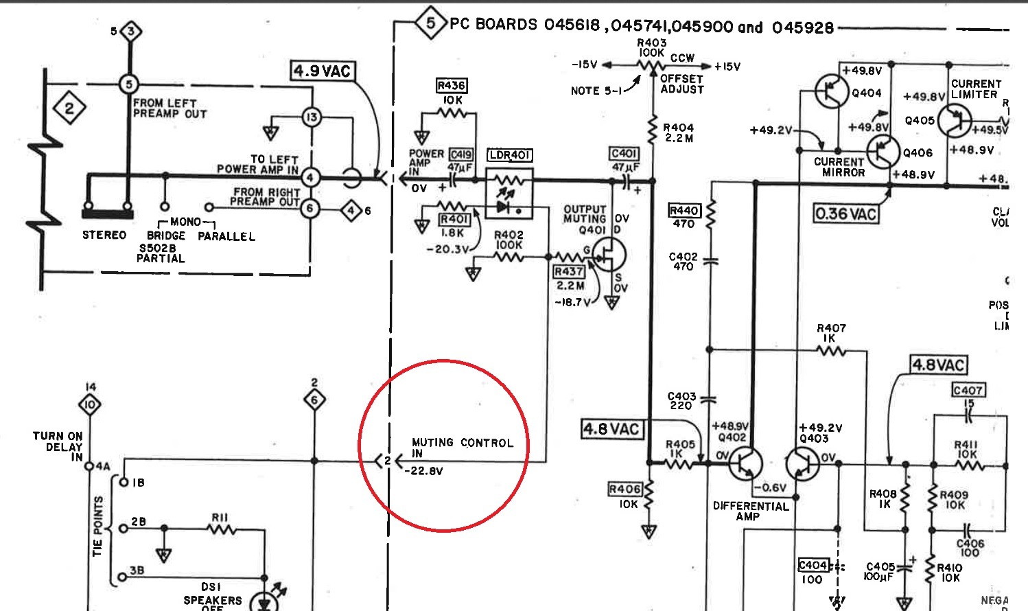

They checked the mute control yesterday. It is giving -21 volts.The mute circuit is more than the optocoupler. For example, it also includes the -22VDC voltage supply,
the two coupling capacitors, and the FET.
Proper mute circuit operation must be verified operationally.
Connect a 1V 1kHz sine to the amplifier input.
Verify the signal is present at the positive lead of C419 with a scope.
Verify the signal is present at the positive lead of C401 with a scope.
If the signal is present at these two points, the muting circuit is functioning normally.

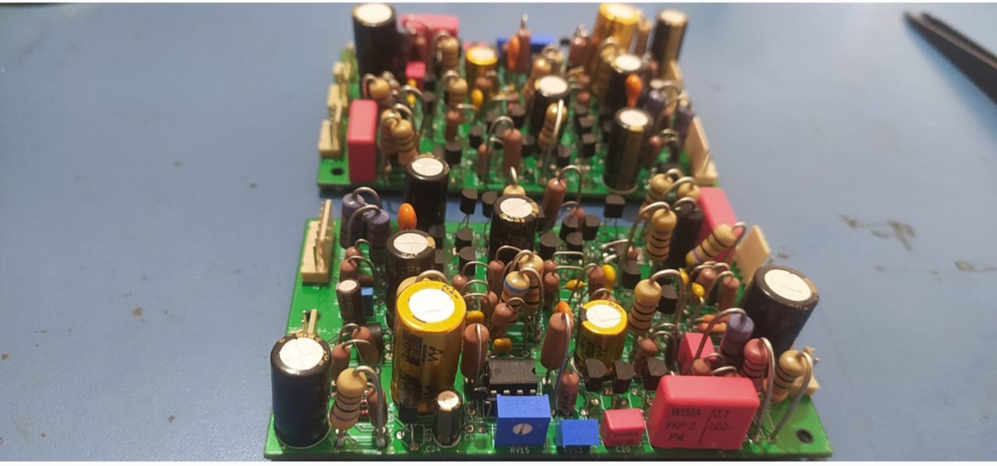

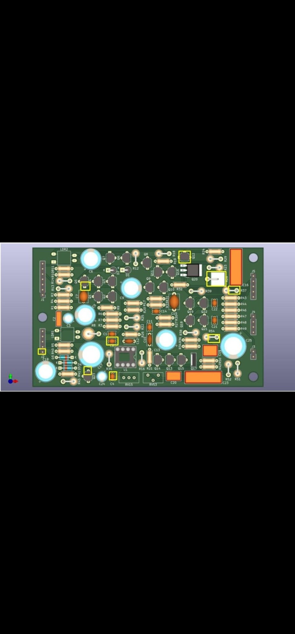

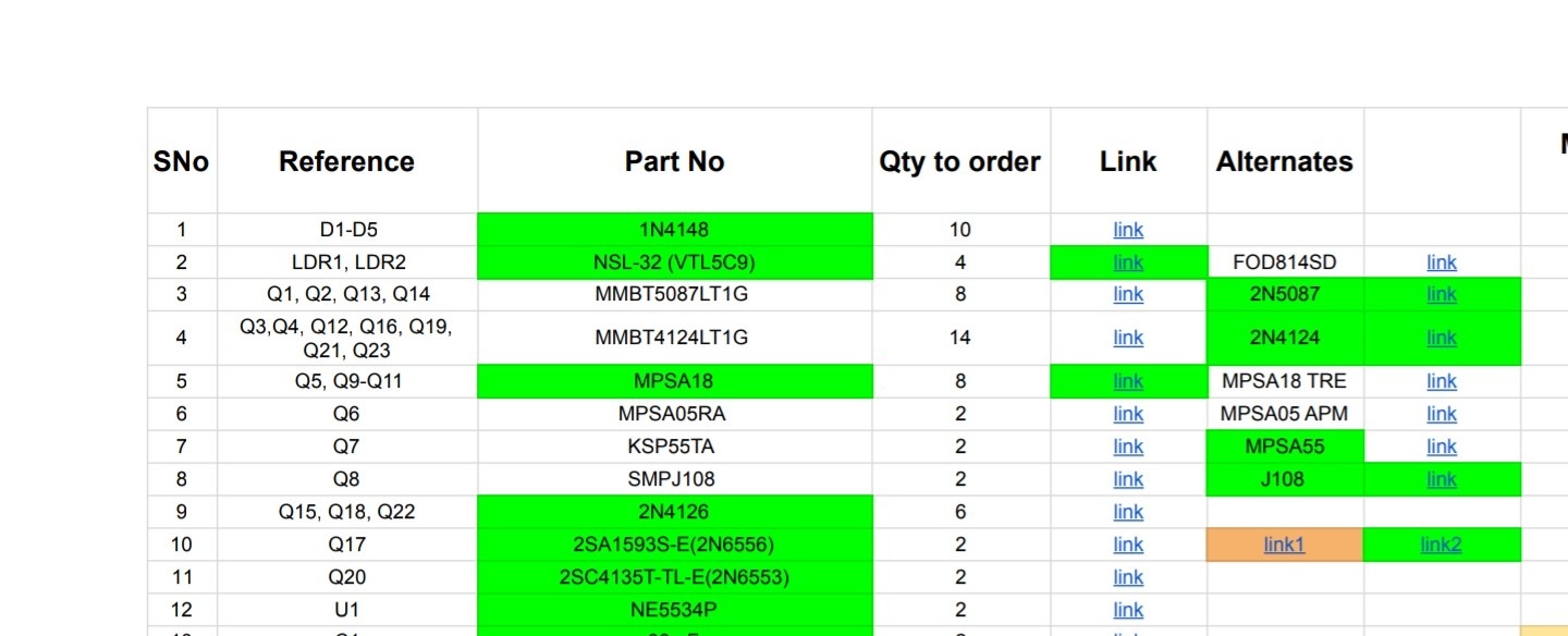

Hey everyone…it seems this thread has been dormant quite a while, but I’m even more desperate than Saran was when starting out. I recently purchased a MC2500 that was missing both preamp boards, the power supply board, the cap/interconnect boards, and the meter board. Some are available on eBay at or beyond top retail prices, so I’m looking for suggestions on alternative replacements. I have an objection to buying from someone parting these units out for profit instead of repairing them and putting them back in service. Long story short, I need a full (or partial) set of unpopulated boards to build up or someone’s cast offs needing a lot of work. I have the ability to create the boards, but prefer to not to reinvent the wheel here. Anyone with parts or any kind of assistance would be greatly appreciated!
Hi 928,
The most important step has already been taken by you. YOU HAVE ONE OF THE BEST AMPLIFIER EVER MADE. Now, nobody is re inventing the wheel here. The factory is simply not manufacturing these boards in a long time. Any other decent repair facility, won't touch the amps anymore without any replacement boards. Then you turn to online used boards which are as you say, overly expensive, maybe a scam and most importantly, could already be faulty boards or working boards that are in very so so conditions. Your best alternative, go make new boards yourself. You will know the board's quality because you are making it yourself and you can use decent parts. You will have a new board at a decent price, that you would never have to worry about again for a long time. If you need any help, please do not hesitate to ask. I will tell you what I know.

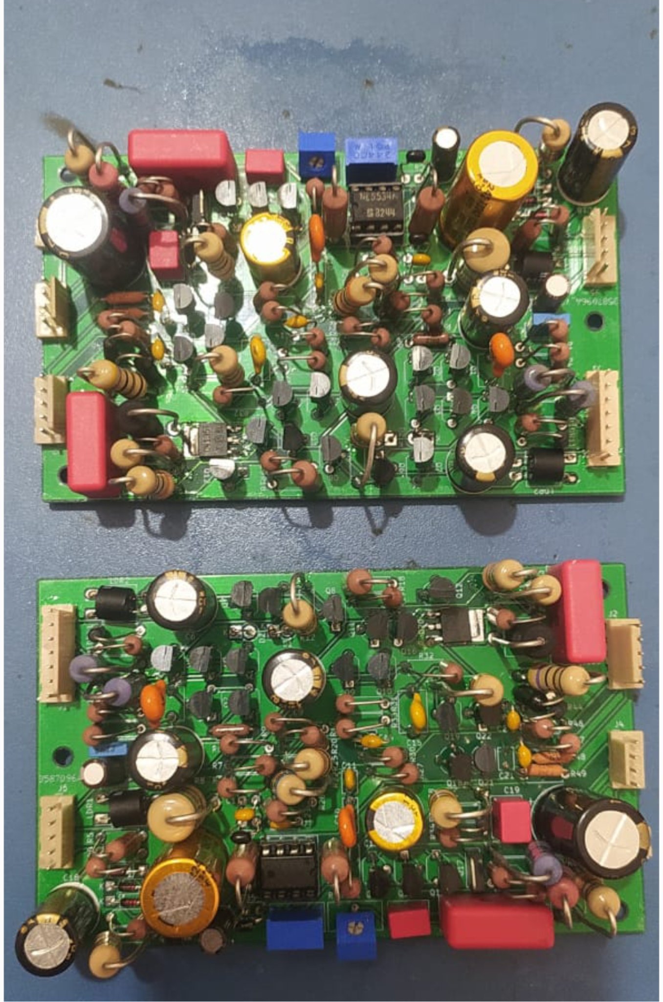

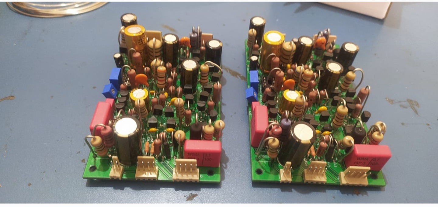

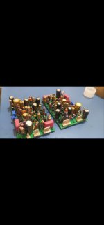

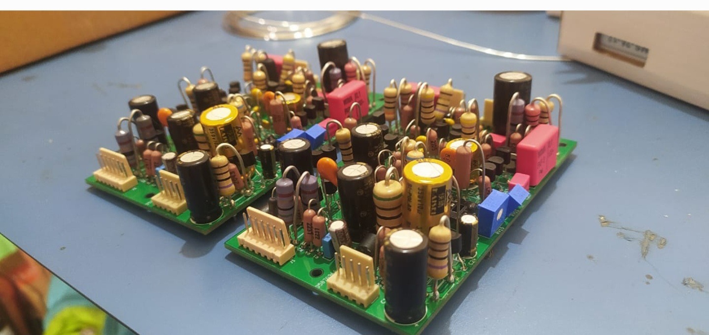

Now, this post is anything but dormant. My sincere apologies for not updating. The problems with my new boards where never diagnosed. The engineer who made the boards and the McIntosh technician tried but could never get the amplifier to work. The boards gave all the correct readings but there simply was no sound. When one of the older working boards where switched in, immediately the poor amplifier sang. They have given up and the McIntosh technician is returning back my amplifier in as is condition, sadly without it being repaired as they are unable to. I now probably have to spend a fortune sending it to Audio Classics, hoping that they will repair it. I will keep updating all of you as it goes. My sincere gratitude to everyone who helped me along the way.
Thanks for the reply…and please note that I meant no disrespect about the reinvention comment. I was just hopeful in that someone might have already developed new boards that could be purchased and used, or have a set of discarded ones gathering dust. I am happy to begin the board-making process. If I am successful, I will likely build up a few extra to help recoup some of the associated costs. I have photos of the boards (front and back), so it should be easy enough when accompanied by the schematics. I will be doing this in my very limited amount of spare time, but I will check back in from time to time with updates. Thanks for the info everyone has been passing along, and the words of encouragement.
I think you were poorly served by an inexperienced "McIntosh technician".
A problem like this is just not that hard to resolve.

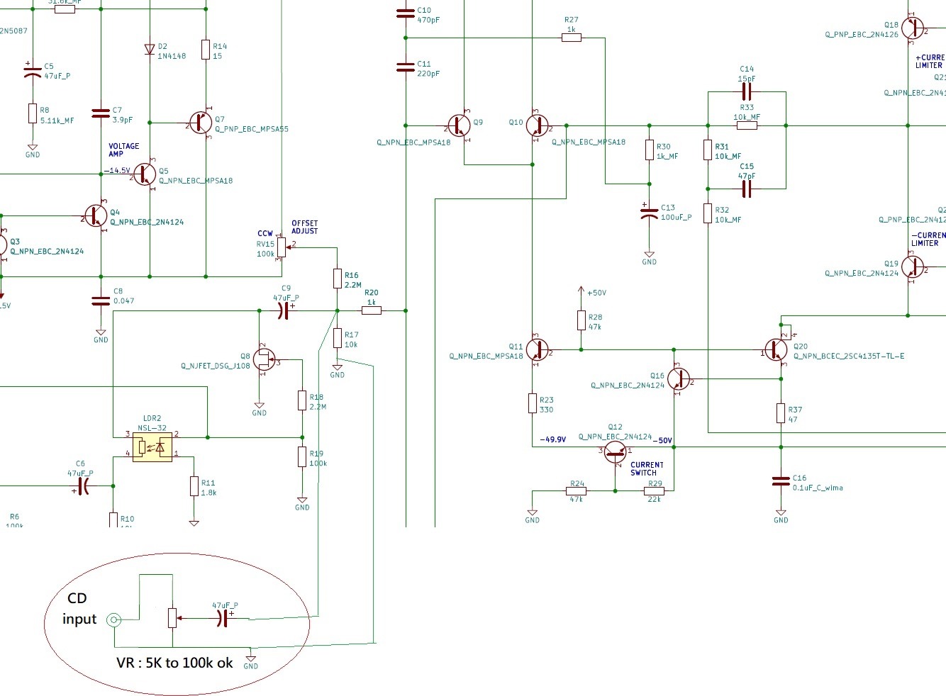

I still have the schematics you provided, but if you sent voltage measurements (post 17), I'm unable to find them. I recall there was some probing of the mute circuit that didn't seem fruitful. I would suggest checking voltage across R11; it will confirm activity of the coupler LED and related activity at the gate of Q8. I drill deeply here to encourage. 😉
