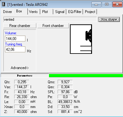

Mattes, I have these teslas in my present OB project (Tesla ARO942 + Isophon P1834 + Aurum Cantus G3Si) and it sound very good, despite Qts is quite low for OB.
Below some old measurement that I have made long time ago. The only issue it that they need transformer to decrease impedance, becouse they are 32ohm.
ReinoutdV, great project and really expensive drivers;)
At this moment I will almost for sure buy LB8EX (but first I have to hear it:)), and in the future LB15EX or I will modify teslas and make them field coil drivers.

Hi Mattes,
No I havn't try 2 per side yet, but it could be good idea. If I connect 2 teslas per side it will give me 16ohm for bass units. Due to higher impedance teslas will play quiter but at the same time 2 drivers per side will give additional 3db and also effectiveness of teslas is 98db where LB8ex is ca.94db...so theoretically this could work;)
Hi Sebas,
2 per side will give you at least some more headroom, also for EQ. I doubt that the Teslas will do 98 dB in the lower registers in OB... the lower you go, the higher is the efficiency toll to pay. You´ll have to add rising response due to baffle loss and Qt of 0,3 to your calculations. Baffle size, position and the room are further factors - better is measuring instead of guesses. But, OB is not easy to measure...
However, be prepared for some contour shaping with the LB8, without that I found it a bit too agressive for my ears. But of course, YMMV.
All the best
Mattes
Hi Mattes,
you are completely right. In the bottom (till ca. 60hz) it will not give 98dB, however 2 dirvers will give 3dB more then 1, so worth to try;)
Of course the measurement is a must.
