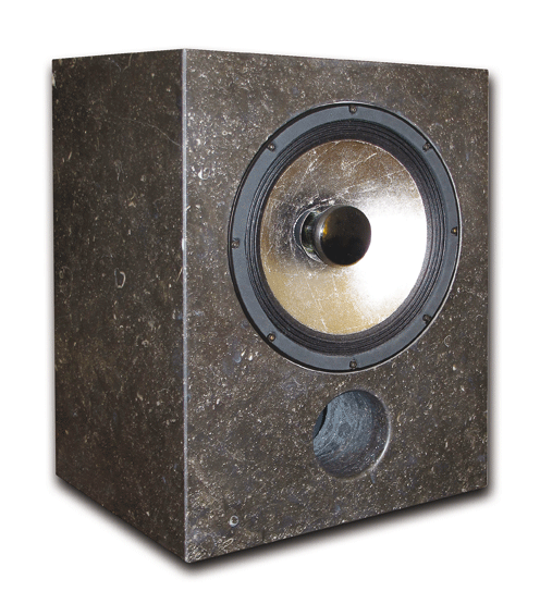

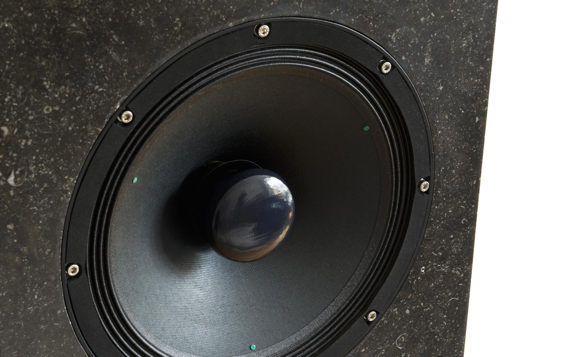

Anyone with listening experience on EMS LB 12 EX 12" full range field coil driver
It will be an interesting experience (... and expensive.)

Plus, I have the musical audition of this speakers in a magazine. :D
The name is "Stereo Prestige & Image nº 84 Decembre 2013" - "Madotec Enceinte Bleue" you can read it here.
http://lenceintebleue.com/wp-content/uploads/2014/01/s-i-84a.jpg
http://lenceintebleue.com/wp-content/uploads/2014/01/s-i-84b.jpg
http://lenceintebleue.com/wp-content/uploads/2014/01/s-i-84c.jpg
http://lenceintebleue.com/wp-content/uploads/2014/01/s-i-84d.jpg
http://lenceintebleue.com/wp-content/uploads/2014/01/s-i-84e.jpg
14.12.2013 / Banc d’essai de l’Enceinte Bleue dans Stéréo & Image Prestige n°84 de décembre 2013

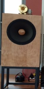

I'm running LB12EX in ~43L enclosure, no crossover on LB12 + Fostex t500a mkii high-pass 12dB @10kHz + REL T5 @60Hz
I’m not yet ready to go to too much details, speakers are working for just a few week, but first impression is very good, refine and very dynamic. Very sensitive to a field coil power supply quality.

Finally, can you share a picture of your speakers?
And that is a very important part for me: "bass department". I was thinking in an open baffle "a la Musical Affairs", but I'm concern on the low frequencies.
Can't comment on that. Personally I think open baffle is a waist of resources.
Here is my speaker ( without bass channel ).
And what woofer or SW are you using for the below 100Hz?
Interesting to see projects around this drivers. You add a tweeter also....have you tried without the tweeter? according to the specification they only can deliver 15000, maybe a little less I guess, but I believe that the impact ins not that noticiable as the bass extension---or I'm wrong?
Cathy told me that some of shes customers use just a capacitor as a minimal crossover to match the 12EX...
Thank you again for sharing
By the way, your speaker looks great. Nice work on the cabinet.

SW are (temporary on loan) pair of REL T5. Eventually there will be line array with dedicated amp., but RELs, actually not bad at all...
Tweeter: I tried without, I tried RAAl lazy ribbon and end with Fostex 500-mk2 , crossed at ~10khz (or 12 ?), 2nd order and auto transformer.
Around this driver, tweeter would be my last worry. First would be to decide on the type of enclosure. From personal experience I would not go OB route (in my opinion you wont get bass with it anyways and will need another solution for bass. Also you will turn your room into device that you will need to tune to get the speaker play right if it possible at all with OB).
As for the TQWT, back loaded horns, ported cabinet etc. you can get some kind of "bass" mostly "one note" and ruin mids and lower mids.
Again, it is my opinion and nothing more...
