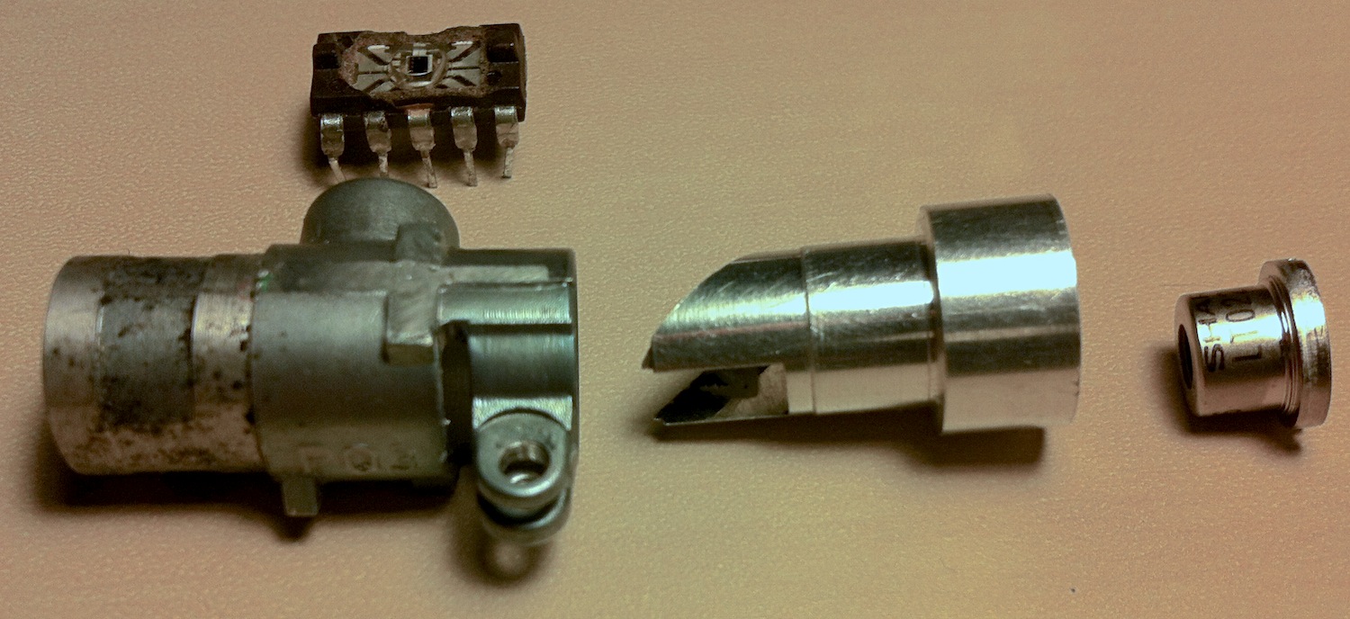

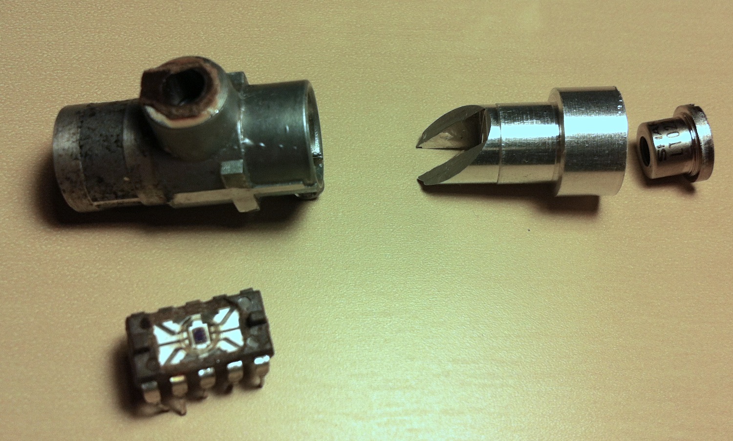

I am resurrecting this thread. I am looking for a dead CDM-1 as well.
Dead means: Laserdiode is definately dead. Without looking straight into the lens one will notice a red dot when the Player checks if a CD is present.
Goal ist the same: Trying to swap the diode. With 3-beam lasers almost impossible because a diffraction grating has to be aligned. With CDM-1 maybe more possible. because it is one beam
Also, the original Diode (Sharp LT022MC - also to be found in early Sony Players) seems to be thight fitted in the housing.
So maybe distance and angle (in a clock-like manner) may be the imortant valuesm, whereas with Sony Players, horizontal alignment may play a role as well.
I have two CDM-1 Player (CD-304/104) but do not want to sacrifice them, because laser is still working.
BTW:
On one Player, swing arm is dead. Laser works,
focus works, CD spins, but arm does not move at all, even when power is turned on. Arm is not jammed, it can be moved freely.
Any advice on this is welcome as well, Voltages on the power supply board seem to be o.k. Ground contacts seem to be o.k.
Back to topic:
Like those images indicate
installment seems to be easy.
But big problem:
In the very moment, it is absolutely unclear how to pull the original Diode from it´s housing, 2nd from right.
The guy wo send them to me did force the diode out by pushing from top with a thin shaft, therefor removing the prism first and cracking the diode´s glass.
If anyone tried to remove the diode as well, his experience on this appreciated.
