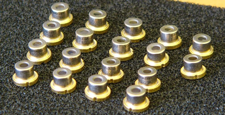

Recently I've been looking into replacing the laser diodes in the aging Philips CDM-0 to CDM-9 series CD mechanisms. I found that all the radial armed mechs, right from the first generation CDM-0 of the early eighties to the end of the line CDM-9 of the nineties, used the same laser diode. I was surprised, I kind of expected to see a change over the fifteen or so years these mechs were around.
Anyway; I managed to get hold of a bunch of brand new laser diodes of the same brand and model, complete with 'bling bling' gold cases. However, I don't have any suitable candidate mechs at the moment, so:
Does any of you out there have a tired old CDM-0, CDM-1, CDM-2 or CDM-3 which you want to have an new lease on life?
I'm interested in replacing the laser diode on mechs where:
- The laser is truly worn out, not the electrolytic capacitors in the player. Too many times the laser is blamed when it is the servo's fault.
- The mech has been treated properly (especially in regards to static precautions). Static discharge destroys photodiodes, there is no way to rescue a static damaged mech.
I essence, I'm looking for mechs where the laser is at fault, not something else.
I'm offering this for free, hopefully there are a few people out there that are keen and have mechs that fit the above criteria. I'm quite excited about this experiment, as if it is successful, we could get a lot more life out of the radial armed mechs yet!
I'm only keen on trying the earlier variants at the moment (CDM-0 to CDM-3), the later variants are more compact, and I don't even think the diode is replaceable for some CDM-4s, due to the construction techniques used.

I don't think diode placement will be too much of a problem. If you look at the tolerances of the diode itself, and the way that they are installed into the RAFOC body, you will see what I mean.

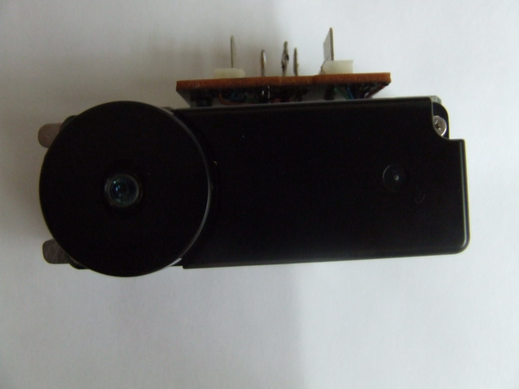

@ restorer-john:

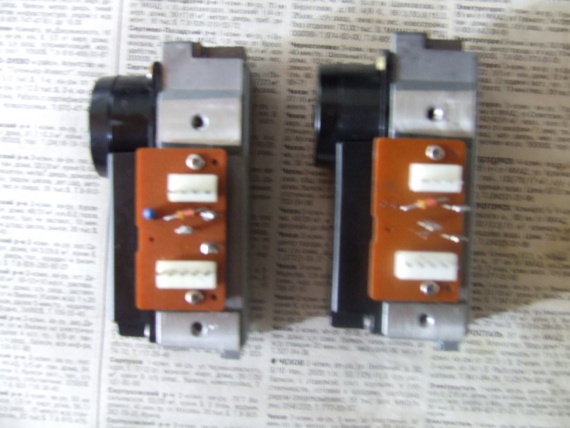

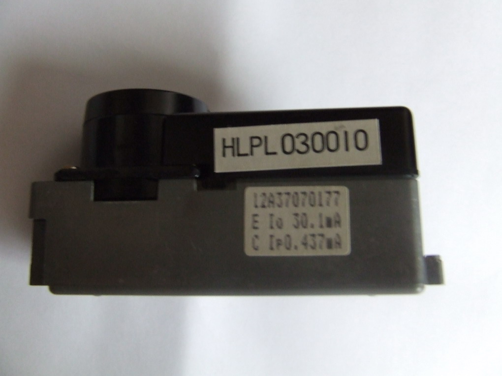

the optical pick up, what you need, was manufactured from the follow three brands:
1) NEC HLPL 030010
(no informations online, see jpg attachement)
2) Toshiba OPH-31 (no informations online)
3) Olympus TAOHS informations about follow weblinks:
http://www.olympus-global.com/en/corc/history/chron/1960.cfm (see 1980-1984)
http://www.aomori.olympus.co.jp/en/company/history.html (see 1988)
http://www.okaya.olympus.co.jp/jp/introduction/ (see 1986)
http://translate.google.de/translat...p/jp/introduction/&sl=ja&tl=en&hl=de&ie=UTF-8
http://books.google.de/books?id=zNm...&resnum=8#v=onepage&q=Olympus "TAOHS"&f=false
This optical pick up was inside by the follow first generation models:
Universum AD2000
TENSAI TAD-2000
ROTEL RCD-870
PHASE LINEAR 9500
MICRO CD-M1
KYOCERA DA-01
Kenwood L03DP (L-03 DP service Manual printed in japanese from 1982)
ClairTone 2704
BETA LASER ADD 200
AKAI CD-D1 (CDD01)
As I know, the type of the used laser diode you can find in the service manuals but it is hard to believe for me, that the reason for errors at your device is really the diode itself. In most cases there are other reasons.

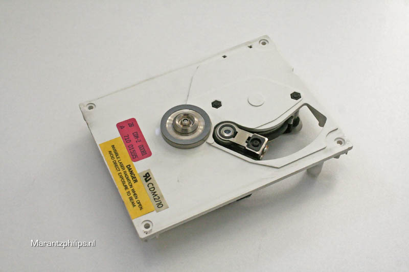

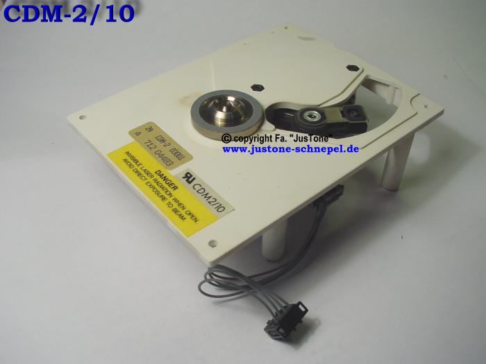

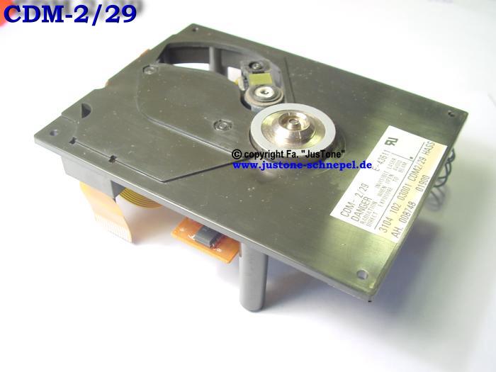

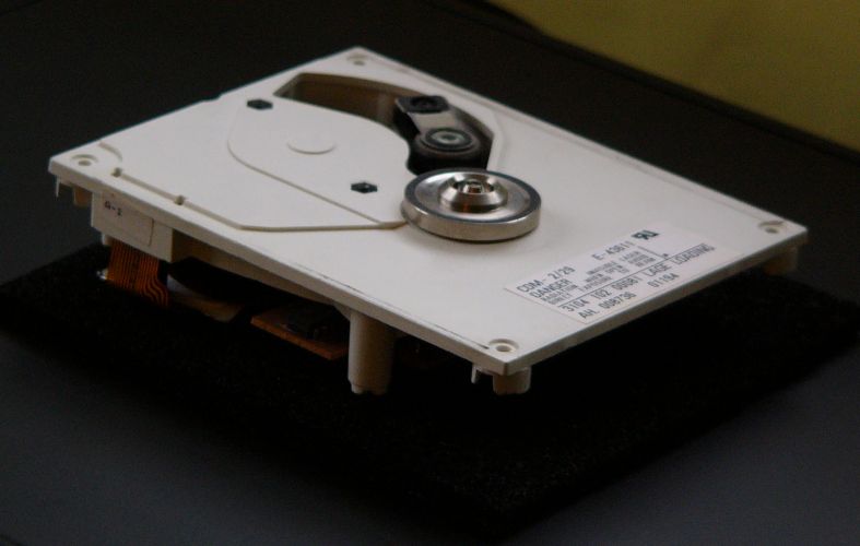

If you have a CDM-4/19, and want to replace it, just get any other CDM-4/19. But, if you've got a CDM-2/10, and you get another CDM-2/10, you can go very wrong. You have to go off of the four digit product code suffixes. Why, Philips, why?
Heres an example, using photos (some are my own, some from elsewhere on the web):
1) CDM-2 0008 labeled as a CDM-2/10
2) CDM-2 0008 labeled as a CDM-2/29
3) CDM-2 0300 labeled as a CDM-2/10
4) CDM-2 0300 labeled as a CDM-2/29
You would assume (1) and (3), the 2/10s, and (2) and (4), the 2/29s are the same, but they're not.

I am, I just need to confirm the laser diode inside my Akai laser head is indeed the same- will be in touch
