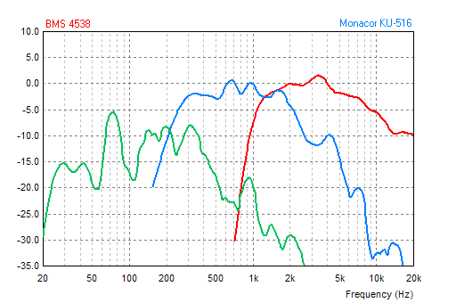

It seems that there are a number of PA compression drivers out there that at least have the same bandwidth of vintage ones(WE and company). Anyone using them?

I used Monacor KU-516 with good results (Universe 3-way).

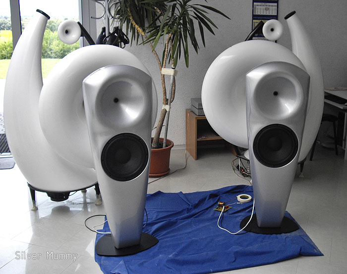

It's like having affordable coax driver (BMS, BC) without its phase fidelity. Such a large horn I would recommend use with 8"-12" midwoofer, 2 or 3 octaves above 80Hz with midrange-tweeter driver in smaller horn like here:
http://horns.pl/galeria/Zoltan_2.jpg
(supravox mid + radian tweeter)
plus distributed subs (eg. Rythmik Audio?). For me sound is relaxing and constant regardless of volume. Subjective opinions -> StudioSound
