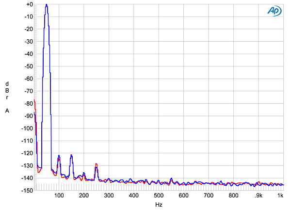

When i see some preamps lab measurements i am always amazed to see how they can deliver 10 but even 20V with almost zero noise and distortion ... perfection 😱
An example
https://www.stereophile.com/images/315B2110fig6.jpg
spectrum of 50Hz sinewave, DC–1kHz, at 10V into 600 ohms
if limited power is enough it is just a matter of adding current. I should look for a high current buffer instead ? but they are more rare than a red cow ...

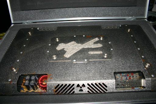

Super car amp is phoenix gold zx400 or zx450 or reactor
Hi ! thanks ! found one now ... Phoenix Gold zx400 ti - Audio/Video In vendita a Pistoia
