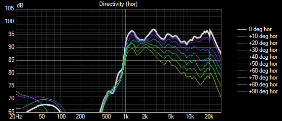

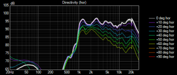

If you are interested in how a ribbon with a horn (eg. NeoCD3.5H) compares to one without (eg. NeoCD3.0), have a look at my Directivity study

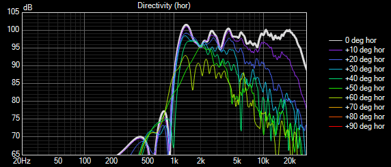

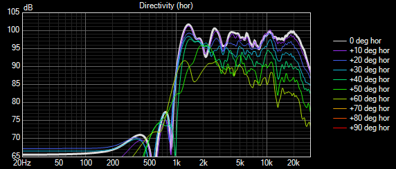

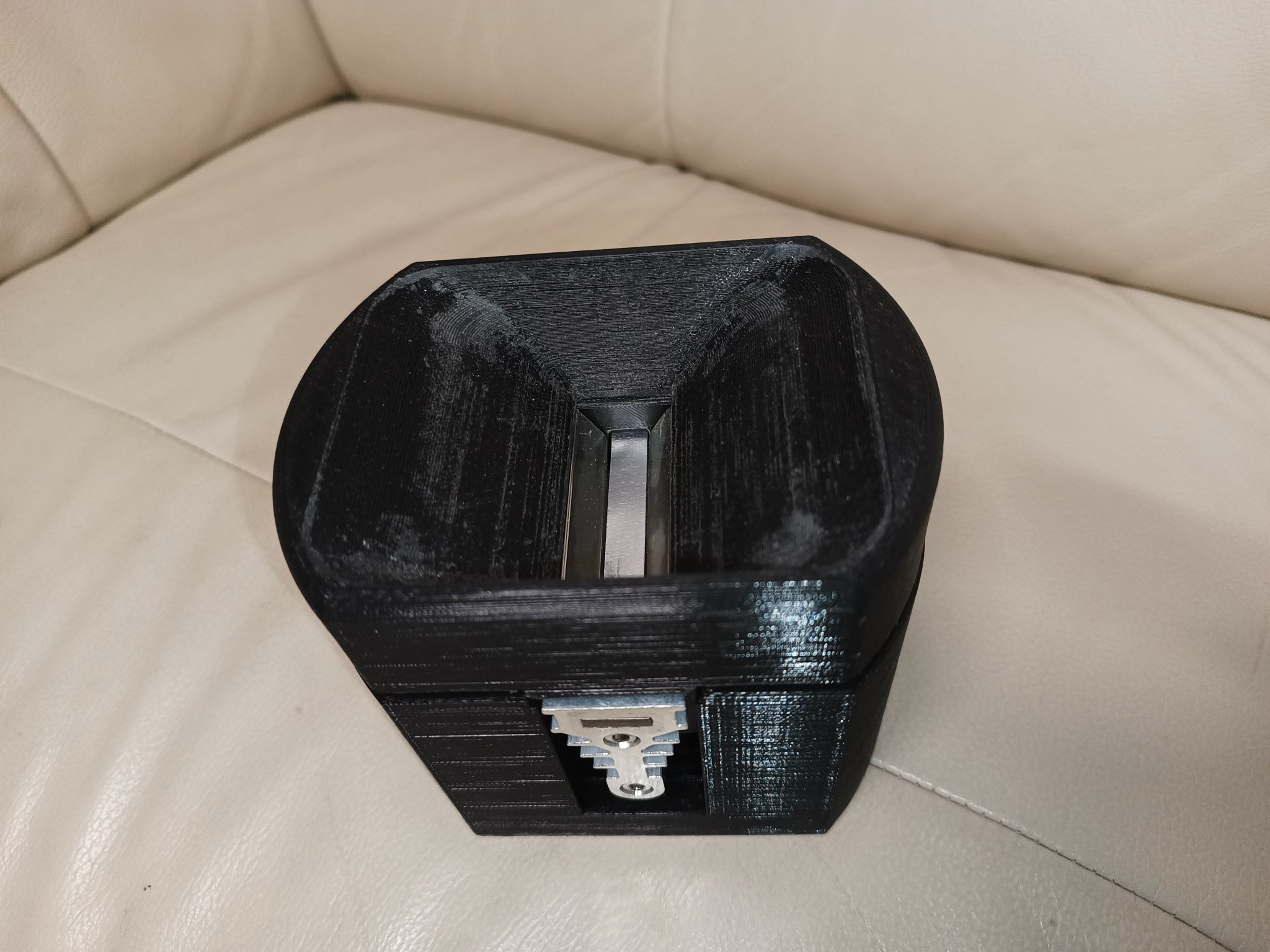

I've been recently playing with the Fountek Neo CD3.5H, designing a waveguide derived from ATH4 OSSE (at least horizontally) for a project. See below. - A couple of points though: the measurements are in 8 degree steps not 10 as shown (because I screwed up the dividing plate setting when machining the jig for setting the polars - I was aiming for 5 degrees!), and ignore the scaling.
As you can see from the photo I removed the protection grill so I could get the waveguide to start as far back as possible to where the metal part ends (I saw this done by Patrick Bateman on this forum some years back and decided it might be a good idea). The first set is the standard diaphram and horn horizontal polars that I did a couple of years ago for my previous project, (they didnt integrate too well with it and so didnt work out and later sold on), the other two sets are from a pair purchased more recently but with a replacement 11 micron aluminium diaphram. I also have one still with the yellow sandwich diaphram that I havent got round to testing yet - maybe in the next week or so. I'm going to use them above 8kHz.
