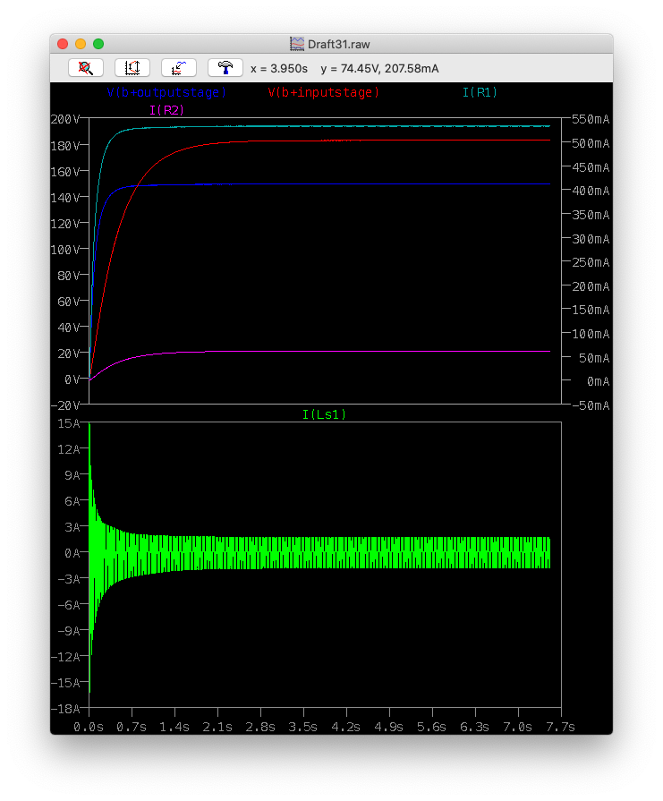

Ok, so I have made a combined parallel secretary bridge and voltage doubler. I've made a simple model, then used a LPF passives and finally a dummy load to ensure the current at the voltage - just to see what it could support and what is the final draw through the secondaries.
Top - 180V @ 80mA and 150V @ 500mA then bottom, the current through one of the secondaries.
Current peak during the normal operation is 1.64A as a spike. Or 3.4A total spikes from both secondaries. The hammond 300VA supports 1.36A or 2.72A both max.. way way short once you add in the passive LPFs. If I look at the FFT of the B+ lines there's still a load of noise at 100Hz for the output stage, so I need more voltage to drop if I was to use a passive LPF.
The 234V 500VA with 117V secondaries on the other hand supports 2.14A on each secondary or 4.28A in parallel.

So I'm now just trying a parallel version of the long big model given that a normal volume signal is likely to have 1.16A spikes so it could work nicely with the 300VA's 1.36A maximum.
So I'll do two runs - one with 3.16V (+20dBV) and one with normal level and with that, it's likely to work with just a sag appearing for the sustained transients that are unlikely to occur in real life volumes..
