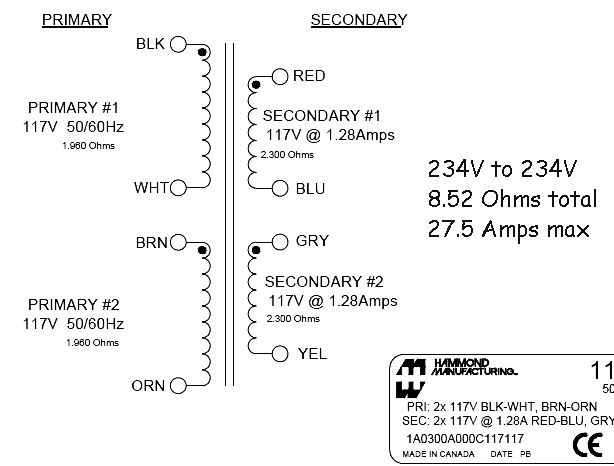

They've changed the style of data sheet, I did find them, squirrelled here in the electrical data panel:
The 300VA 220V 1.36A, 6% regulation: https://www.hammfg.com/files/parts/pdf/1182M110.pdf
Primaries both are 1.960 ohm ±20% each
Secondaries both are 2.160 ohm ±20% each
I've fed those into the LT Spice model. It shows 300W and just under 1.11A ac but low secondary voltage at full load on the secondary with a +20dB transient. So I'll revisit the inrush calculations tomorrow as it's late. In short with the bridge capacitive load I'm expecting from the remodelling:
220Vac rms secondary => 1.414*220 = 311Vdc peak
1.36Aac secondary => 0.62*1.36 = 840mAdc
I've seen the current calculations being more drastic - ie 4x required, so my concern is that this may still not be enough current.

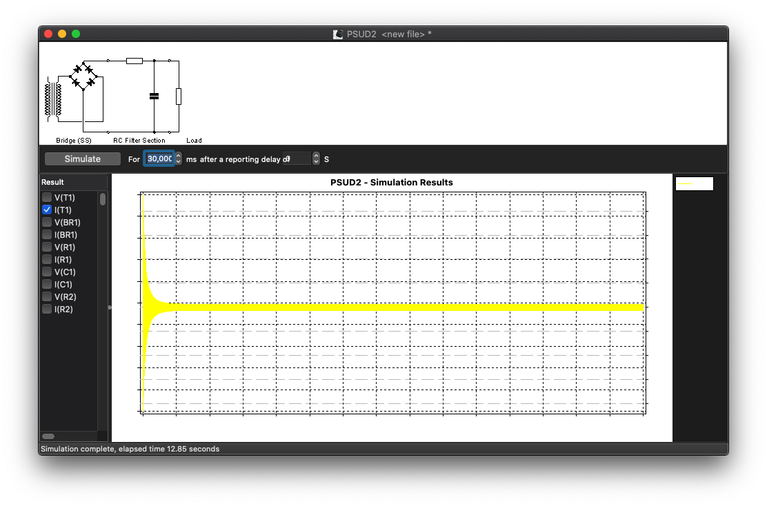

I’ll get it setup on PSUD2 but I’ll need to run it under Wine tomorrow.
They've changed the style of data sheet, I did find them, ....The 300VA 220V 1.36A, 6% regulation....

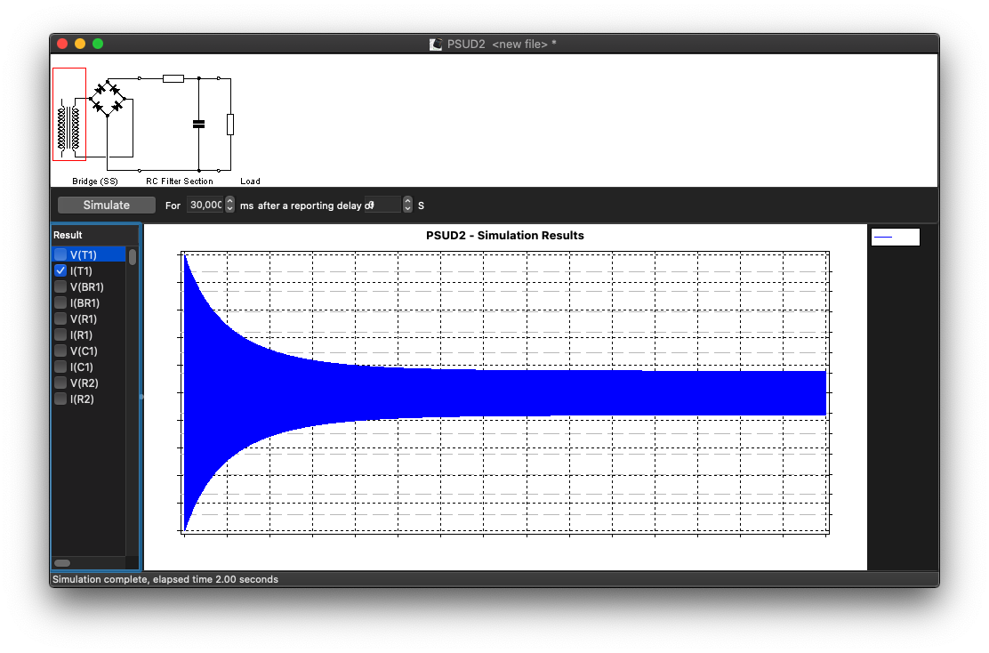

If you have that data you do not need anyting else to put a reasonable upper limit on current.
If 1.36A makes 6% or 0.06 sag, then 100% sag is 1.36A/0.06 or 22.7A. RMS; peak will be higher.
I agree about PSUD being a great tool but last night I was getting 57A peaks with an absurd-HUGE capacitor. When you get to absurd values it spins a wheel. (Change file extension back.)
Ok I see you have a OSX version After a few checks I've installed it - let's see what comes up

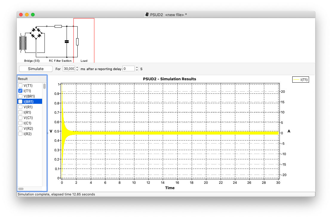

With 220ohm:
Only issue on the OSX version is there's no values marked (I suspect that it's because I'm running dark mode).
However this aligns with what I've seen with inrush management on LTSpice, this also matches given a 5ohm gives this:
It also throws it's toys out the pram indicating 6+Amps current draw on the primary - which is precisely the inrush issue!

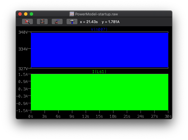

This is a high accuracy LTspice sim (ie alternate solver etc), first 30seconds are not recorded but then showing the next 30 seconds of stable run. This is running the full amp with left channel input 3.16V at 10Khz and the right channel with a 3.16V 30Hz. This takes a while (several hours) and about 100GB of diskspace:
This is showing that the B+ match and the secondary current is a little higher. (using the 1.5mF res cap and 300uF caps to replace the 200uF in the design reducing the hum to -90dB in the output).
Switched the desktop to auto colouring, gives me the values:
