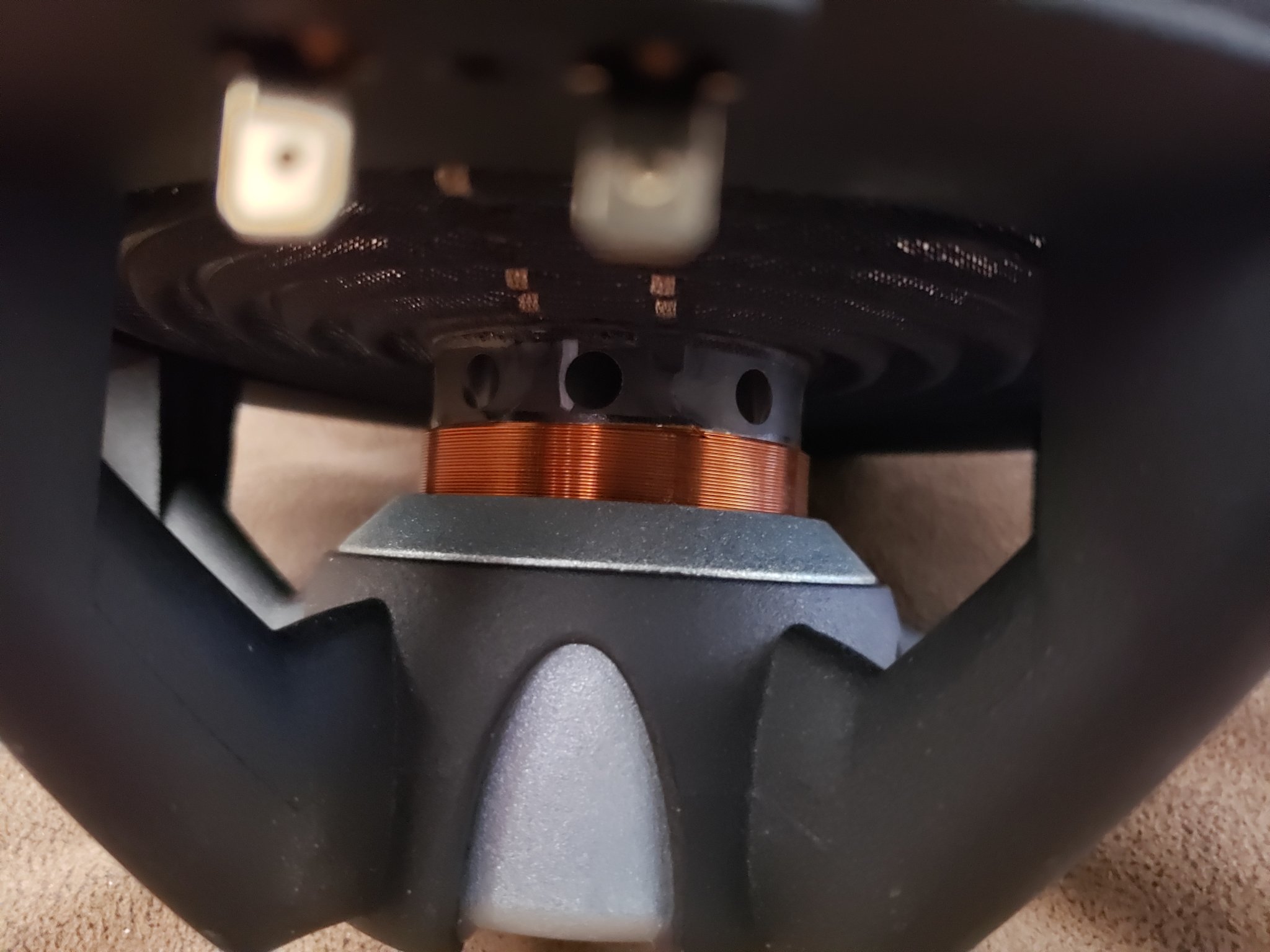

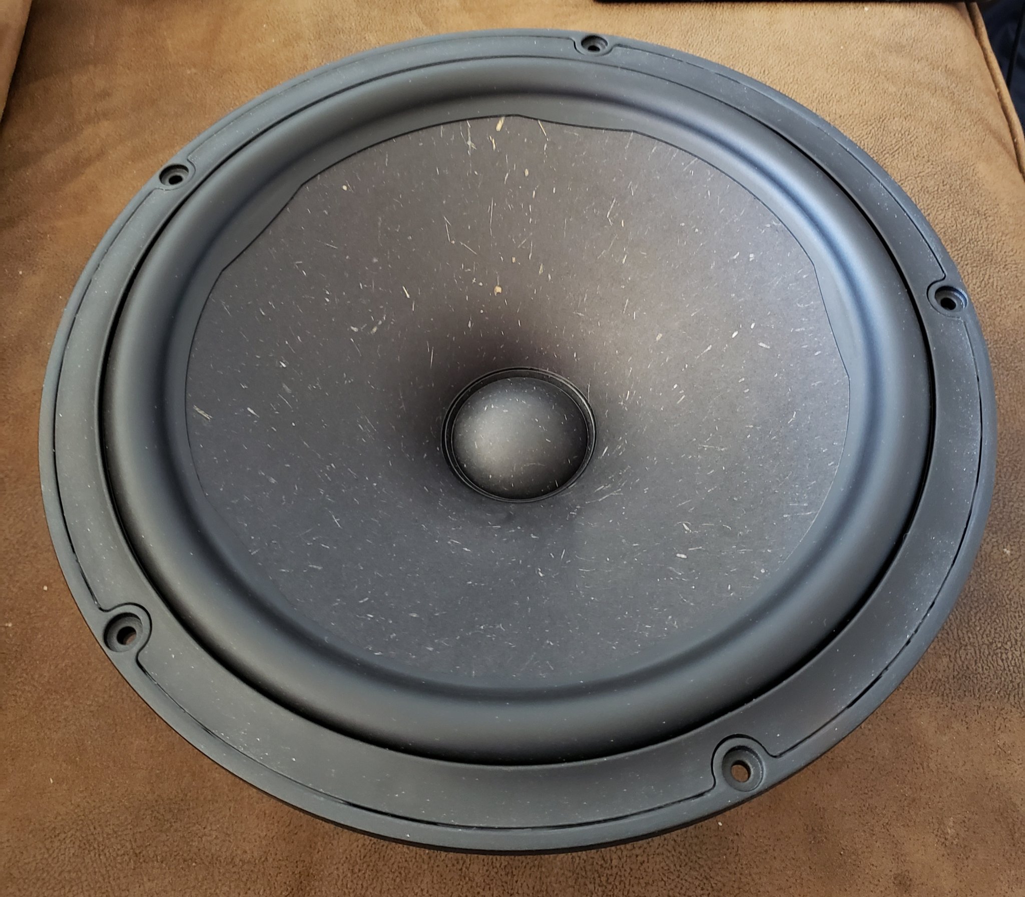

I may have an alternative if none of the above mentioned drivers work out. They call these the Revalator's cheap brother. I have 4 of these Peerless NE315W-08 woofers. TSP - Fs= 21 hz , Qts= 0.39 , Vas= 185 ltrs , xmax= 12 mm. They're not the most sensitive driver, but they'll go LOW and are a viable candidate for a QB3 alignment. They won't go that loud and in no way suitable for any pro use, but they're accurate. At least its a backup plan.

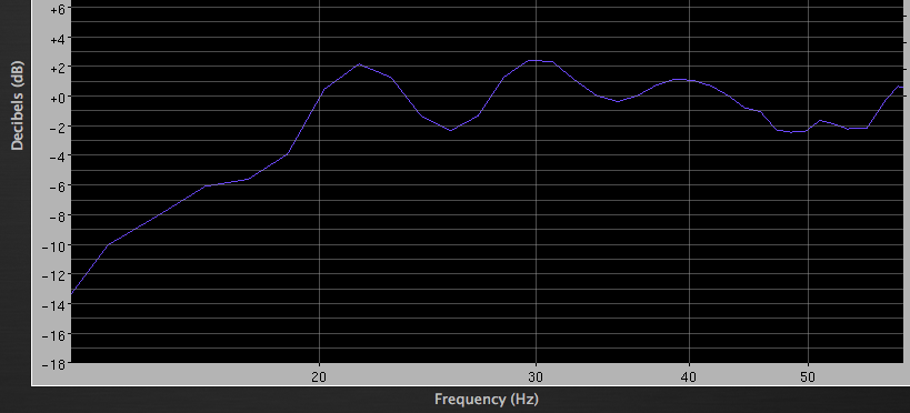

I'm presently using two cabinets with 8" B&C 8NDL64-8 (Fs 80Hz,Xvar 5.5mm, BL 17.5 Txm) as subs, their Fb ~25Hz, equalized to +/-3dB in room response from 19-60Hz.
Can definitely hear when there is something going on in the music down low!

The Peerless woofers are unique. They don't have a huge motor and I don't trust their power ratings, being they have titanium formers with little heat conductance. They get pretty hot when pushing them with just 75 watts sine at minimum impedance. They do however have low THD across the board.

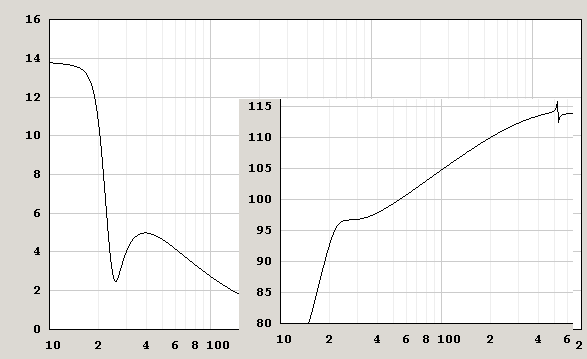

B&C 8NDL64-8 has less Xmax/Xvar than the 8NDL51, I'd think the 8NDL51 would have a bit more output above Fb, but less around Fb, due to the 8NDL64 having more power handling and higher Bl.
The 8NDL64 are in around 17L net, the exterior (undersized) ports using a variety of PVC plumbing.
https://www.diyaudio.com/community/threads/hot-rod-8-2-way-pa-studio-monitor.343215/
Adding 180 degree “U” (2x90degree) fittings to the 35 Hz tuning lower it to 28Hz, adding 5” pipe and 1.5 to 2” adapter dropped it to ~25Hz.
The Hornresp sim says 1/2 space response at 22volts (Xmax ~40Hz) for one cabinet would be 94dB at 19Hz, so 100 for two.
One of the subs is in a corner, the other under the Tannoy 6.5PBM tops, I'd estimate with room gain they can hit ~106dB down low using the 90 watt per side Fosi Audio V3 amp. Probably could do 110dB if
The ports chuff a bit when pushed, but the drivers don't seem to complain (much..) even below Fb. The suspension stays quiet up to Xlim (~11mm IIRC). Can't hear that over the baseboard heater rattling noise..
I hardly ever use the system higher than conversational levels, if I wanted to accurately mix I'd be looking for something like the BMS 18n862 or your Peerless NE315W-08, and a decent room to put them in 😉 .
