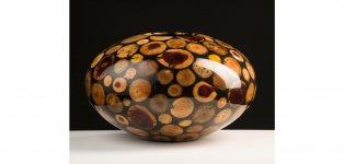

Here is the style I am using for the chassis. I'll make a box 22"L x 6"H x 6"W and line it with duct tape, then fill it with all different types of sticks crosswise, then fill it with black dyed epoxy. When it is fully cured, I take it out and cut 1" slabs off it lengthwise. I'll make the chassis from those slabs.
