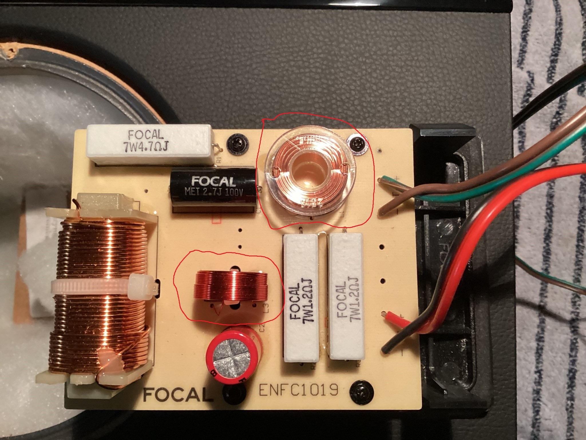

I'm also now preparing to tune the Aria 906.
I would like to know if there is anything to know about the circled part in the picture? Will it reduce performance if I put high quality parts in it?
Does changing the binding post improve the quality of the sound?

I did not touch that air core , only replaced caps and resistors and my brother commented that these sound great now and never sounded better , clear and more dynamic.
If you could use all copper binding posts, or GR research all copper low mass version it will sound clearer in tone and more open a lot depends on rest of your system as HT receiver based system would be overkill for many of these upgrades....

For better quality you really want low tolerance values & inductors that have low DCR, resistors that have low inductance & capacitors with low ESR..
Plenty of MET/poly capacitors even the basic Mundorfs, Jantzen, Clarity cap...then you pay a bit more for the 3% tolerance versions..
Resistors, Mills 1% 12W are very good & small..
Inductors...I would suggest lower DCR & thicker wire....unfortunately its much bigger...but if you look in Jantzens list you can find them in a tight wound format like I did.
Big metal binding posts...remove them as too much extraneous metal in the signal path...
I used MC/Staubli test/measurement 4mm dia. gold plated brass plugs & sockets...

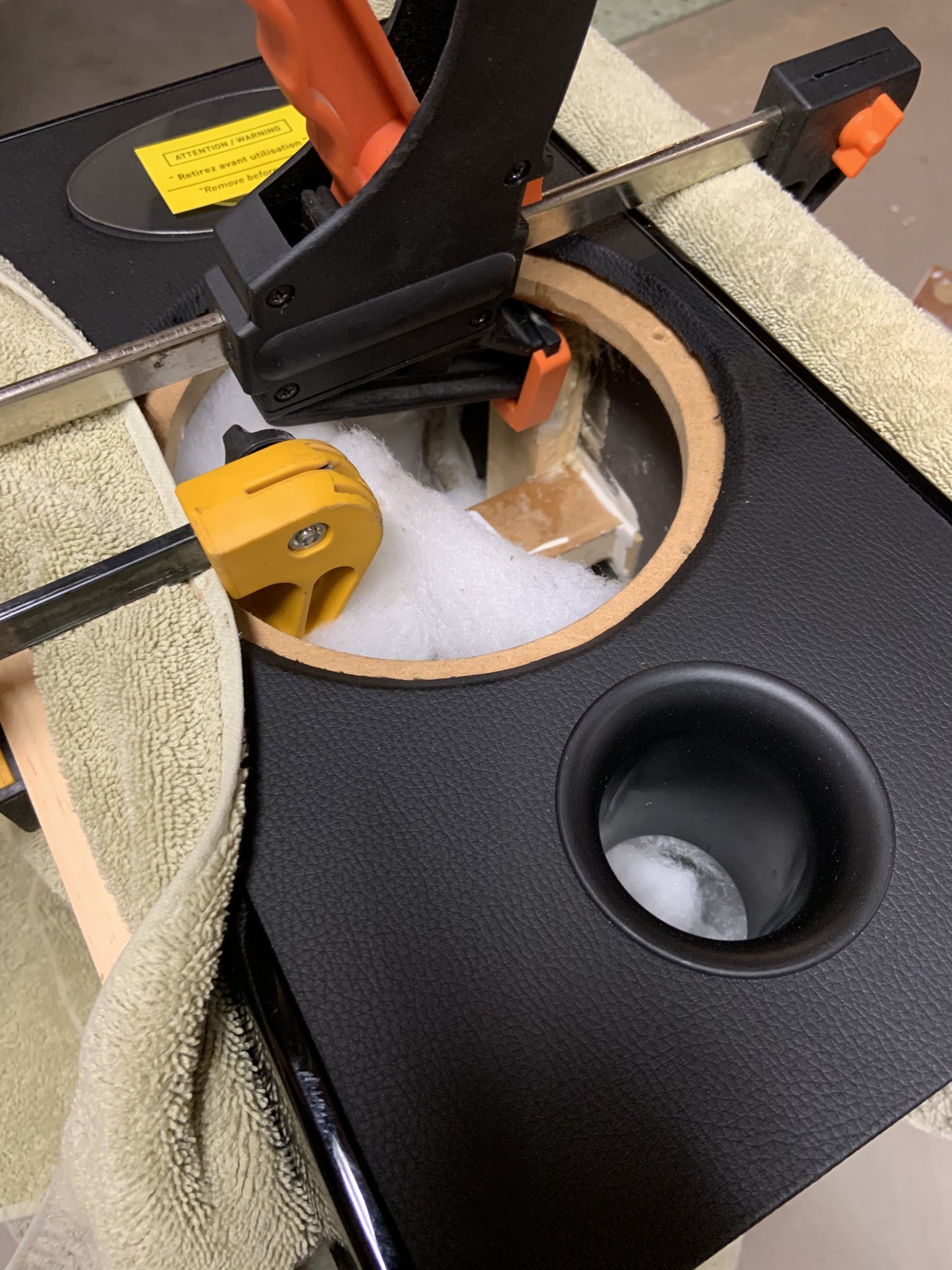

Added cabinet bracing, upgraded internal wiring and all copper binding posts. Wow!

Yes, clarity! One speaker completed. A/B comparison and even my wife commented on the improvement. Internal wiring was upgraded to Kimber 15.5 . Plus side wired directly to the in-series resistor (tweeter) and also the inductor (mid/lows).

Hi, everyone!
By the time I received the reply, the parts were already ordered.
I have ordered these, but they will not arrive until early September.
SUPERIOR Z-CAP 2,70ΜF 800VDC 2%
Jantzen litze wire wax coils 1,2 mh 0,385Ω 1,4mm/awg15
ALUMEN Z-CAP 5,60
JANTZEN SUPERES 10W 4,70Ω
JANTZEN SUPERES 10W 1,20Ω
Same value as before.
Do you think this will be ok?

If the values are correct than it is ok, Jantzen is fine , I would highly recommend adding a bypass or experiment with 0.1uf and 0.01uf like Miflex KCPU .... these may compliment Alumen Z Cap and lift it's performance with better mid and high freq filtration so more air , space cues, harmonics , deeper and wider soundstage, better more defined stereo presence, more precision will show up in the sound.
You can start without it , than after 100hrs add 0.1uf for 100hrs and than if you like the difference add 0.01uf of high quality ...
