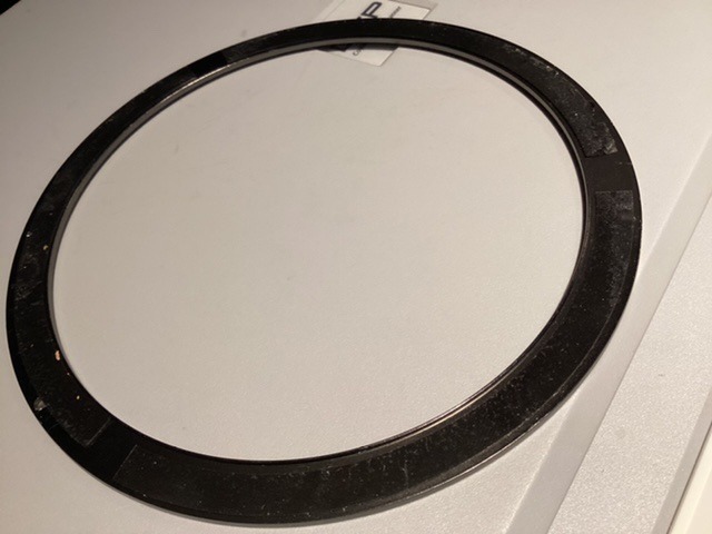

I haven’t reinstalled the metal trim. focal uses thin two sided tape.

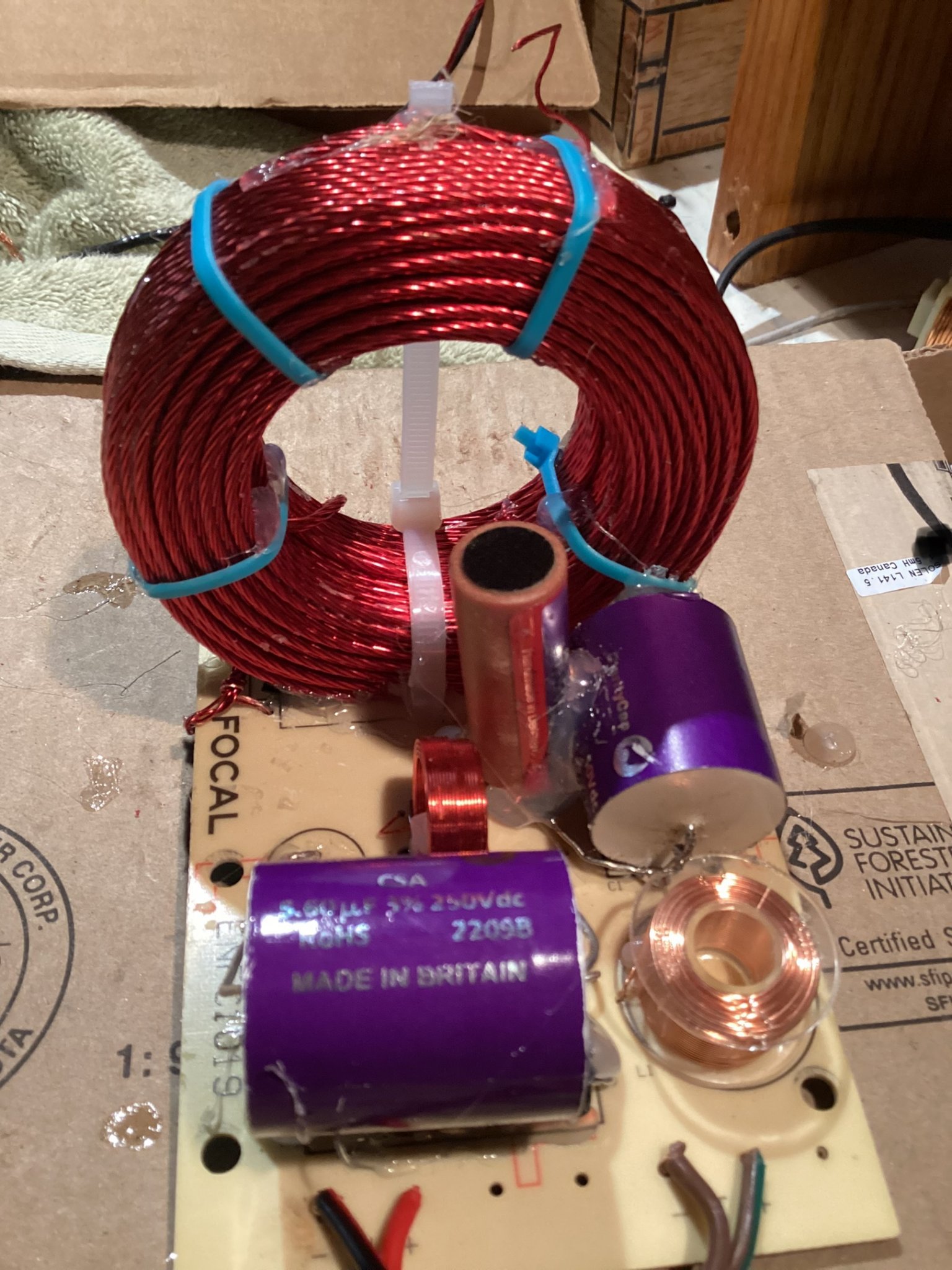

In my upgrade journey I’ve decided not to lower tweeter volume. I just upgraded the large inductor which is in series with the bass/mid driver and now I may raise the tweeter volume.

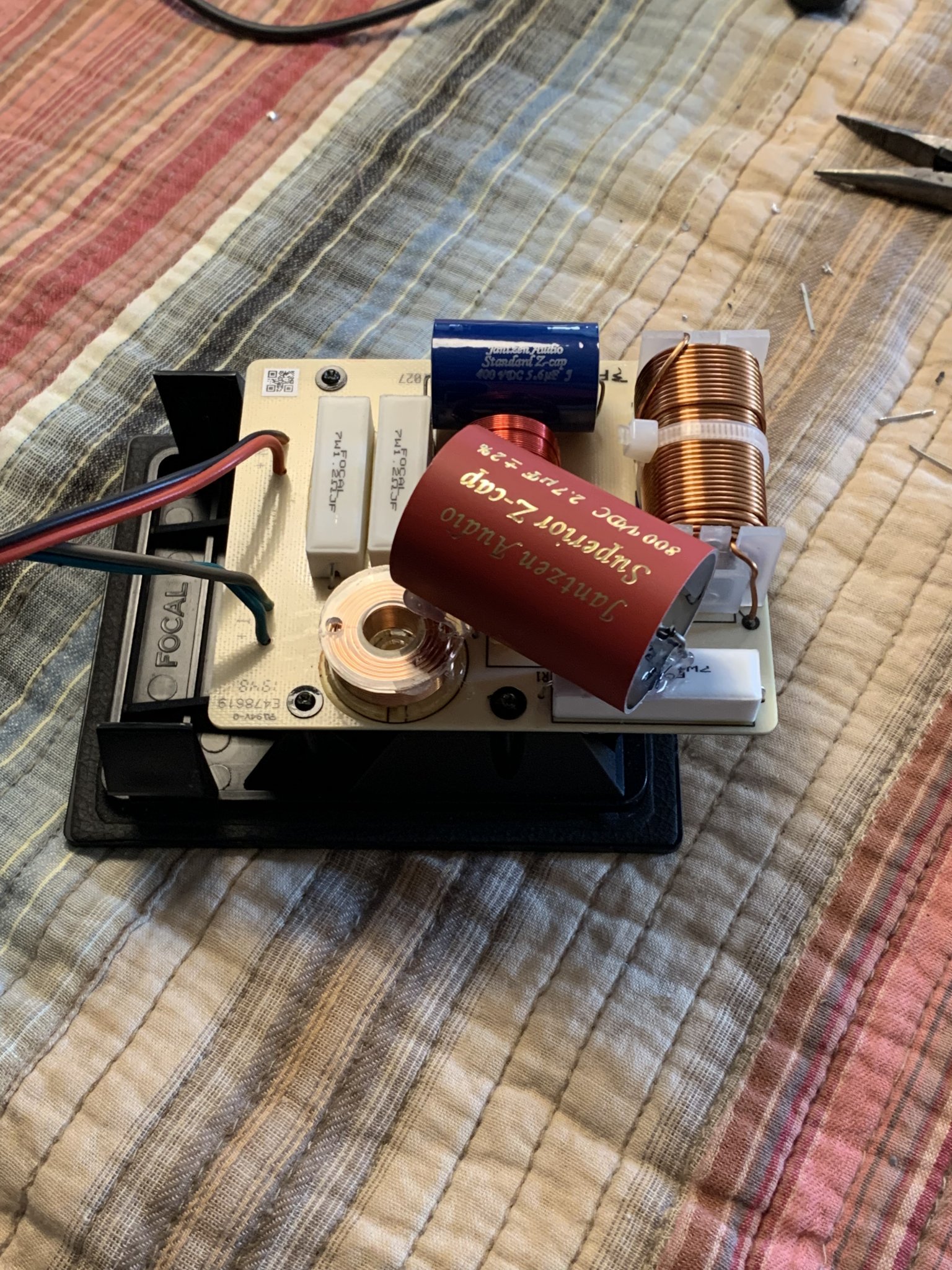

Installed Jantzen superior 2.7uf and Jantzen standard 5.6uf in my 906 crossovers last week. After a little burn in time the sound has improved throughout the frequency range: wider and deeper soundstage better definition and more details in treble. Well worth the investment and effort. Very satisfied.
