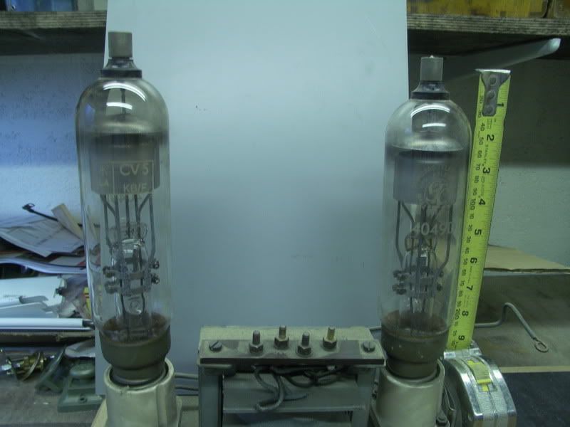

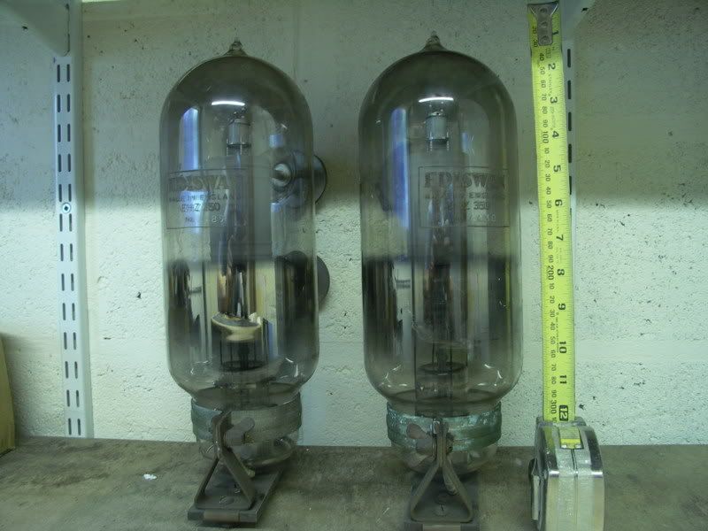

Al, Heretical, I have though about building one. I guess these triode are a tad to big?
DC servo at 5KV could be tricky!
The UV glow from the mercury arc can double as purple power on indicator!
I suppose they could be used as a direct drive ESL amp? Unusual bedside reading lamp perhaps?
