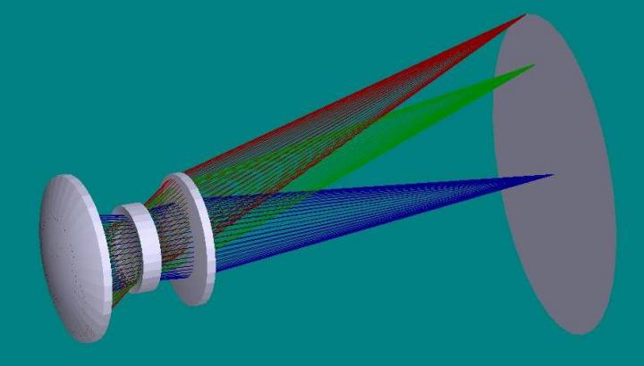

Projectile, I have already designed a higly optimised wide angle cooke triplet and can supply the exact specs for the lens. I may be able to adapt it slightly for reduced manufacturing costs.

Projectile,
Here is an edited version of the word file to make it a little clearer. All three drawings are opened for me but with word if you are scrolling the drawings don't show up. You have to have one whole page showing for graphic to load. All diameters are shown but if you have a hard time reading this I will send PDF file to your e-mail if you e-mail me back. Good luck with this. If it turns out, maybe Alan at DIYprojector or JCB and DIYbuilder group will sale the lens for you in the US.
Some convensions: When reading the lens drawings all lenses are from left moving to the right. So lens one is the most left lens. Two the middle and three the right lens. The right and left surfaces of the lenses also follow this convension which is very important and referenced from the first lens.
The drawings are a little hard to read but all information is there if you look carfully at the whole drawing. Glasses must be exact or exact equivalents for lens to reach good results. Index of refraction and dispersion are given for each glass type. If necessary you can zoom in on the drawing to see it better.
Hezz
Hezz
Here is a picture of the solid model:
The largest diameter lens goes towards the screen. The small end towards the LCD. I calculated that a 17 inch LCD will need about 33 degrees field of view and this lens is corrected for 40 degree field of view so it would probably work with 19 - 20 inch LCD.
