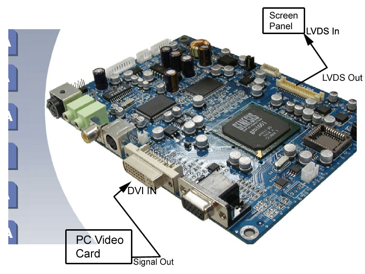

I am confused about how to use this board though.
Do you hook it up to your pc motherboard or what? If so with what interface?
This looks to good to be true! I want in!!! You can use this board with or without a pc. In your reply they state "A KIT" i'm assuming this is the required LVDS cable and menu interface buttons??

Dracul,
This controller can be used with or without a computer as it is intended to be a universal solution. You can drive it with DVI or VGA or composite or s-video.
One of the connectors on the controller board should be an interface for an invertor to run the backlight but this will not be needed for DIY projector applications. Some of the better wall wart power supplies may be good enough for the power supply as long as it has sufficient regulation.
One thing about this A/D board that is not explained fully is how the OS is implimented. Can it be run though software on the computer or does it have it's own hard wired interface. Or are either of these things an option.
If a large enough group buy was orgainized we could have them set up the bios to work with as many wide screen panels as can possibly be run with this controller. This gives more options for finding a LCD panel deal.
I Also sent an e-mail to them and got back a very promt reply from Ken. He also said the single sample price is 300 USD but this does not include the bios tune.
