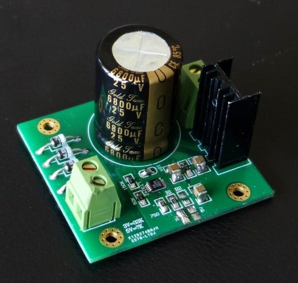

Hi Guys I received the Aliexpress built up unit - CRAP. Plugged in & did not work. crappy 12 volt transformer. Reported fault to Aliexpress with photo's they rejected claim as I should have supplied video (don't own, and don't want to own smart phone, so no can do)
The board works though when I connect up a 12 VDC wall wart but have not tried with my phono amp.

The transformer is the weakest point just as I assumed. Normally it is the most expensive part in a PSU so that is where money can be lost. Or gained... It is not the fault of Aliexpress but it is the seller at fault. A careful examination of the pictures made me conclude the findings I stated earlier. The board itself is fine. Not everyone in the world can build safe and well built stuff. It is better to be a critical customer and not let a low price fool you.

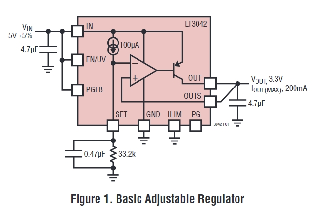

Hi I have connected Vin Vout and GNDOK, I have tried to guess what the eBay LT3042 supply is using as passive parts.
The main parts I think should be right, but there some others I can guess only. Like the resistor + LED at the output, or the current limiting resistor for 200mA max on ILIM pin.
There are two resistors that seem to be connected to PGFB pin that I can't guess what values they might be, or what they do.
By joining the VIN and PGFB pins and adding an external transistor, you can increase the regulator current and have the heat dissipate on the transistor. It's shown on the datasheet.
Please check and correct what I may have missed.
All the components seem to be on the board, but it is not working
should i connect any additional pins?
Hi, regarding the cheap Chinese LT3042 board in this thread. I used to use the same LT regulator boards but ran into some issues with a few of them recently. Apparently fast start up resistors are omitted resulting in a very slow ramp up time of many seconds (depends on value of Cset). This caused trouble in a DAC with the XO. I also had one where one of the diodes became a short. A few 11DQ10 and a new filter cap are a minimum when the slow ramp up time can be tolerated. The connectors are ferro material. I ended up removing the LT3042 and reused them on new boards.
I lifted the fast start pin on one of those. Wired it up for fast start as shown in the datasheet. Worked okay.

Can you show on the datasheet circuit which pin you lifted?
Hi I thought about solving the tip I gave with the same solution as you propose but I assumed performance would go down with through hole parts and saw no way to do it SMD.
Why oh why did the guys who designed this skimp on 2 lousy resistors?

Datasheet…. “Fast start up” is not a mod but a necessary feature when using larger values for Cset. The Chinese board uses a large value cap for Cset but they forgot to implement "fast start up".
Unfortunately LT3042 performs best (least noise) with large value like 4.7 uF for Cset. Not all devices have problems with a slow ramp up. Another solution is to replace Cset for a 1 uF type at the expense of somewhat higher noise that will still be below 5 µV. I did the latter on other boards.
