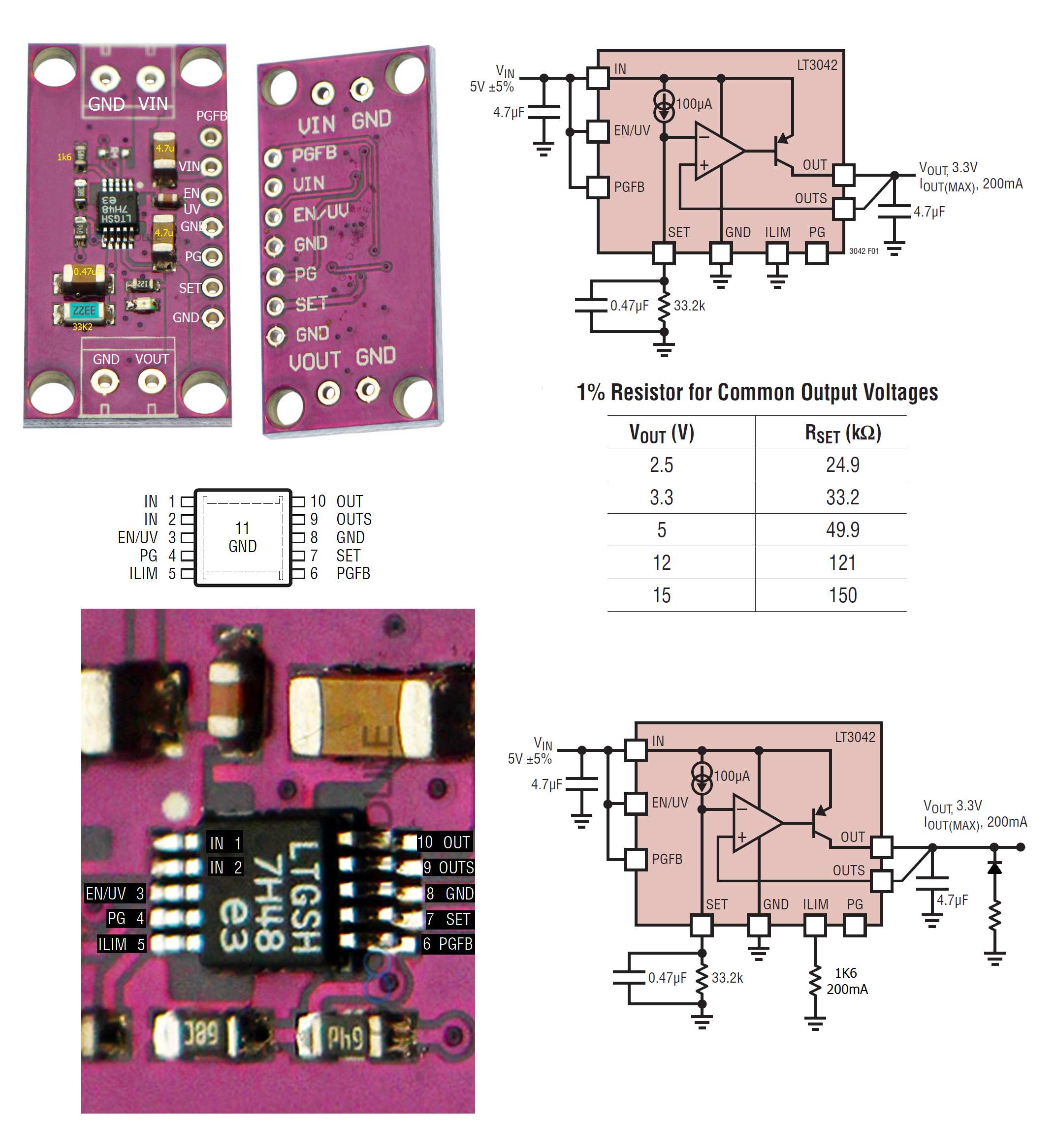

OK, I have tried to guess what the eBay LT3042 supply is using as passive parts.
The main parts I think should be right, but there some others I can guess only. Like the resistor + LED at the output, or the current limiting resistor for 200mA max on ILIM pin.
There are two resistors that seem to be connected to PGFB pin that I can't guess what values they might be, or what they do.
By joining the VIN and PGFB pins and adding an external transistor, you can increase the regulator current and have the heat dissipate on the transistor. It's shown on the datasheet.
Please check and correct what I may have missed.

Looks like the two resistors connected to PGFB initiates the quick start
