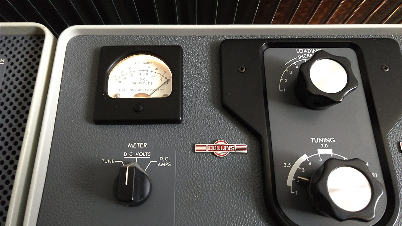

I think they were the de facto HV connector back in the day if the amp and power supply were on separate chassis. Collins used them on the KWS-1, IIRC, and I think everybody else followed.

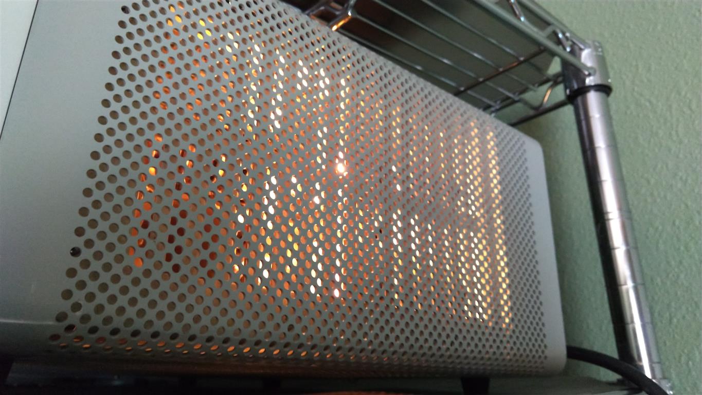

572B's don't run at extreme voltages ( by RF standards ) - only 500 or 600 more than an 811A.
edit: even the little 30L-1 sits at 2 kV unloaded. It's possible I put 572B's in this thing when I rebuilt it, they were cheap back then, don't recall at the moment.
double edit: it's got the same white ceramic base Svetlana ( Ryazan ) 811A that are in my Ameritron; this is the first time it's seen power in at least a decade, and now my entire office is filled with that wonderful hot, dusty, tube smell ...

That is an absolutely beautiful 30L-1. It's hard to beat that old Collins tube gear.
