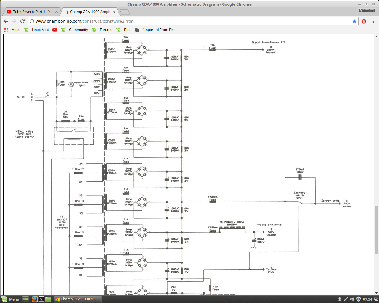

Some random thoughts..... I've had in mind a 813 PP project for a few years, & have been collecting the parts for it now and again. I have several good 813's and recently bought two big 500VA 240v/12v - big ampage (can't remember exact figure) tfmrs to rewind into OPT's. The idea behind this amp build is to build it for fun and as a design challenge, not because I need 500w.
Here's a few thoughts I've had on building big valve amps... first off it would be easier to build such an amp if we limit it's frequency range to drive the low end of things, so I'm thinking bi or tri amping, makes winding an OPT easier if we don't have to worry about HF. Having two OPT's one for the lows, one for the high's makes winding less problematic.
Regarding the power supply I have a big 1000VA toroid, so winding by hand is possible. Rather than wind one EHT winding I'd wind several lower voltage windings stacked on top of another, each properly insulated from it's neighbor of coarse, see attached. This makes finding caps easier too. Double insulated wire is easily available.
For the OP stage heaters I'd like to experiment with SMPSU's to keep weight down, but harmonics may make this untenable. Re weight, we'd have to build a separate PSU. I built a stereo 120w amp and struggled to lift it, so the PSU has to be separate. As EHT rated interconnects are rare and very expensive it makes sense to house amps and PSU's in a 19" rack on wheels, PSU hard wired to the amps.
The PSU and amps will have to have several protection circuits built in and insulation considerations have to be in the forefront of our heads, EHT PSU housing has to be double insulated and sealed, no open type construction as is usual.
Having waffled on about EHT PSU's it actually makes sense and it's cheaper in some respects to parallel multiple valves, than use two or more big valves. No EHT needed, less turns on the OPT. Every stage added brings down Z pri so we can wind with thicker gauge wire too.
The whole thing will need cooling too, but ultra quiet PC fans are readily available. Lastly to drive the OP stage either anode choke loads or some sand is going to be needed, but haven't got that far in thinking just yet.

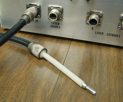

There is a good way to do HV interconnects. Take a look at how Glassman high voltage power supplies do it. It uses a UHF connector modified so that the center conductor makes contact about 3-10" inside the chassis. You then use a piece of RG-213 cable. Make sure you get the stuff with a solid polyethylene dielectric (rather than foam). This is about the only way to do HV connections that isn't ridiculously dangerous.
I should note that this is not an idiot-proof connector, since someone could hypothetically power up the power supply and touch the center conductor when the cable is disconnected, but when in use it is solid and will not arc. This is the only sensible HV connector I have seen so far.

Eh... I've seen them arc. Not saying it can't work, but I'm not as comfortable with it. Maybe at 1200 V it would be okay, but much over that and I wouldn't trust it. Those modified connectors (not sure what they get called- I always referred to them as a "deepwell" HV connector) are easy enough to make and seem to be as safe as an HV connector can be realistically made. No matter what it won't be idiot proof. There is no such thing as an idiot-proof 2 kV 1A power supply, but it's important to do what is possible to minimize the danger.
I should note that RG-213 with a solid PE dielectric will usually hold off well in excess of its rating. I've seen it used at 60 kV before without issue. That said, I don't recommend using it that high. As a side note, the stuff with the foam dielectric does not hold of anywhere close to that kind of voltage.
