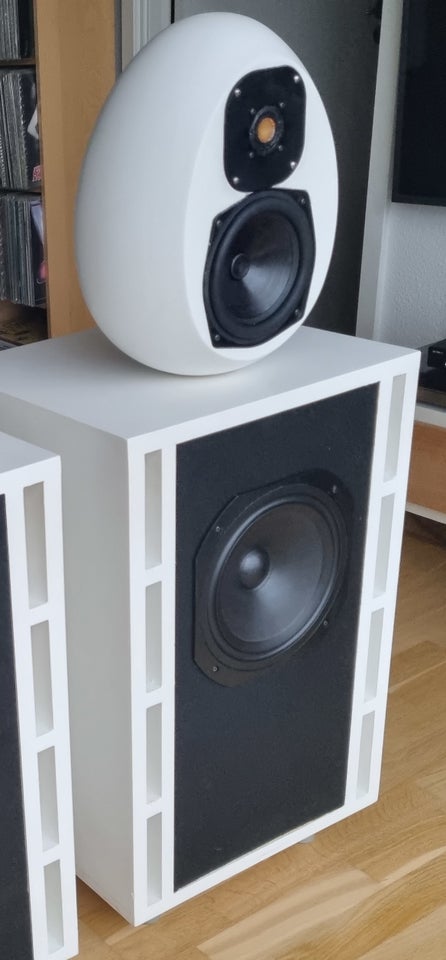

That’s correct. They were made from concrete, with no reinforcements like steel or glass fibre.There was a company from Scandinavia called something like Rauna that used concrete cabinets.
And I remember the Onkel Focal, where the “egg” was indeed GFRC.
- Anyone toyed with the idea of GFRC glass-fiber-reinforced-concrete for baffles?
