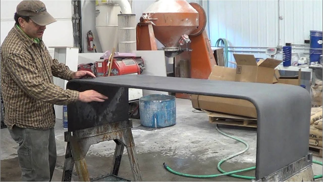

Anyone toyed with the idea of GFRC glass-fiber-reinforced-concrete for baffles?

It would look cool! Also I could imagine an economic benefit to a small-volume manufacturer when the cabinet could be poured in one piece and little or no finishing required. Compare that to the time it takes to build a cabinet and finish it with wood. I've actually been thinking about trying this lately and see how it compares to the other cabinet materials I've been measuring.
Good point... for DIY one-off, wood-based sheet stock is hard to beat... but for low volume manufacturing, molding/casting starts to make a lot of sense.

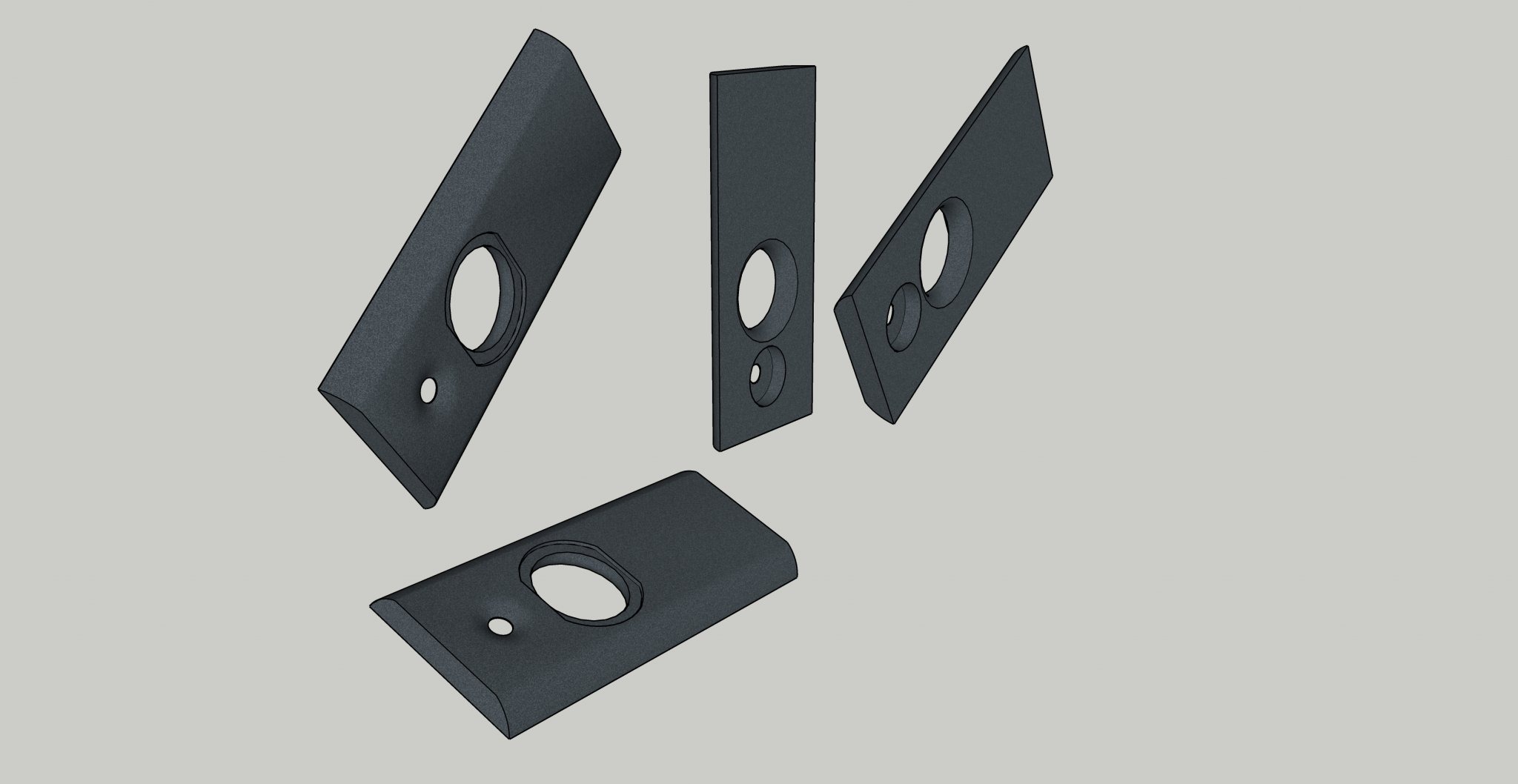

If you zoom in a bit on these imagine replicating this in MDF. The countersink for a truncated frame woofer would be difficult to achieve with a router setup. The sharp recessed edge of the truncated flat where it meets the arc would not be possible since it would be limited to the radius of the router bit . Most truncated frames are meant to be surface mounted, but that is really a compromise for ease of application among a wide range of diy'ers with limited tools. Most, I would think, would prefer to have the woofer as flush and seamless as possible. And the piece (negative) that is inserted into the mold to produce this countersink is very simply cut with a jigsaw. The cutout above is modelled on a Peerless 6.5 in 830874. The large(ish) radius edge roundovers would be another very difficult task for most of us lacking a router bit this size. In the case of a mold you are only limited by the corner molding you can find at your home depot. To be able to integrate a wave guide into your one piece, seamless, baffle simply by inserting a plaster cast negative of any waveguide available to you is just one more aspect I find pretty appealing.

The reason why I dismissed surface reflectivity is because it's not unique to a concrete baffle when compared to any other. These discussions generally tend toward faceting, contours, edge diffrations, counter sinking, etc. Commentary on this, or of such as foam or felt surface treatments on baffles or felt lenses on tweeters or various other mention of surface reflectivity applies equally to concrete as to wood itself or even to the surfaces of commercial waveguides.
