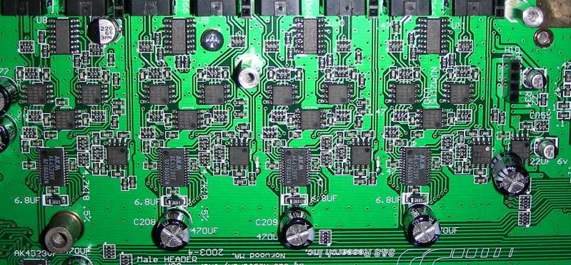

Hey Karl,
thank you again. That's helpful information.
I have not soldered or un-soldered surface mount components before. My understanding is that i need to be sure that: 1) I do not use too much heat (which will fry the op amps), 2) the old solder is well removed (perhaps with solder vacuum, perhaps braid), 3) to use only high quality silver solder and 4) to 'tin' the contacts on both sides before joining them. Anything else?
The unit is not battery powered - it runs on AC (switchable from 100-240v) with its own transformers (one for the circuit board and one for the phantom power for the microphones).
So my questions then are:
1) Is there harm in trying (ie soldering in and running some tests) the THS4032 to see if it will work by trial and error?
2) Any other good OP AMP recommendations?
3) Any other suggestions or tips regarding unsoldering and soldering surface mount components?

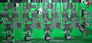

I'll send along a jpg of the section of the board that i'm looking at.
here's a jpg of the analog input section.
adam
Hi, Would suggest you get hold of any old (scrap) pcb with surface mount components to practice on. The following works well and in the days before hi-tech desoldering stations, I used this technique all the time. I even bet an equipment sales rep I could unsolder a large surface mount I/C quicker than he could on his desoldering station. Now this takes practice, and you need a good iron, temperature controlled if possible, set to around 350 degrees C. Fit a medium sized bit, load the bit with solder and apply to new clean braid laid across the I/C pins. The "wicking action" will remove most of the solder but not all. Next using a jewellers screwdriver (you will have to experiment to find the right size) apply between each leg of the I/C and quickly apply clean soldering iron bit, not to the pin you are levering on but the PCB print just in front of it. The pin should lift free, and if your careful and just break the bond without damaging the pin or the print, the I/C should come cleanly off. I say cleanly, in fact most I/C,s are glued as well, so be sure that each pin is free and VERY gently prise off PCB. With the I/C off, again use braid to clean the print. Be careful, those fine tracks can easily be damaged or lift. Clean the board with a cotton bud and iso. It should look like new PCB. With practice you should be able to remove I/C so cleanly it is reusable with no physical damage to the pins. Sorry if that make anyone cringe but it can be got down to a fine art. Oh and I won the bet 😀
Any other good Op-Amp, well the OPA2604 does it for me, I think available in surface mount package.
Regards Karl

hey there,
Karl, i don't know if you'll look again at this thread or not. But if you do or if someone else has some input, here goes.
the opa2604 is available as soic-8 which is not technically the same as the format for the NJM2115 (in this situation) which is a proprietary shape used only by that manufacturer (for the most part), or at least that's what i've gathered so far.
however, SOIC-8 has the same footprint as far as connections go. So they are usually interchangeable. so that's that.
i also had a thought - the application of the njm2115 is input, before the ADC - not output. the input dba level is always set at either +4db (with a 4db pad) or -10db (with a 10db boost). so, the unit would never be at unity gain - or always, depending on how it's routed i guess.
the voltages didn't change at all when i changed the setting from +4db to -10db and i don't know if they should have or not.
so two questions are:
1) is it risky to the ADC converters to try a different op amp that may not be suitable (namely the THS4032)?
2) would the above info (about input level) make stability at unity gain a non-factor?
I've ordered a couple of different samples to try - the opa2227 and the ths4032.
oh yeah, also - in reading some more, it looks like (if you look at the picture above) the 3rd njm2115 is likely for the ground and then isn't as important to change as the other two. thoughts?
cheers,
adam
Hi, No risk at all to convertors and if not used at unity gain probably will be O.K. but as ALWAYS, can't say for sure without seeing circuit diagram. Even the PCB layout can cause stability problems (unlikely but it can happen), if you are using an unsuitable device.
Regards Karl
