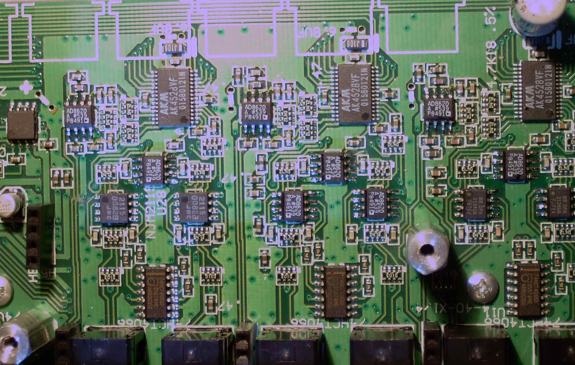

here i'm with my finished Motu 2408mk3's:
one unit has new BB opa2134UA on on all ins and outs, (differential amp and DAC Buffers) and sounds much better now, i would say it is a new interface now, easy to hear that it's a lot less grainy and more precise now, i like it now!
second unit is more experimental: DAC and ADC buffers are all AD8620, and outs are also BB OPA2134. Inputs are 1-4 OPA2134,5-6 are AD8620, 7-8 the original NJM2115. the AD's as Buffer is a good step forward, now, even the input with the cheap NJM ops sounds better now, more drive and punch then before, and the 5-6 ins are precise and open sounding.
the whole mod's price is some hours sodering and 90$ for the op-amps...but now i have usable, musical units, not anymore things that smell like semipro...

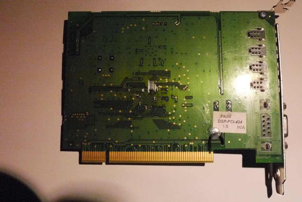

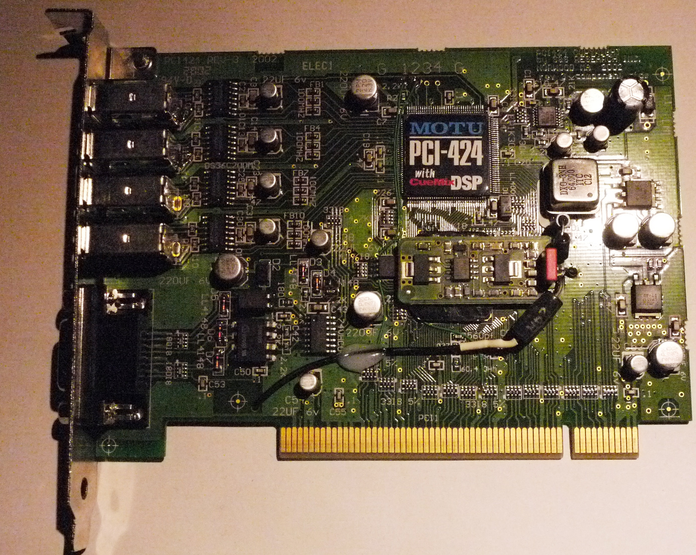

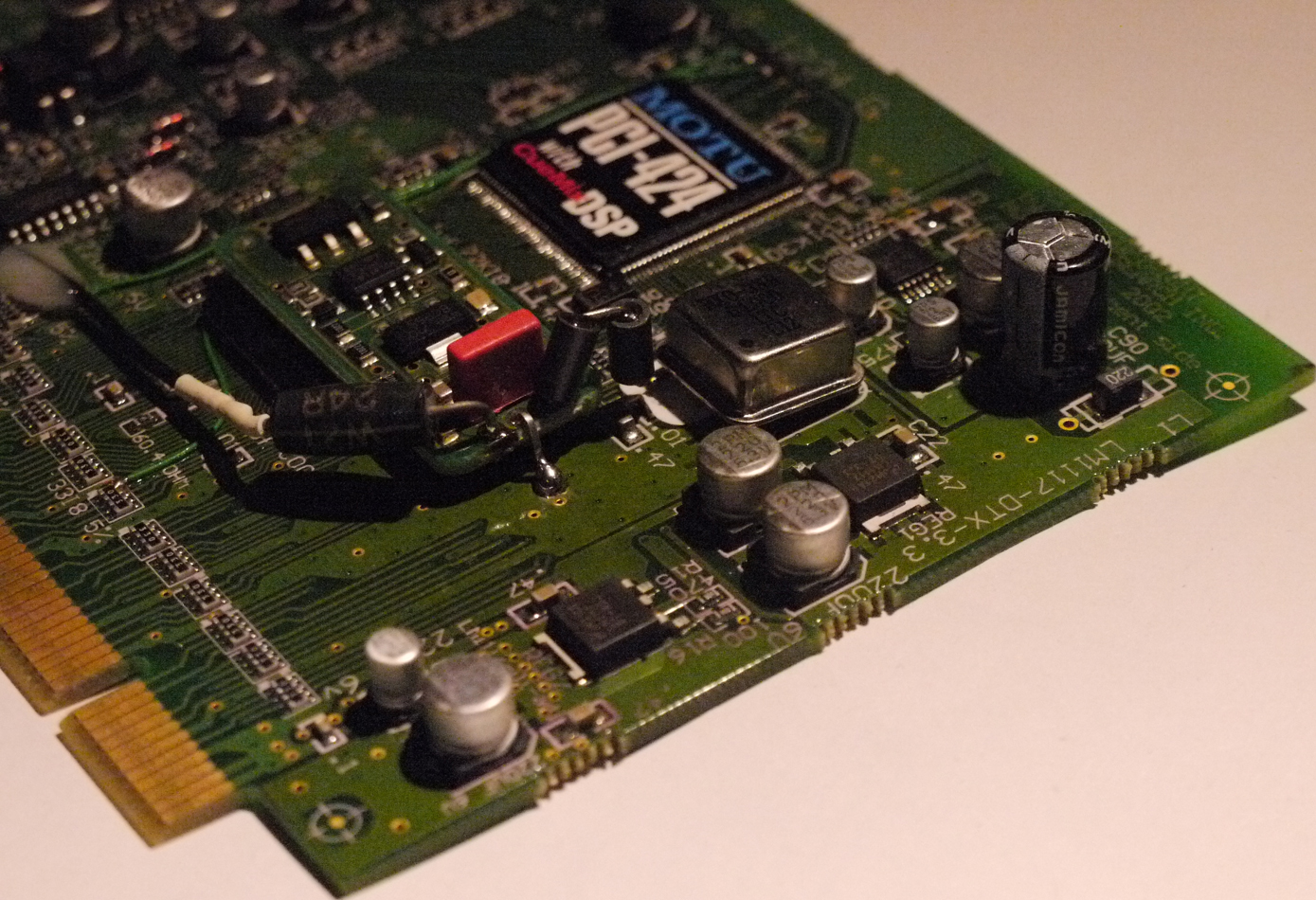

Long time not heard about some Motu Mods?
I have a new one - IF (....) you beleave in Jitter:
There is the PCI/ PCIe 424 (X) Card, and all Versions produce the internal clock signals/ samplingrate (for the Interfaces), with the 64Mhz Crystal oscillator - A Friend sugessted me to power this with an external, Ultra low noise "shunt voltage Regulator" - Tent labs and others offer them. So, my pci Card für the Motu (2408 MK3 and others) got it's Crystal removed, just to install the new "ULN" voltage Regulator (3.3V) to it, and put it back - one Pin isolated on the PCB - the soucre is now the +12V Pin on the PCI socket, and the tentlab 3.3V shunt feeds the Oscillator - this little mod is so good, all motu users should go for it...it's about 80us$, and the most difficult part is to remove the crystal ( make a Special 4-Pin tool just for unsoldering, or do it with 2 Irons and 2 Persons) - once installed, there is more Music. Precision, Bass, everything gains, and it's not a tiny step, it's remarkable from Minute one - i'm sure, even if the Interface has ist original cheap opa's.
Now, with modded clock's, Opamps and better caps for the analogue PSU Part, my Motu Setup compares to the big Avid line, RME, Apogee whatever..come in with you SOTA- gear, i'm sure there is little Air on Top. External clocks are still above, sure there is allways something better - but not that much that it rules anylonger in production workflow. And the best of it: you still have the Option to choose the clocksouce you like, and all Software- Options stay the same (like automatical switching samplerates in wavelab......)

smitsch, can you post hi-res pictures of your modded 424?
here they are - the unit is in daily use, everything perfect. What you see is a "tentlabs" 3.3V shunt Regulator, conected to Vcc of the XO, feeded by +12V tag on the PCI-Slot.
BTW: if you want me to make you this Mod on your PCI, PCI-X or PCIe 424Card, there are possibilities.
There is also a moded PCI or PCI-X available for direct Exchange, if someone is interested.
Price: is the 3.3V Tent shunt Regulator & 1 hour of work (70 USD) & shipping - a nobrainer.
