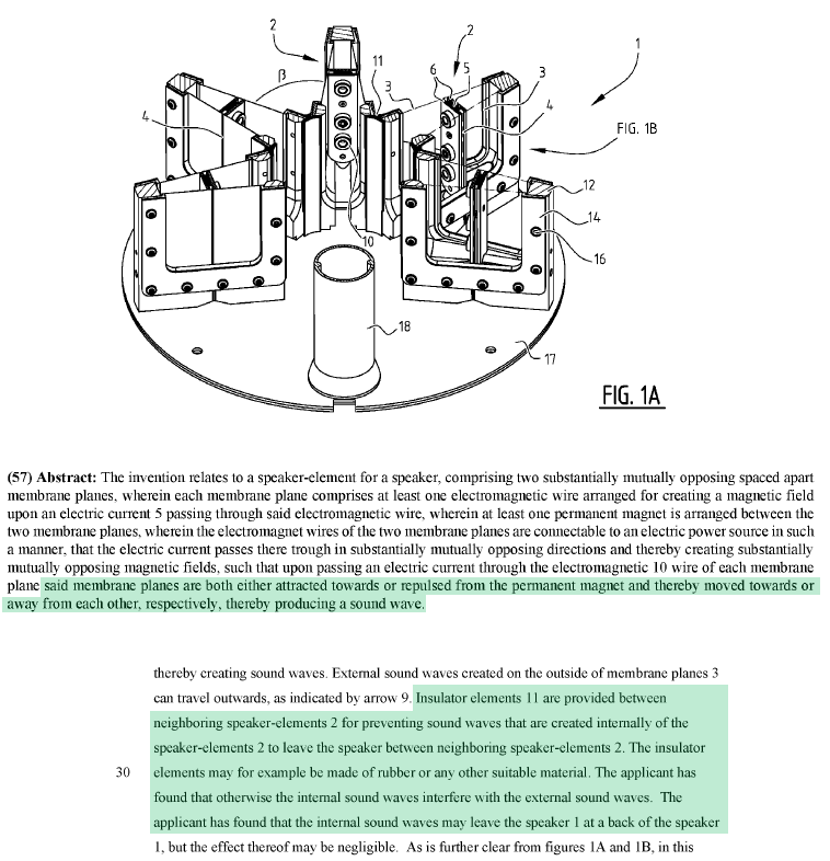

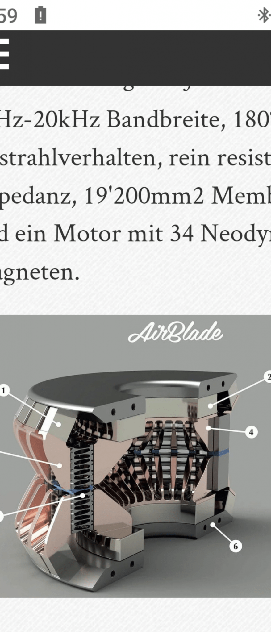

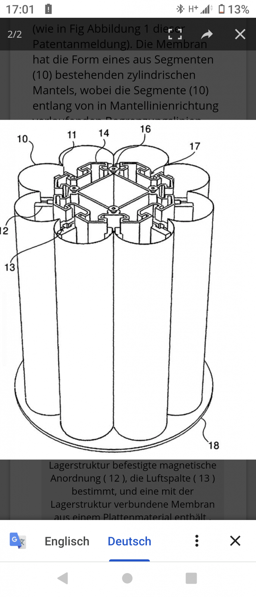

there is since that side is open and all modules have the open side towards the middlethere is no sound in the middle of the modules, so not like amt
I do not understand what you mean? The video explains that the modules do not produce any sound in the middle. the large loudspeaker has many modules, similar to an amt? the smaller speaker has fewer modules. the efficiency of a single module is likely to be low.
Can you point us to the the video explaining there is no sound in the middle?...The video explains that the modules do not produce any sound in the middle...
In video linked below (between 10:00 - 11:00) it is mentioned that there are planes centered between a modules diaphragms or between adjacent modules where there is no sound. That would imply that the diaphragms are moving in tandem producing nulls and alternate phases as you move around the speaker.
https://youtu.be/EomUt0QLQ8g?t=600
Those comments in the video directly contradict the patent verbiage which states that the diaphragms move toward or away from each other(like an AMT) and that there is sound in the middle. Blocking elements are used to keep it from interfering with the forward radiation, and it escapes out the back.
Due to the small dimensions of the interior of the module, only pressure fluctuations can occur without releasing a sound wave. only in the area of the opening of the module would sound waves arise?
