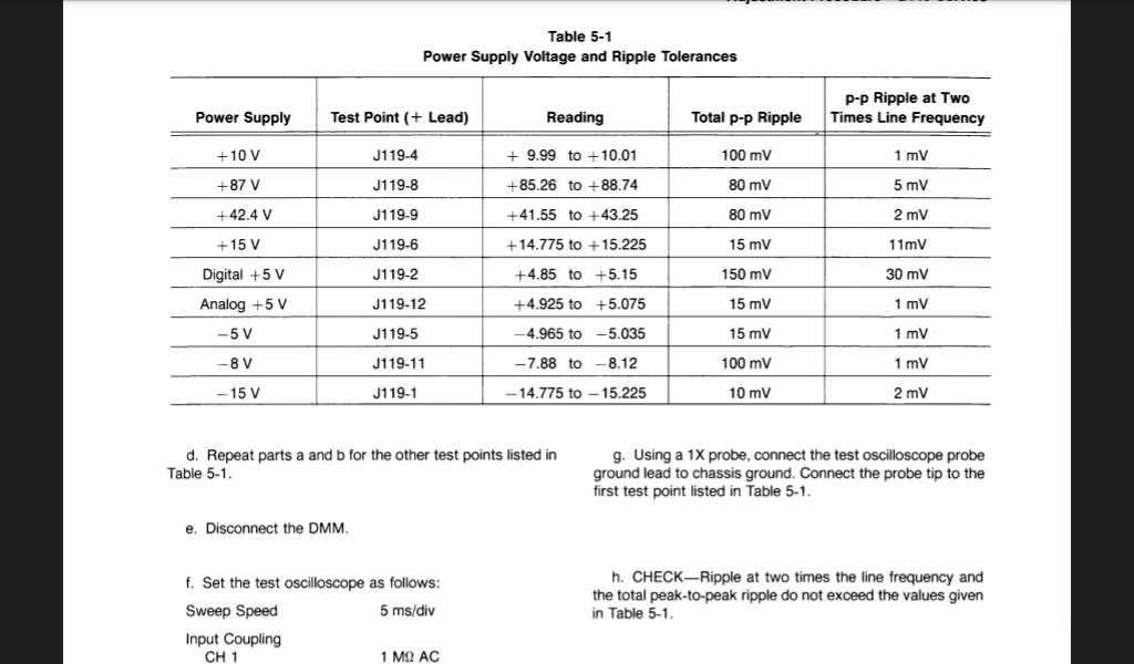

I went through the service manual and set up the test scope to check ripple at the J119 header. As I said before, measuring voltage with the Fluke 87iii shows all within (near center) range. Now I don't have a ton of experience measuring ripple, so I'm not sure what it should look like. Pin 1 5v output shows a mess of spikes on my Tek 210, peak to peak varies from 4-10mv.

You measure DC level with your DVM and see values nicely in spec. The spec table will specify acceptable ripple levels (for most supplies in low mv range) which are best measured with the oscilloscope in AC coupled mode on the lowest range (probably 5 mv/div). If the spec is 5 mv ripple P-P then the ripple line should all comfortably fit within one vertical division on the screen. I am working on a Tek 465 I recently acquired with vertical switching section issues. The scope is 40ish years old and looks not to have been previously touched (all original PS caps) and all of the PS voltages and ripple levels were well within spec.
My second scope is digital, with p-p readout. So it's normal for the ripple to look like static? The spec says within 10mv p-p, which it is. Another pin says 100mv p-p, and I'm only seeing 20mv p-p. I guess I'm having trouble understanding what I'm looking at. Showing my ignorance. I've accomplished a lot without a scope, but as I get deeper into other repairs I'm seeing one as a necessity.
1) for linear supplies look at 120 Hz ripple ( adjust time base and trigger )
2) for switchers (SMPS) look at both line ripple (above) AND 2x switching frequencies. must exclude hash by selecting 20M BW limit and using HF probe jacks ( reduce probe ground loop area) and / or differential measurement. get both ripple measurements on different time base settings. BTW the common mode hash from SMPS spoils many folks ideas of ripple.
3) DUT circuit induced PS ripple may often be present! look for it
digital o-scopes can fool many looking at PS ripple ( because there often is many AC components present) its not simple.

I used #2 based on the service manual at 2mv/div. After researching some more, I understand now that I'm looking at the AC ripple from the DC supply. It looks as should be expected. This evening I'm going to begin working away from the power supply, as everything seems to be within spec now.
