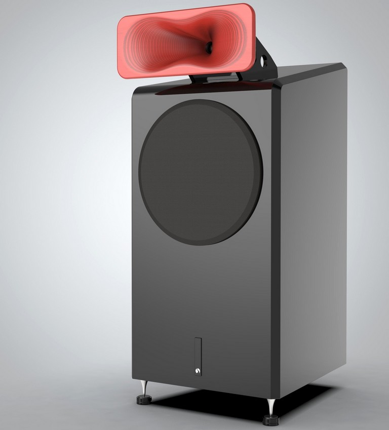

There´s so many red flags raised by that piece of Advertisng that 12" vs 15" woofer diameter wouldn´t be my first concern.
Who cares they are "near" a car body factory which disappeared some 70 or 80 years ago and is wholy unrelated to them?

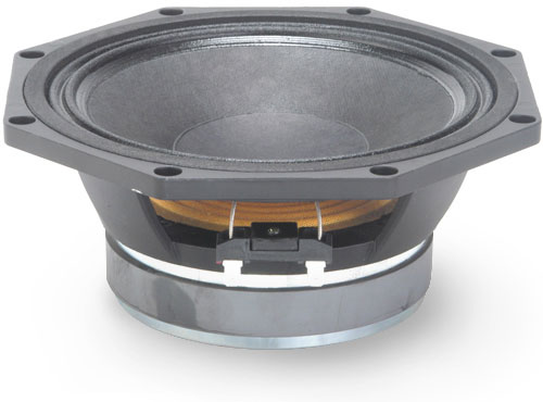

It's a nice combo, just a lil' overpriced
All of B&C 8" woofers use the same cone and surround, if I'm not mistaken. My money is on the 8PS21 because it's the best suited for a two-way, and the efficiency matches.
They have some neo midrange models which are even MORE efficient, but they won't play as low.

For instance, the B&C 8NW51 packs a TON of neodymium into the motor, raising the efficiency by a few dB in the midrange, but at the cost of output at lower frequencies.
Basically as you raise the motor force you get a higher efficiency, because efficiency is determined by motor force and mass. But as the motor force goes up, QTS goes DOWN. The B&C 8PS21 has 5dB more output at 100Hz than the 8NW51, but the 8NW51 has more output in the midrange.

Fleetwood Sound Company DeVille SQ![]()
Fleetwood Sound "Deville" $9600
B&C 8PS21 $110
It is 94dB efficient...
Woofer: B&C 8NDL51
Compression Driver: B&C DE550
