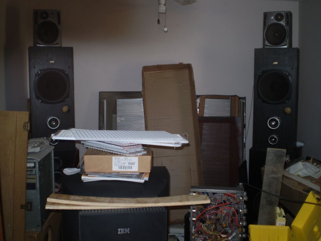

This is a very interesting thread indeed.
My duetta's are in very sad shape as well.
Is there a way to retension the bass panel instead of replacing it as there is nothing actualy wrong with diagphram it self except for a few cracks in foil which can fixed with some conductive silver paint.
I have done this before (10 years ago)when one the loops became open from someone (not me) had abused It by playing some hip hop stuff, in which they weren't designed for in the first place, kids. jer
