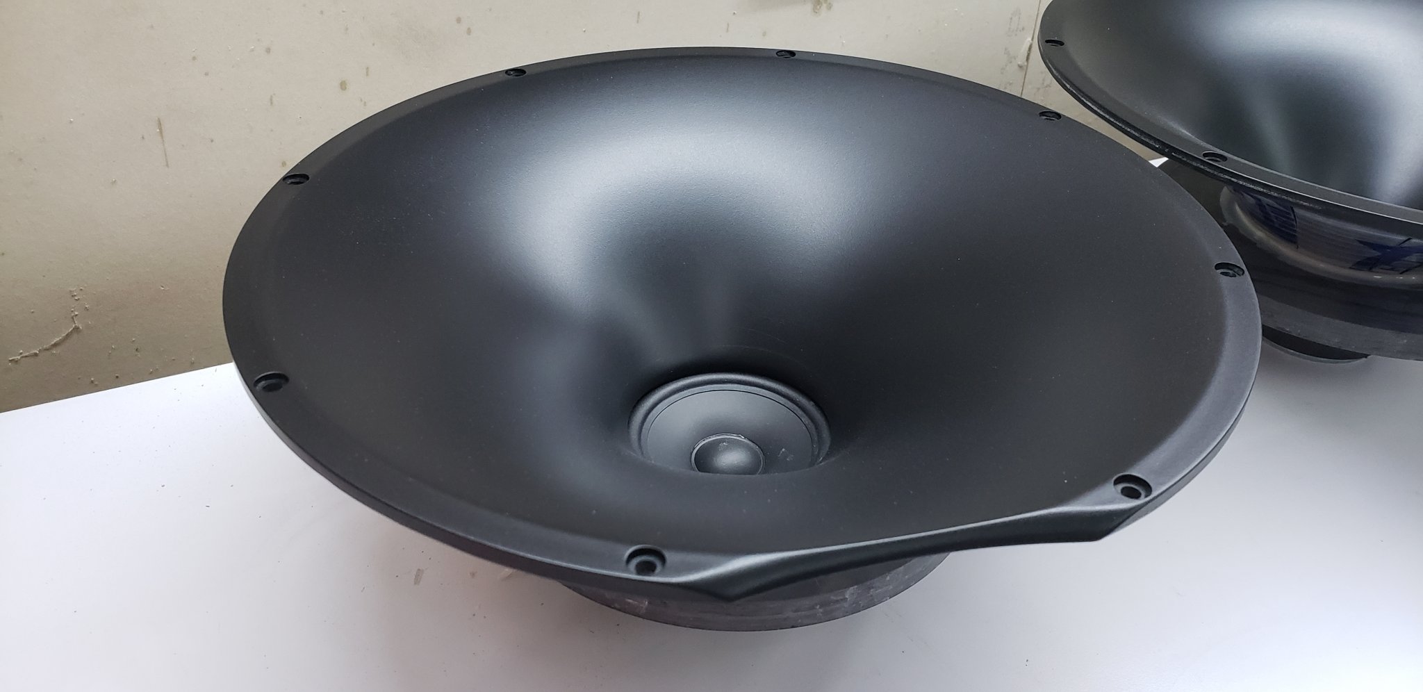

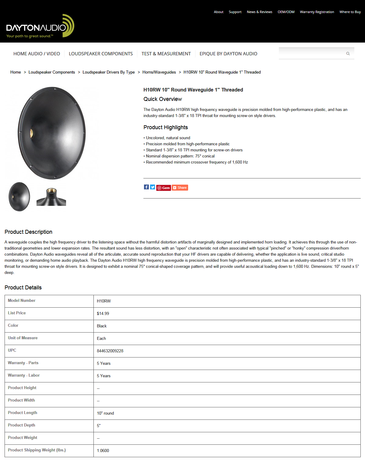

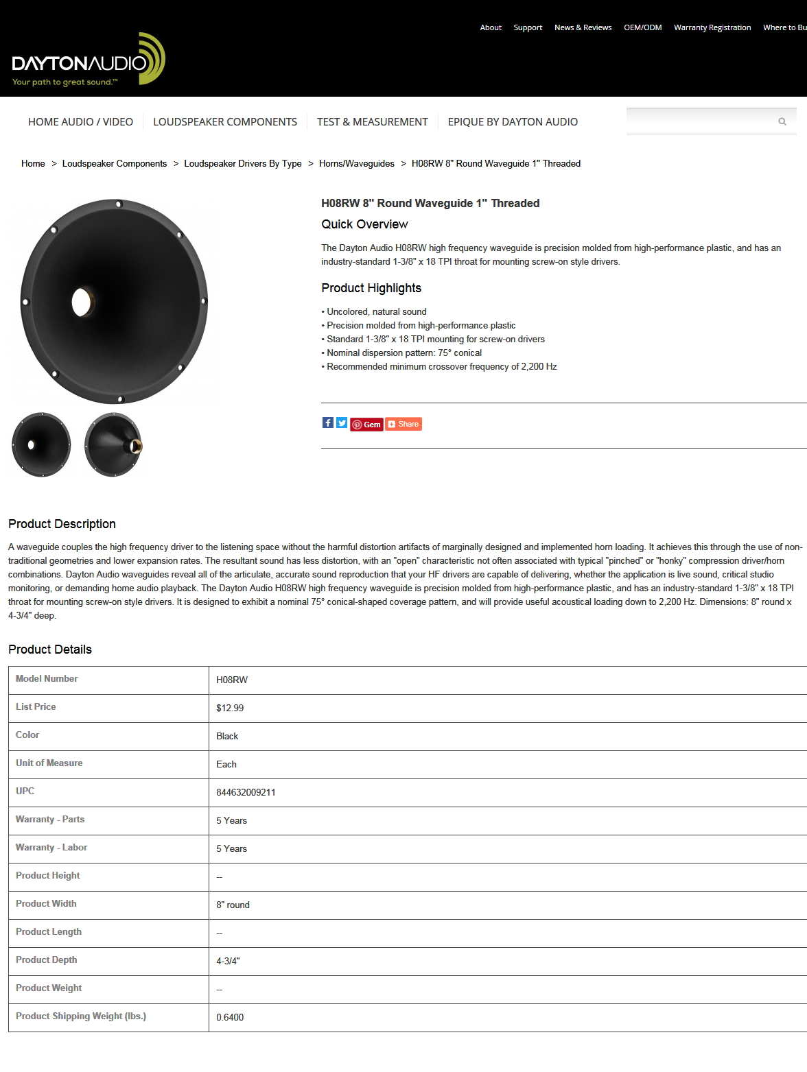

In past have often thought about using one of Daytons cheap 10 or 8 inch waveguide, you know truncate it where diameter suits TC9/10F surround and fabricate a mounting part that is glued to the truncated waveguide. Think their 10 incher looks most smooth as seen below and if it have any interest i would gladly sponsor a 8 and 10 incher shipped to your private address for trials.

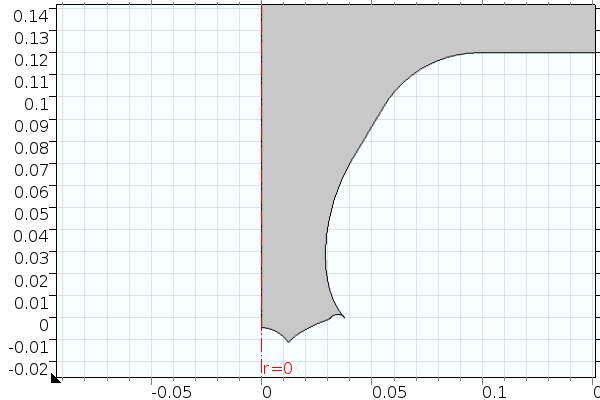

These are the values I've measured for the TC9:
- Distance from faceplate to deepest point: 11 mm
- Distance from faceplate to top of dustcap: 4.5 mm
- Diameter of dustcap: 24 mm
- Diameter of cone (top of surround to top of surround): 70 mm
- Width of surround: 6.5 mm
- Height of surround: 1.5 mm

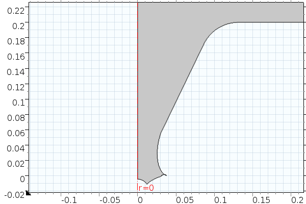

The profile looks like this in the model:

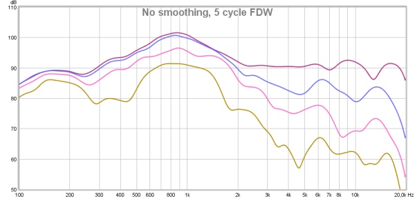

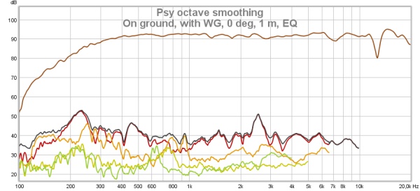

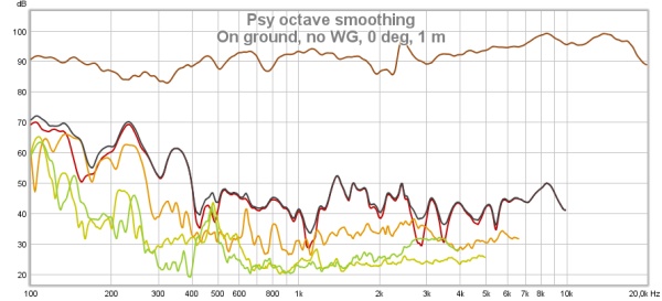

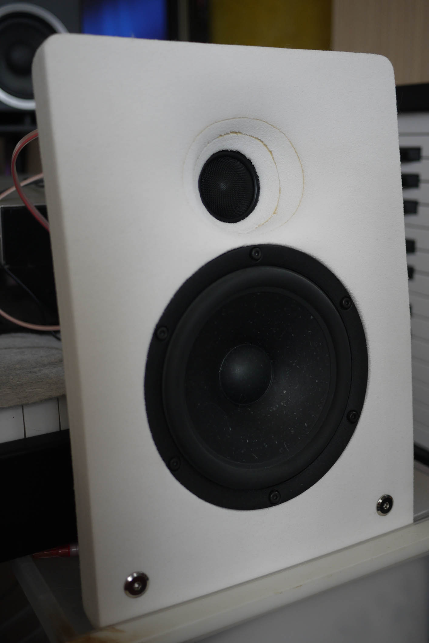

First WG made

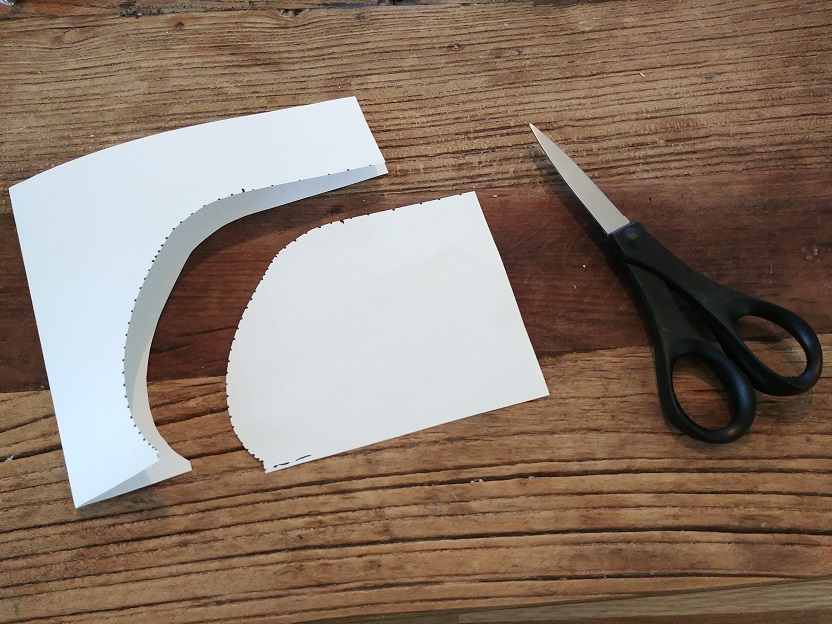

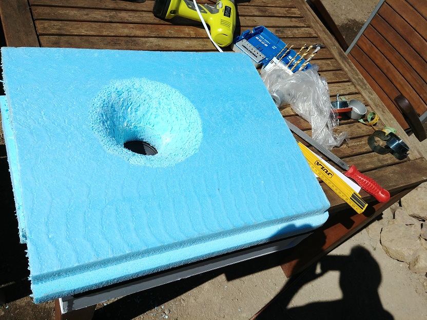

Alright, so I made a rough waveguide using XPS (from the lumber yard). First cut circular holes (60 mm diameter) in two 50 mm thick panels and glued them together. Then I traced the profile from a decent simulation (95 mm deep waveguide) on a paper.
Then I used a rasp to remove material, and controlling the result with the paper cutout.
It follows the profile with an accuracy of +-1.5 mm (yes, a little rough).

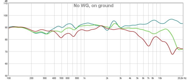

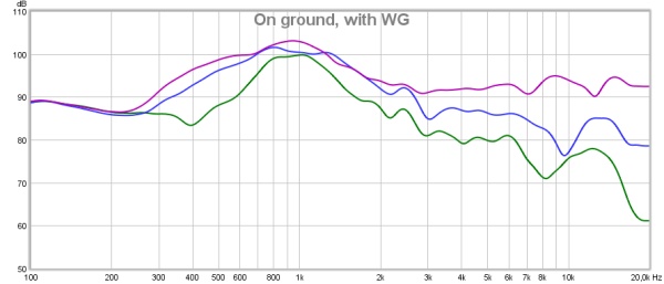

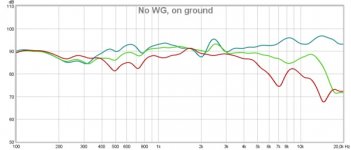

Response of speaker when laying flat on the ground (0, 30, 60 deg, 1 m):

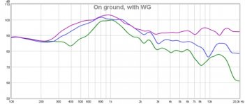

And with WG (0, 30, 60 deg, 1 m):

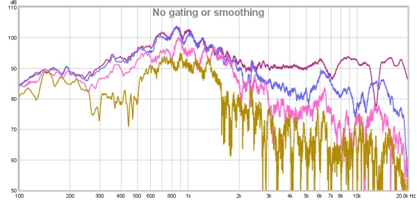

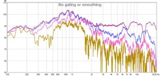

Here is with WG when on a stool on a table (0, 30, 60, 90 deg, 1 m, ~1.5 m off ground):
No gating or smoothing.

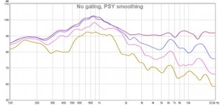

PSY smoothing, no gating.

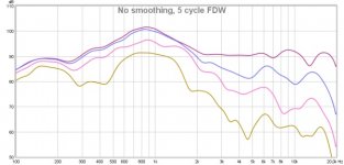

No smoothing, 5 cycle FDW (gating).

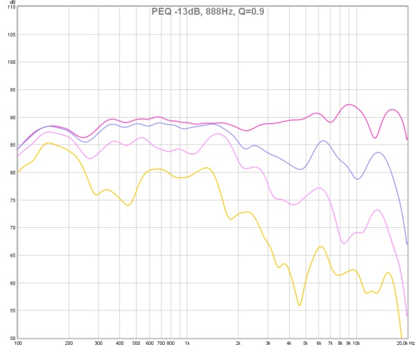

And finally, REW sim with a 1 PEQ applied (888 Hz, -13 dB, Q = 0.9).
/Anton

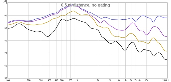

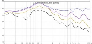

I did also measure at 0.5 m distance (when elevated on a stool on a table). Looks like this with PSY smoothing:

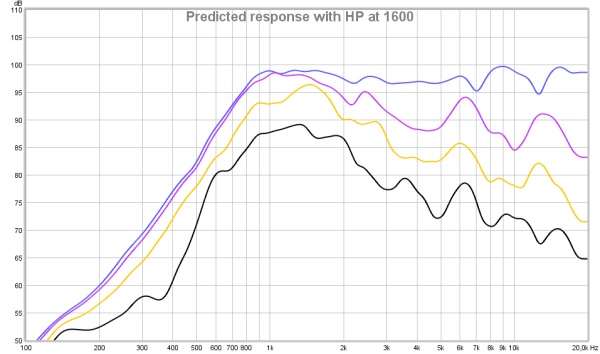

And predicted response with HP (minidsp, 2nd order Q = 0.71) at 1600 Hz:
Looks like it could cross over to a woofer around 700-750 Hz. I'd like to get this below 500 Hz, maybe a 15 cm deep waveguide will do.

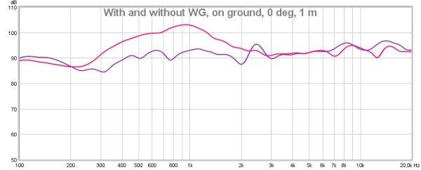

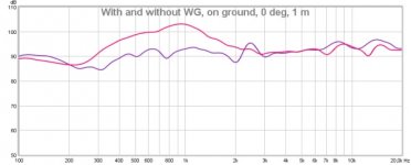

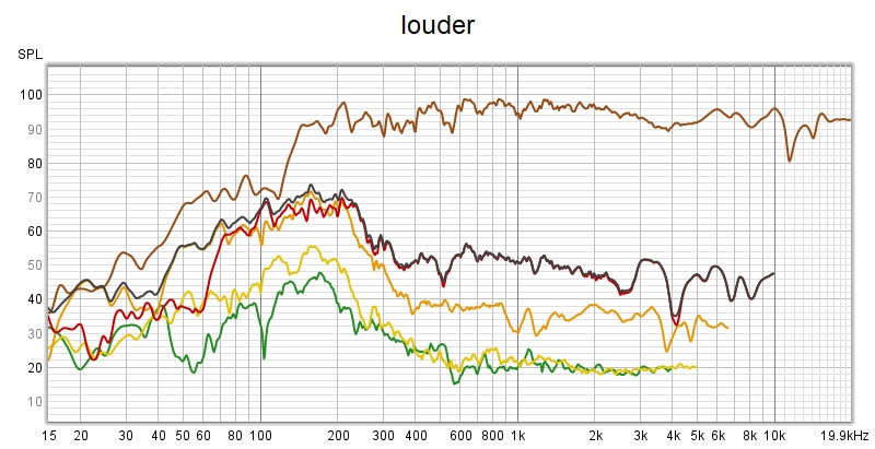

The WG increases the sensitivity between 300 Hz and 2 kHz as seen below (measured on ground):

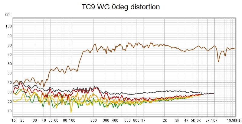

This is distortion measurement for the case without WG:

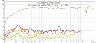

And this is with WG when EQd flat (auto minidsp):

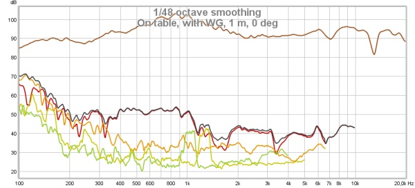

There is also a HP at 250 Hz (I think). I just set it at a value that made the distortion reasonably flat. Looks good with WG, except peak at 2.5 kHz. Third harmonic between 700 and 1000 Hz is also a little high. But when I look at the non-EQs measurement done on a table these peaks don't exist:
Note that the measurements were done outdoor with birds, airplanes, neighbours building porches etc. Maybe that's what is causing the peaks?

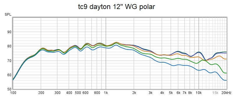

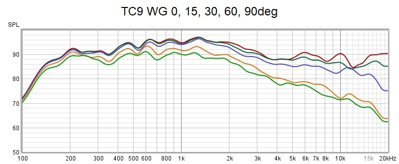

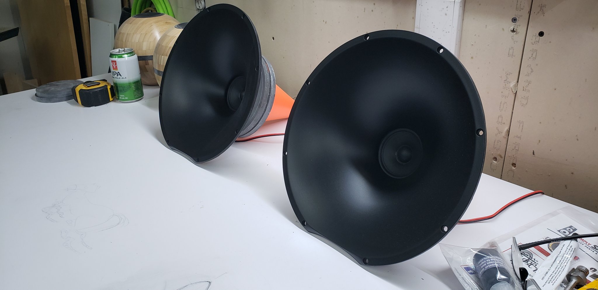

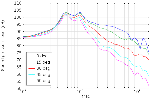

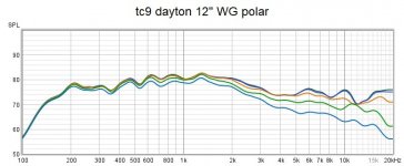

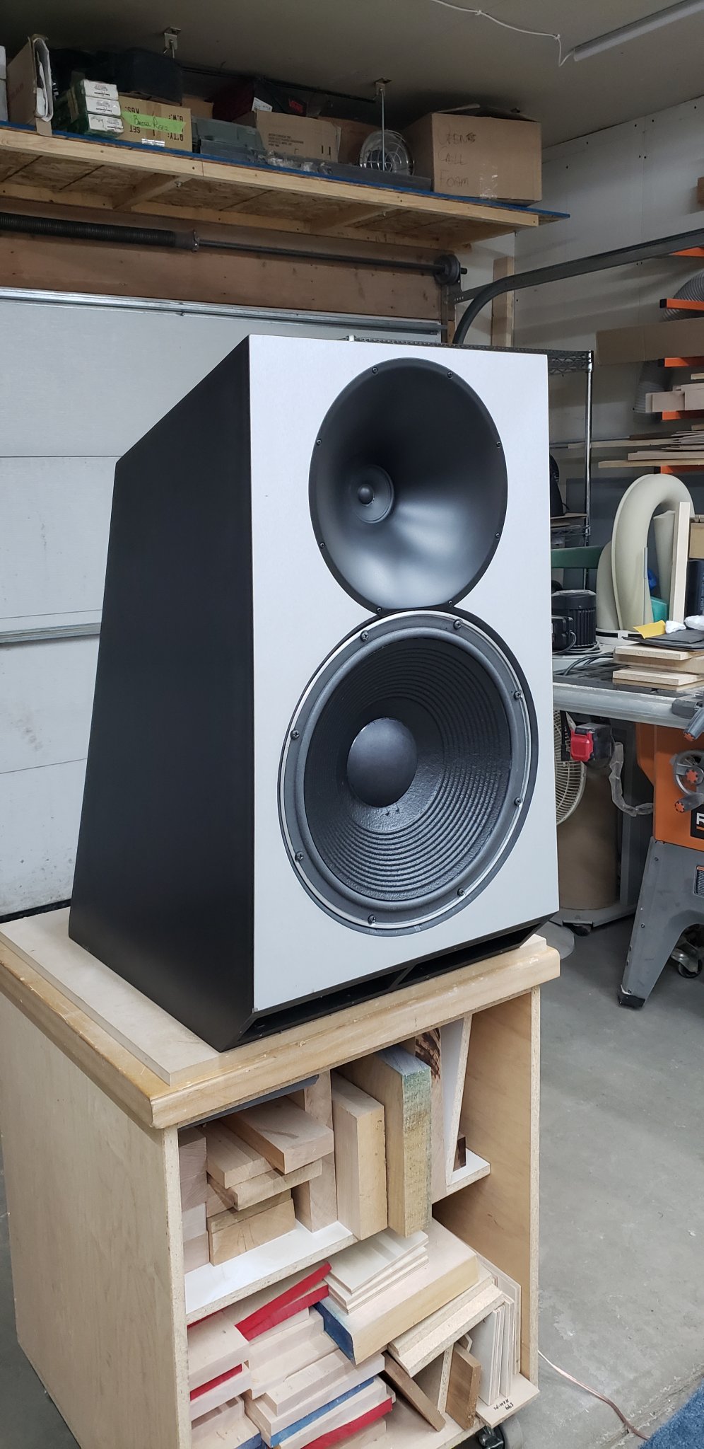

I truncated a now discontinued 12" version of the Dayton waveguide and made an adapter ring for the TC9. Polar measurements are at 1m 0, 5, 15, 30, and 45 deg.
