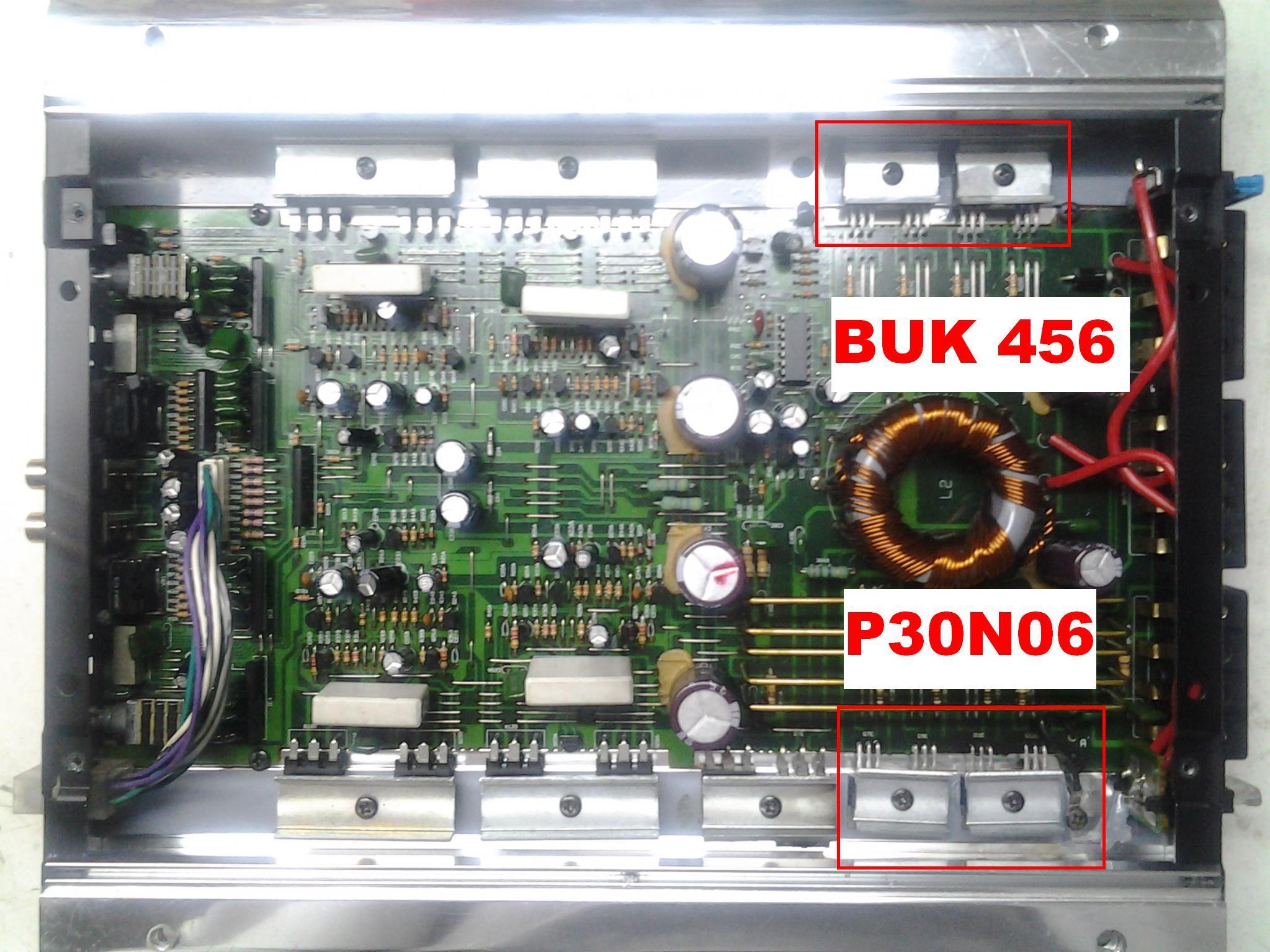

How many 30N06s are in the amp?
Does the power supply have mixed FETs or are all of them 456s?
Were the FETs shorted originally or did they short after you repaired the traces?
The 60NF06 should be a good sub if the FETs have actually failed.
Remove all of the FETs highlighted in the photo and check each one carefully. Do all of them read as shorted?
At all P30N06 drain i attach negative of ohm meter and at source the positive . The reading is 515 ohms.
At BUK456 drain i attach negative of ohm meter and at source the positive . The reading is 528 ohms
Any other attachment of the ohmmeter i did to all FETS doesn't read any shorted
If i replace the P30N06 with P60N06 will that be ok?
I am thinking of replacing all the FETS with new ones if you approve if it is worth it?

I doubt that the cologne would have caused any damage to the transformer. If any got into the amp, it would likely still smell like the cologne unless it's been a VERY long time since it spilled.
Re-check the FETs as is shown in the FET section of the basic transistor testing page (link in sig line below).

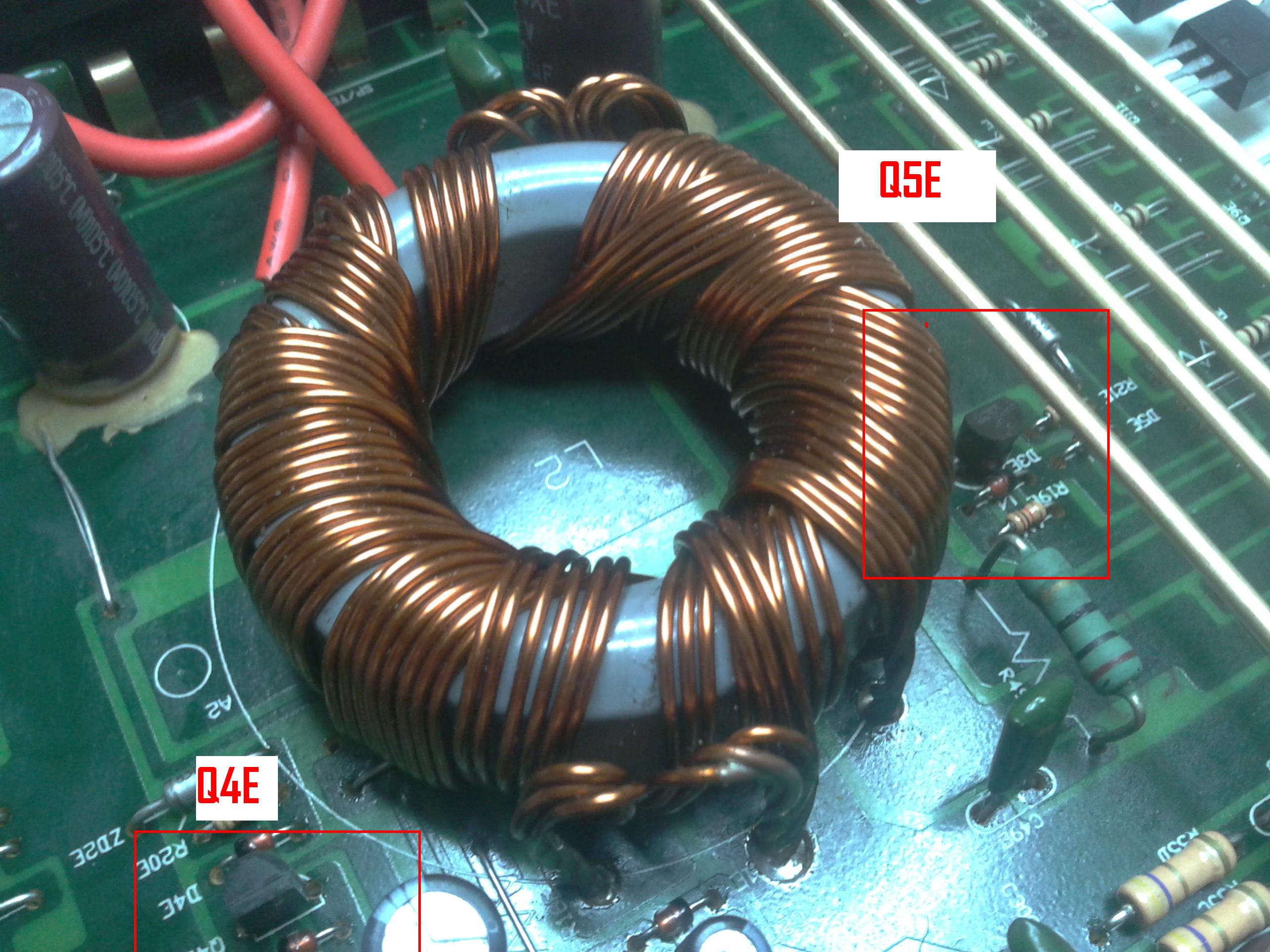

You need to remove and carefully check Q3e and Q4e. Disconnect the amp from power while these are out of the circuit.
The page that you went to earlier has instructions for checking this type of transistor.

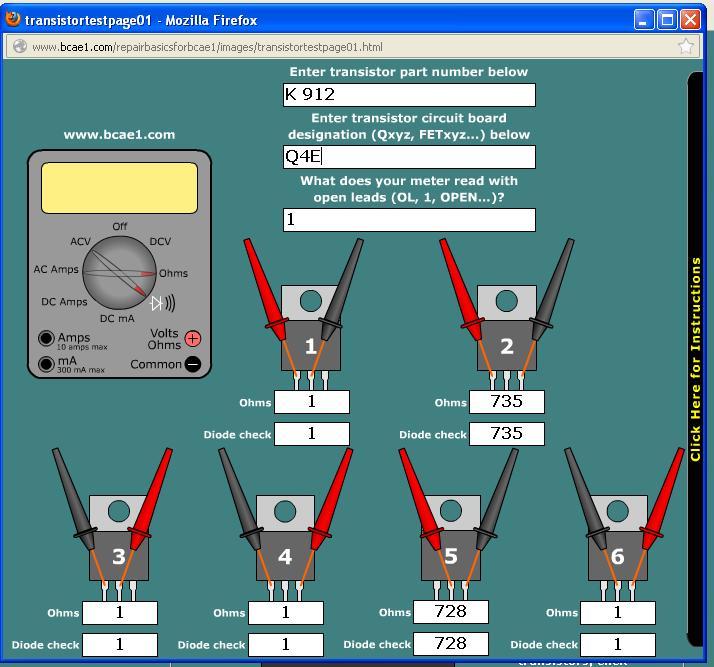

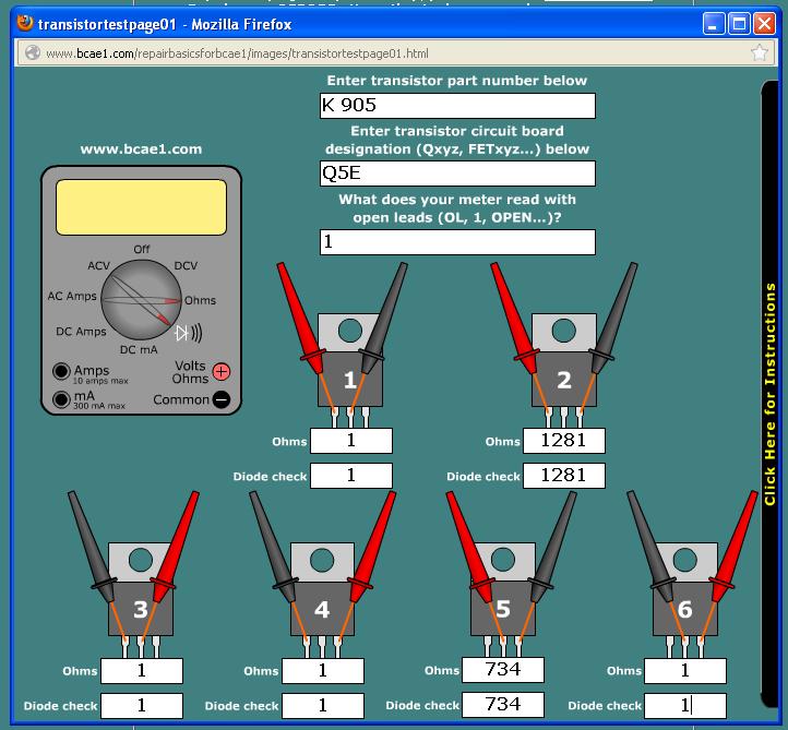

I removed Q4E and Q5E. I could not locate Q3E.In picture you can see the transistors i removed
Q5E marks on it K905 and under that A1266. I am not sure if this link below is correct datasheet
KTA1266 datasheet(1/3 Pages) WEITRON | PNP Plastic-Encapsulate Transistor
Q4E marks on it K912 and under that A1266
I could not find the datasheets for this transistors to know if they are pnp or npn
Even if i searched them as 2sck 912

It's 4 and 5, not 3 and 4.
Use the testing page applet and post the screenshots for the filled forms for the two transistors.
They shouldn't read the same on diode-check and ohms.
Q5E appears to be defective.'
The part numbers are KTA1266 or 2SA1266. The other numbers are likely production codes.

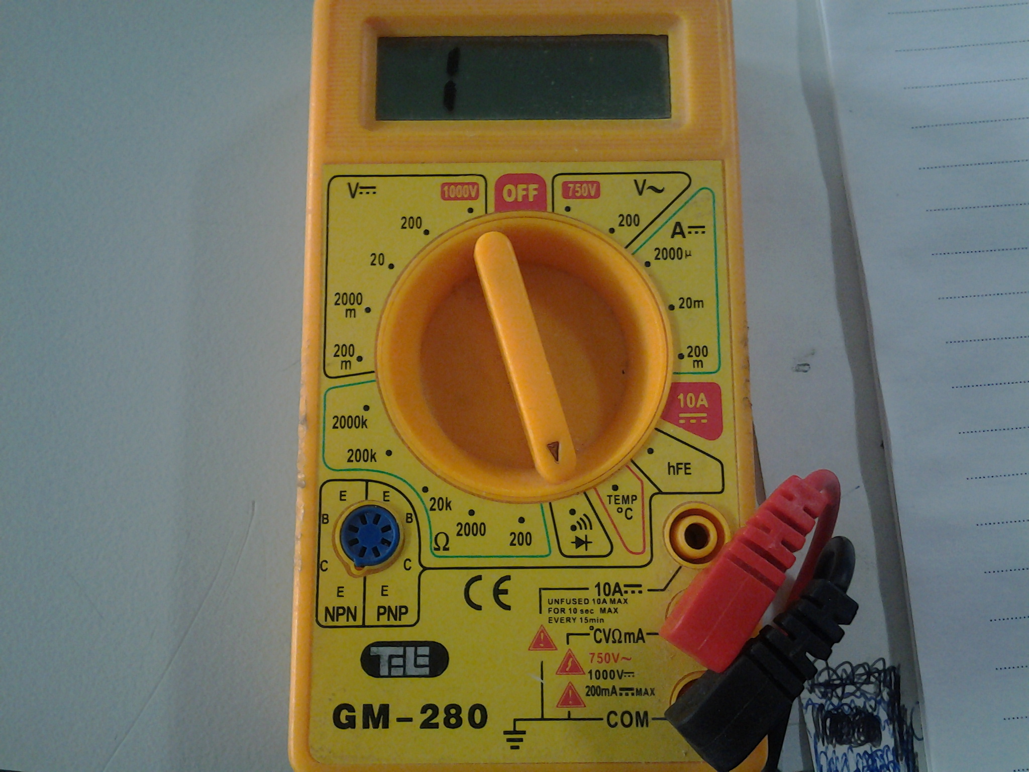

I use the multimeter at the 2000 ohms position and diode.
At 2000 ohm position i read the same with diode.

I've never seen a meter read like that. On resistance, the meter displays ohms. On diode-check, it displays voltage (for most meters, anyways).

This is the multimeter i use.
http://www5.picturepush.com/photo/a/11512713/img/11512713.jpg
I must purchase a new one better than this i think
Before buying a new meter, post links to the ones you're interested in so we can help you buy a good one. For now, you can use what you have.
