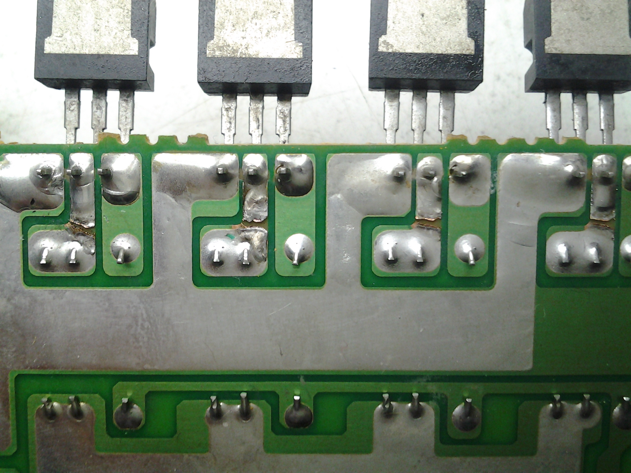

I didn't believe in my eyes. Look what i found at the pcb(photo below).
The parts are P30N06
How can this be done? Maybe someone did it ?
Stupid me i didn't see it from the beginning.
I soldered the cut pcb, i powerd up the amp and now it draws 6,8 Amps with 5 Volts at +B terminal and ground
Those generally only burn when the FETs fail but if you had about 5v on the gates of the FETs, the FETs have likely survived.
Remove the rectifiers again to see if the power supply will operate normally and draw only about 1 amp.
If it does, you'll need to reinstall the rectifiers and check to see if any of the outputs are getting hot.

If you have 0v across the B+ and ground terminals, you likely have either shorted FETs or a solder bridge from drain to source on the FETs.
Can you say if it is necessary to change the P30N06 FETS or only the BUK 456 ?
If yes is the 60NF06 equivalent?
