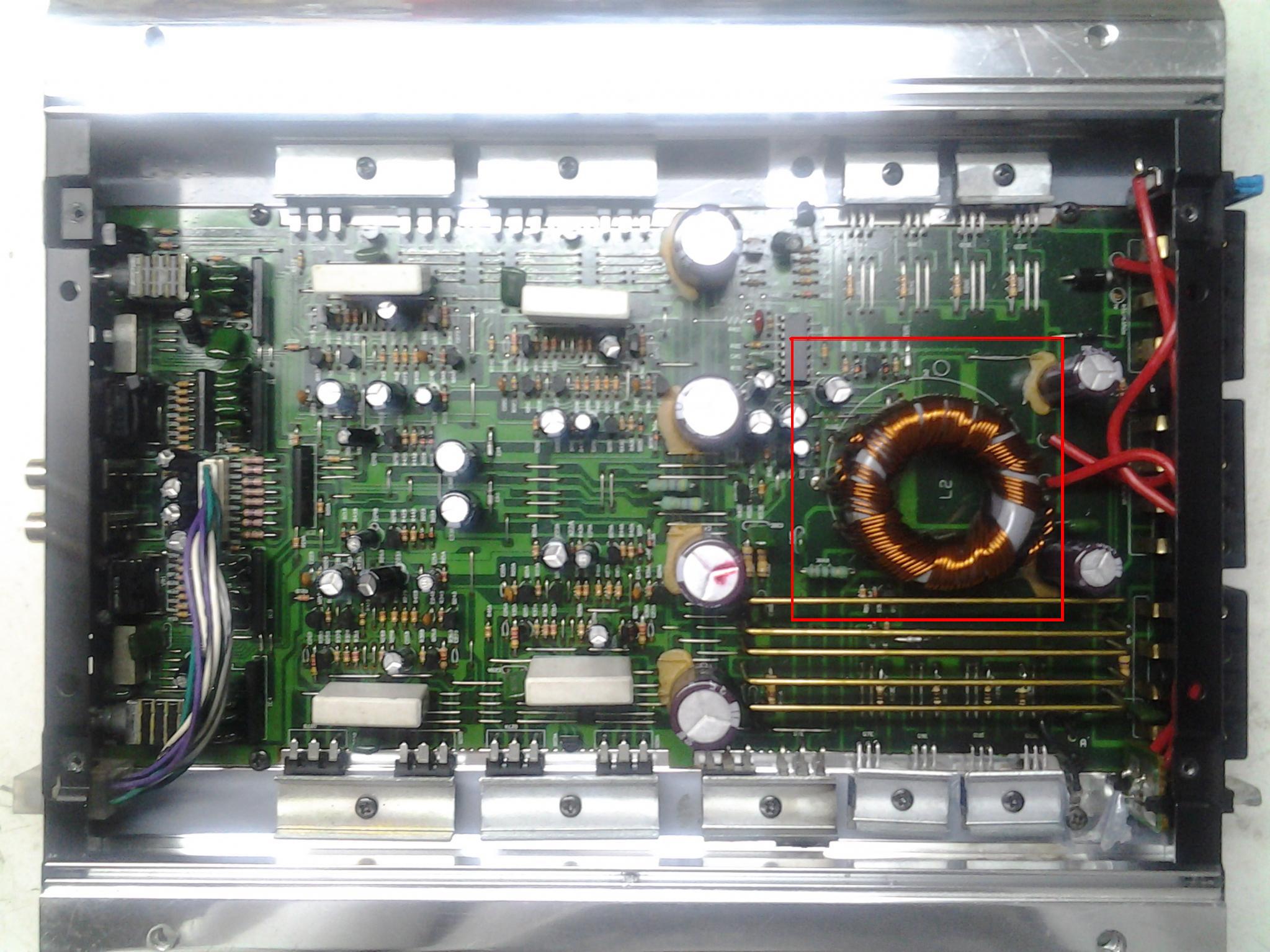

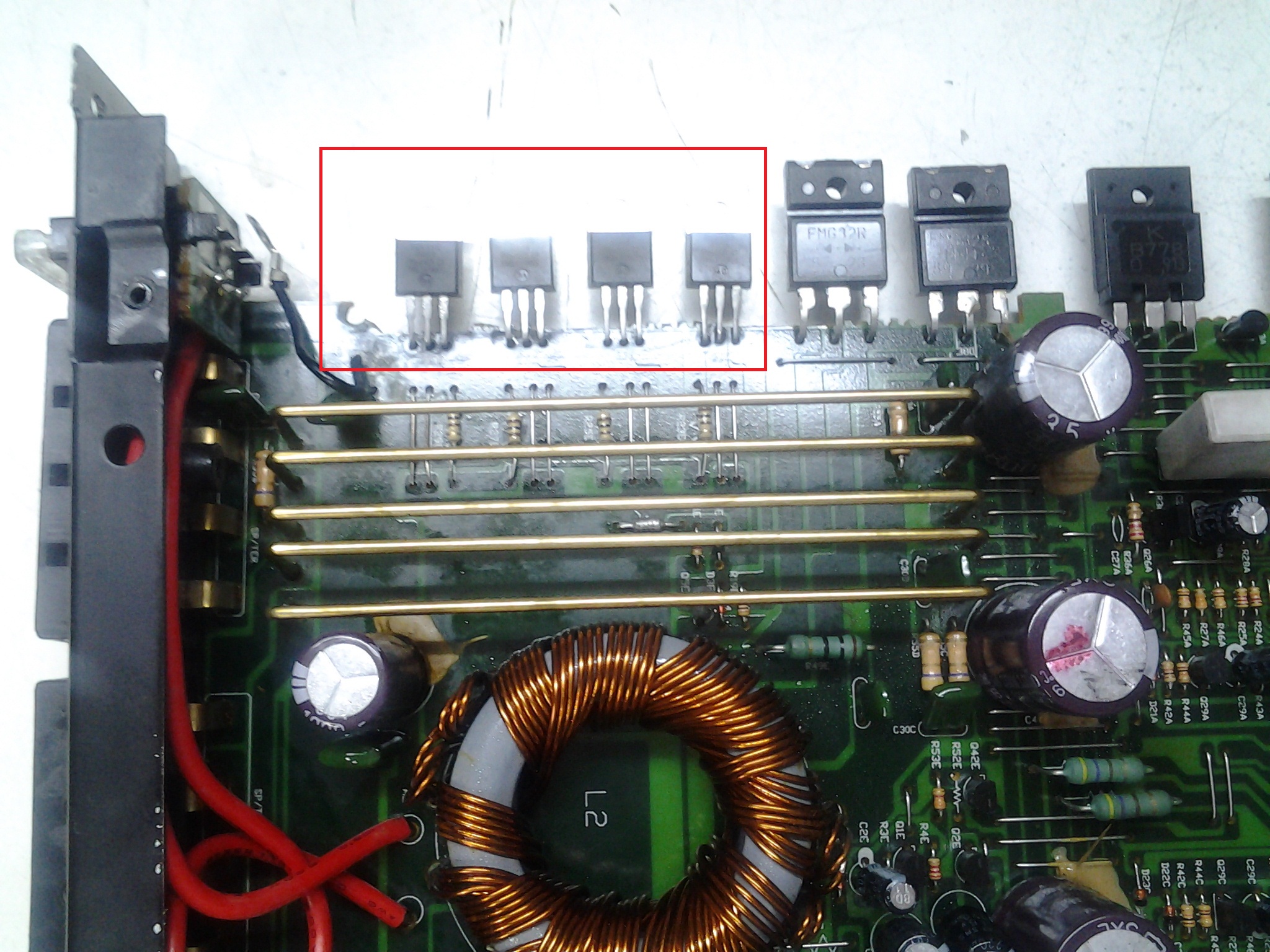

I have in my hands from a friend the amp mentioned at the title and it is faulty.
When i connect 12V on it the mosfets BUK456 goes very hot in some seconds.
Attached for anyone that wants to help i have the amps interior .
The second photo below shows the mosfets in red mark witch is hot

Hello
In about 5 seconds the amp draws 1.6 A and the FET'S start heating(not very hot ).No speakers connected or any input at rca connectors. Only power supply 12V
This time it produces a strange sound from a part on pcb. It sound like a whistle at high frequency. Maybe i didn't hear it yesterday.
If this helps the voltage at the source of buk456 is 4,7 Volts and the gate are 7,5 Volts(at startup measure 11 volts)
I was afraid to leave the amp with power connected more than 10 seconds.
Any idea what produces this strange sound? Maybe the big coil in front of the FETS ?
Thanks alot for your interest

Are you sure that you have the proper pin configuration on those FETs? The gate should be about 5v. The drain (center leg) should be at the highest voltage. The Source leg should be very near 0v.
If you twist the transformer while it's on, does the current draw decrease?
Have you checked the output transistors to see if any are shorted?
If you remove the rectifiers, does the amp power up normally with significantly less current draw?
You should clamp the FETs back to the heatsink before applying power.

Hi
I am so sorry i typed it wrong. The voltages on the FETS are:
source 0 V
Drain 7,5 V
Gate 4,8 V

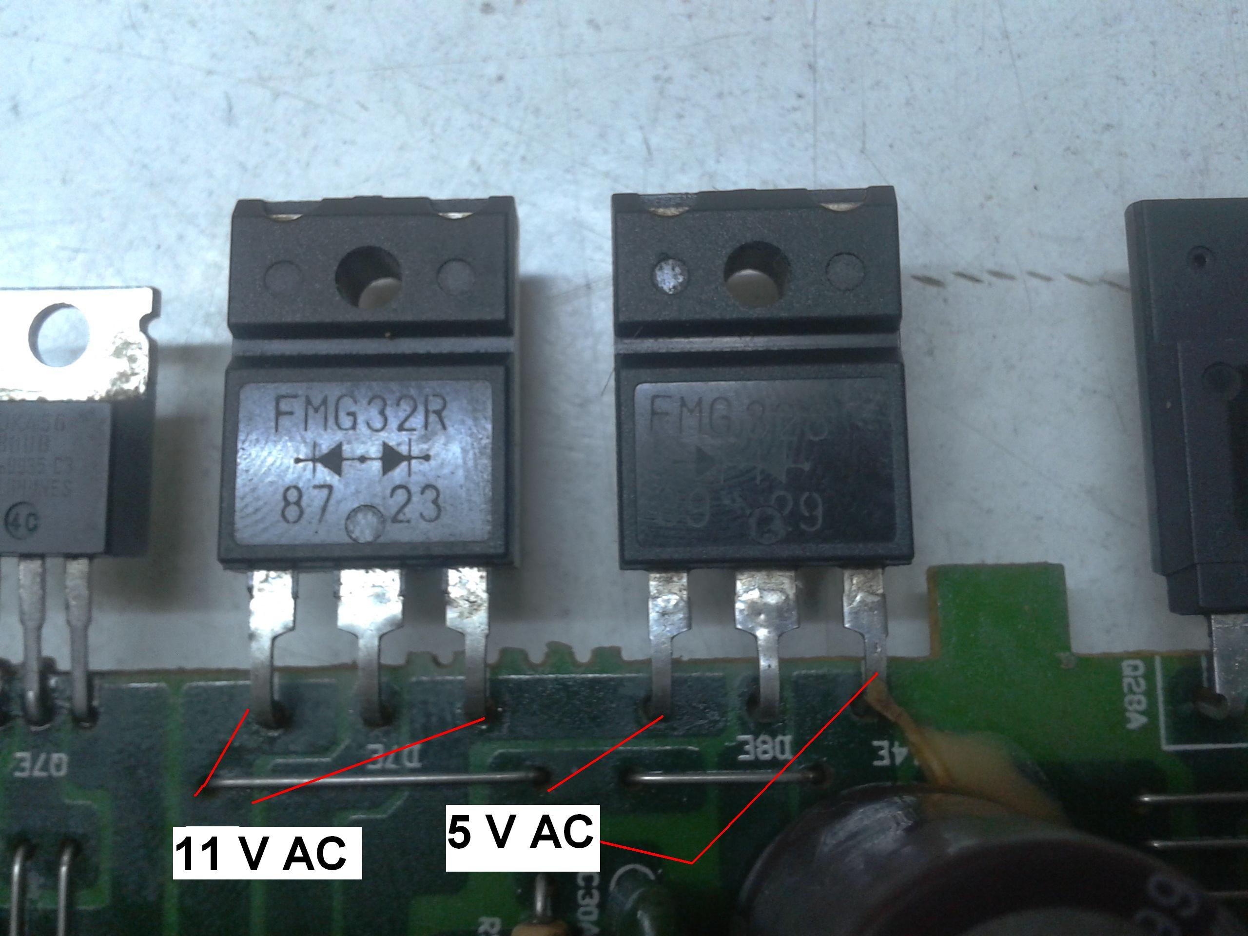

Hi
I twisted the transformer and the amperes on power supply remains high.
I removed the two rectifiers and the amp doesn't power on. The sound from the transformer remains and i think it is a bit louder with rectifiers disconnected.
Below at photos i have for you is the transformer and some AC Volts measurements i did at the rectifiers.
Is it possible the transformer is faulty ?

Is this you need ?
DC Volts at Buk456 FETS ?They are located beside the rectifiers.
This measurement below is from one of the FETS
source 0 V
Drain 7,5 V
Gate 4,8 V
I am asking because i have posted this above.
Must i measure another part ?
Opposite are located four P30N6

The power supply is up and running.
Reinstall the rectifiers and power the amp up for a few seconds out of the heatsink. Do any of the large output transistors heat up?
Are the rectifiers shorted?
If you measure the DC voltage across the outer two terminals of the large white resistors, do any read greater than 0.000v DC?
No Voltage at big wite resistors.
At big output transistors at middle pin i get 6.5 volt, at left i get 1.3volt and the right pin starts with 5volt and after 3 seconds no voltage
The voltage at IC KIA 495AP is 6 volts at pin 12( power supply pin)
Is this ok ?
