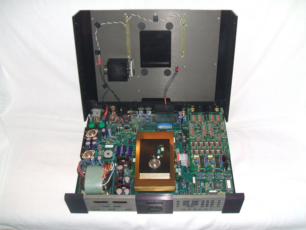

Hey,
I've just bought a second hand krell kps20i and i'm looking for some info on this machine as it has a few possible problems.
First, the player makes quite a bit of noise when the disc is spinning, eg not what i'd call quiet anyway.
second is that i seems to produce quite a bit of heat on the left side when running, i guess this is the psu area...
Other thing is the lcd display is not working correctly (time display i think) some of the characters are broken, i guess this is a fault..
Are any of these things (apart from the LCD) "normal" for the kps20i ?
Reuben
Yes, mine Krell KPS20i behaves similar with spinning noise and heatdevelopment
The red numerical display has been changed by a green version by Krell says the former owner because of the same problems.
Do you know by any chance what the four AD OP42G right after the DAC section do and the OP27G's further downstream. Thought that the I/V transfer and lowpass filtering where complete discrete in this player.
Do you have the Delta 9 upgrade with the AD 56009F 80 MHz and updated firmeware?
I haven't though.
Greetings!

Since the heatsinks for the voltage regulators are bolted directly to the left housing piece, it is very normal for that to be quite warm. The noise may be indicative of the platter motor bearing going bad or simply failing to self-lubricate, which, in my experience, can often be cured by adding a few drops of 'Prolong Super Lubricants Precision Oil', preferrably after taking apart the motor & cleaning the shaft & sleeve bearing(can't recall is this is possible with that version of the CDM-9), if the noise is actually coming from the motor. On rare occassions, noise that follows rotational speed of the disc can be actually coming from the laser's focus actuator, and can be a symptom of the CDM-9 laser getting weak(servo working harder to compensate, creating more actuator hiss).

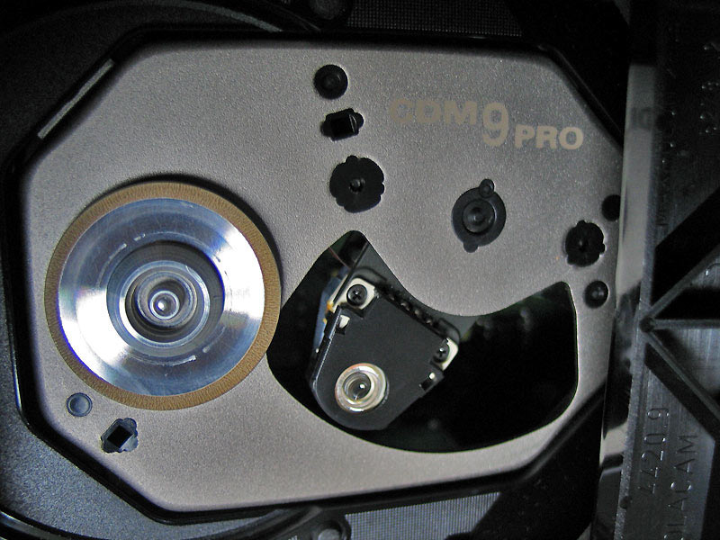

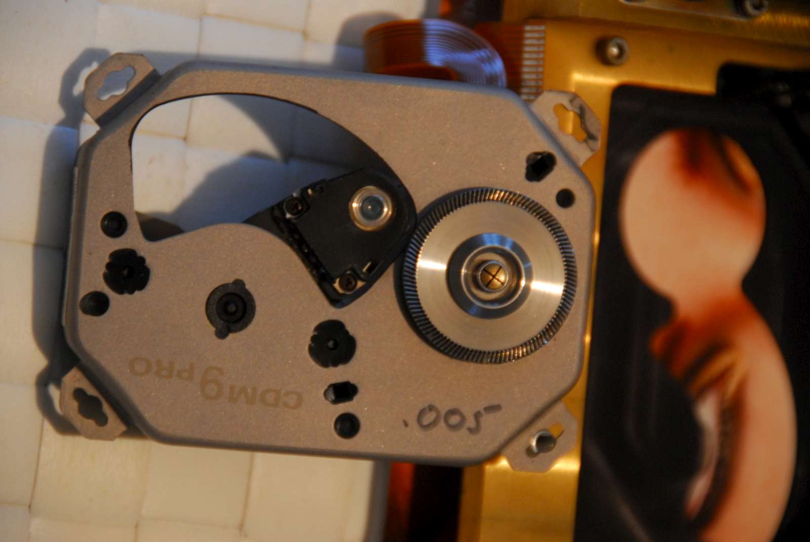

Kreel KPS20i has gone dead
My Krell KPS20i has gone dead:(
I have a spare laser but that did not work either.
Even have a complete spare CDM9-Pro turntable from another much cheapre CD Player but I think the platter on top of the spindle is different.
Krell had that altered probably for it's clamper.
Any suggestions how to proceed?
Can I get the platter of without ruining the brushless motor?
Send some pics soon.

If you are not sure the platter motor is bad, that it may be just the laser that's bad, it's not hard at all to transfer the laser from one to the other. If the platter motor is bad(saw that happen exactly once on this mech), then you'd have to either attempt platter transfer(possibly by using a heatgun carefully to make the platter metal expand a bit on the shaft), but it may not be possible without excess risk.
Hi Stephen,
I already swapped the laser but no luck either.
It moved a bit, the old one was completely dead, but it did not read any data.
Is it a correct assumption that when the laser doesn't read any data the motor will not spin?

As I know, you must check follow steps without cd insert after switch on:
1) laser head must move in start position
2) lens must go up and down several times (focus search). While this time laser light must go in "ON" position.
If happen this, insert cd and press start bottom. Either cd starts to rotate (FOK signal is present) or cd don't start to rotate (FOK signal isn't present).
You need actually a flow chart diagram for troubleshooting from the service manual.
As I know, krell haven't his own PCB for the servo board - this must actually be a genuine part from Philips. With help of the equipped ICs of that board below the mechanism - go to the image about
