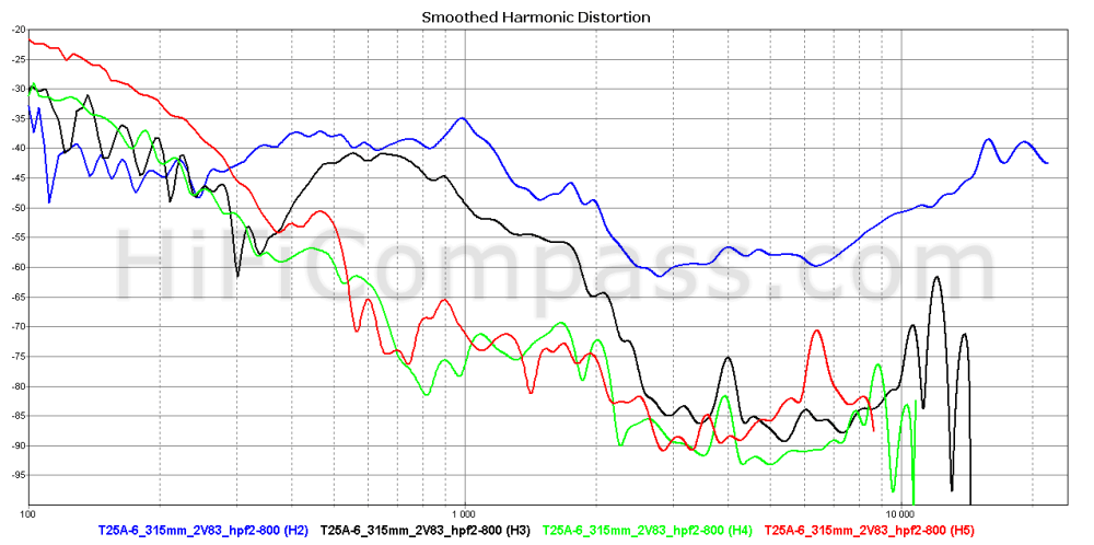

Next up? How about the BlieSMa T25A-6?

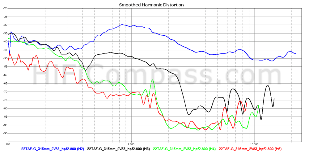

To a point, at this drive level, you'd have to say swings & roundabouts. HD2 baseline is still higher for the 22, and the BlieSMa has the edge with higher orders largely thanks to lower HD3 -but within this context [& stressing that caveat] it's not exactly a walrus-slapping either, and the 22 is still doing a surprisingly good job. Is it the best tweeter in the world? No. Is it a giant-killer? No -although as far as axial FR and 2.83v nominal HD are concerned, it can punch above where you'd expect it to be.

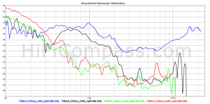

@Scottmoose : At seeing HifiCompass (hope he is ok as he is living in Ukraine) measurement, with the price, the H5 was a motivation too, and the H3 is not that bad for an increased 22 mm, as good as some 26 mm. Above 3 k hz it is measuring good about disto. The relative high H2 is maybe what is giving it that good subjective ratting in the diy world ? Anyway, the rational was to purchase a SB26 cdc but I was curious about the 22 TAF/G, knowing it asks a way higher frequency cut-off ! (and also the hybrid surround nature in relation to what some call the early breakup with dome tweeter, the relative far break up at the end, and the good sensivity and BL. I don't know about the goodnes or not of the magnitude on and off axis. H5 seems to me more harmfull than H3.
Absolutely & my best wishes as ever to Yevgeniy and his family.

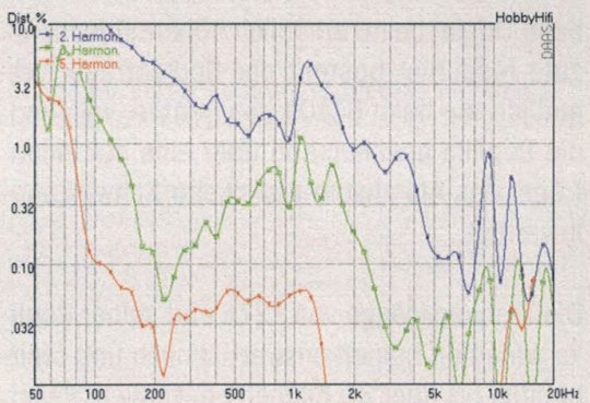

Here is the distortion at 90dB as well as the freq resp of the woofer.
Nothing to be proud of these days....
Even your totally generic no-name 5 inch woofer does (probably) better.

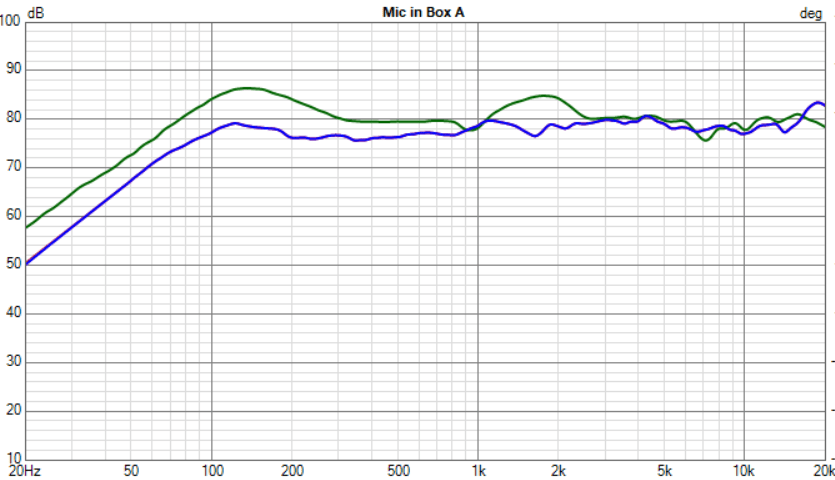

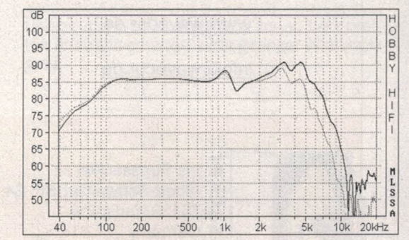

For reference, here is the original paper from BBC;
http://downloads.bbc.co.uk/rd/pubs/reports/1976-29.pdf
And here is the freq resp traced and put next to your average freq resp you see everywhere (this case Hobby Hifi magazine).
Blue = BBC paper, Green = HH
Because of tracing, there are some artifacts.
Maybe you will notice a small little difference? lol
That blue curve totally makes sense as a compromise between kinda free standing and close to a wall.
That green curve doesn't make ANY sense for the purpose it was designed for at all!
Here some more explanation;
https://www.diyaudio.com/community/...ginal-v-diy-clones.347587/page-5#post-6049795
So I guess everyone wants the Roger variant, while the original (as well as the Audiomaster) version is indeed more "neutral".
Btw, also notice in the BBC paper, how high the distortion is.
