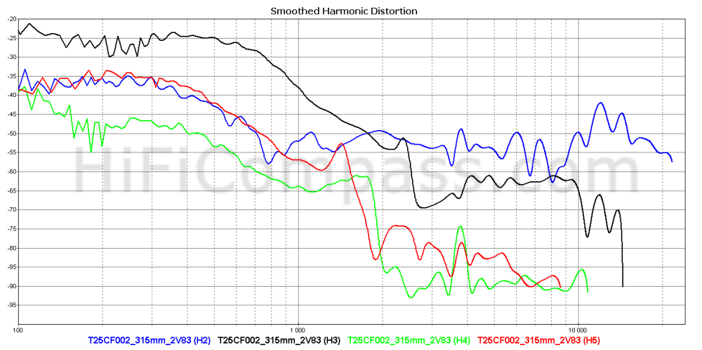

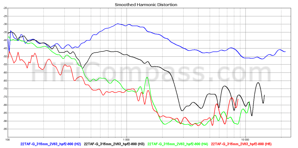

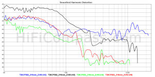

Without meaning to over-state the merits of the 22TAF/G, it's probably worth considering it alongside some nominal high-end designs, as that can be -'interesting'. Its IB axial FR for instance is ruler flat from about 1.5KHz to > 20KHz, so in the 'non-issue' category -you can more or less do as you wish with it on that front. We can't cover everything or we'll be here until Christmas, but a comparison of HD2 - HD5 @ 2.83v is interesting. Like the attached: these are Yevgeniy's HFC HD measurements of the 22 and the evergreen Millennium, respectively. The latter certainly beats it as far as HD2 is concerned, but for the rest, the 22 is arguably ahead at this drive level.

Reactions: westsounds

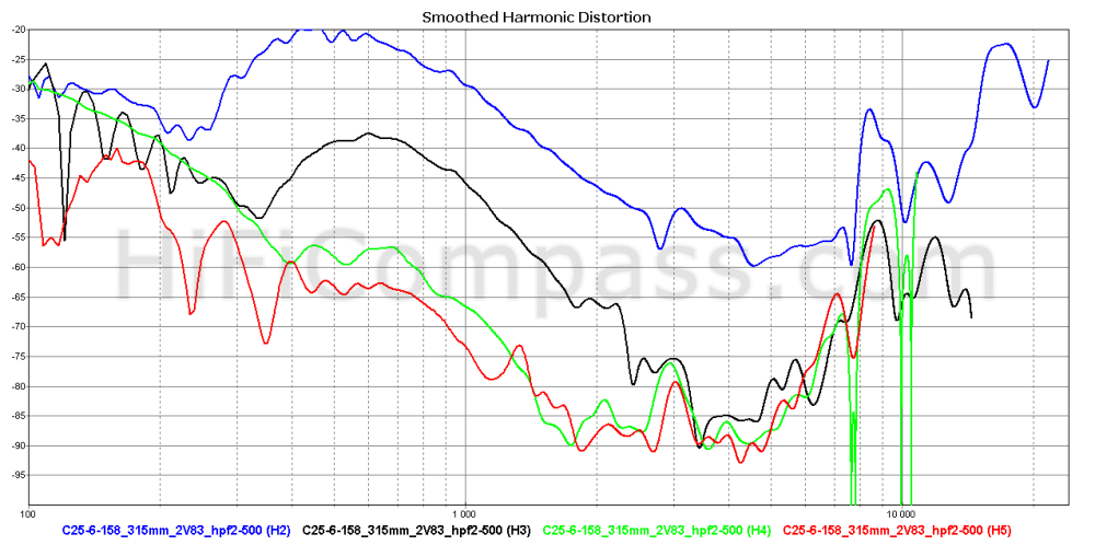

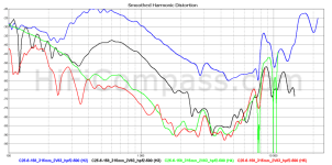

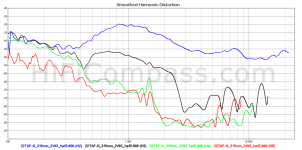

Fluke? Perhaps not. Same again, now with Accuton's wallet-wincingly expensive C25-6-158. Assuming a slight change in measurement conditions makes the Accuton's higher order products above ~7KHz more visible than they are with the Seas -it would be fair to say the 22 is holding up well, albeit with the same higher HD2 through the lower HF region. Given the price disparity -you couldn't say it's doing a terrible job.

Reactions: IamJF
