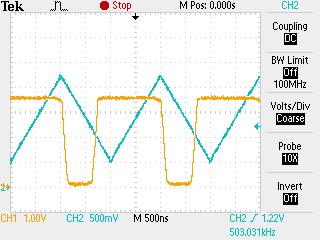

at first I want to wish you a successful completion of your dissertation. Unfortunately I stopped halfway 1994. So do your best! And Thanks for your explanations, which I have to think over a little bit.
That terrible external triggered triangle generator! My simulated suggestion does not seem to be so good in reality. I could not get it DC-stable. Thus I tried John's version, but with an inverting comparator instead of the logic IC (as a 'proof of concept', using a slow OPA TS462 and a LM393, both from STM).
Currently I use an external function generator as the trigger and a grounded scope, maybe, they disturb the signal a bit. There remains a DC-jitter on the triangle, lowering with smaller values of the feedback resistor. But its value should be kept above around 10k, because the fed back rectangle would disturb the reference and interfere with the triangle signal otherwise.

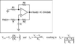

Deboo integrator
I’ve built circuits based on the topology shown, it’s very important to get the values correct on the DC FB filter components to prevent the DC stability problems. I also seem to remember I was never able to reduce the resultant “Spurs” offset from the carrier, below –100dB.
A far more elegant solution is to use a Howland current source with a capacitive load, also known as a Deboo integrator.
The Deboo integrator is NON-INVERTING, has both a ground-referenced input and output. Consider the circuit in three parts: the input resistor R, the integrating capacitor C, and the right side of the circuit — which is equivalent to a negative resistor connected to ground.
The input current equals the input voltage divided by a negative resistor. The negative resistor just changes the direction of the input current.
Search the MAXIM Website for more detailed information (Deboo Intergrator) – sorry I don’t know how to post links…

The correction of my triangle try is to be seen in this directory. Read the description file, if interested.
Charles, the software control was realised with a three-level-control (via integrated 12bit ADC and external 12bit DAC) and a cycle of 1ms. This was too slow for our application, therefore I decided to do it in hardware, to free the controller (MSP430F149) from the control business and to achieve much lower cycle times (target 50µs). The SW-PWM with a minimum resolution of 12 bit could achieve a cycle time of 512µs at 8MHz clock, not much better than the current solution.

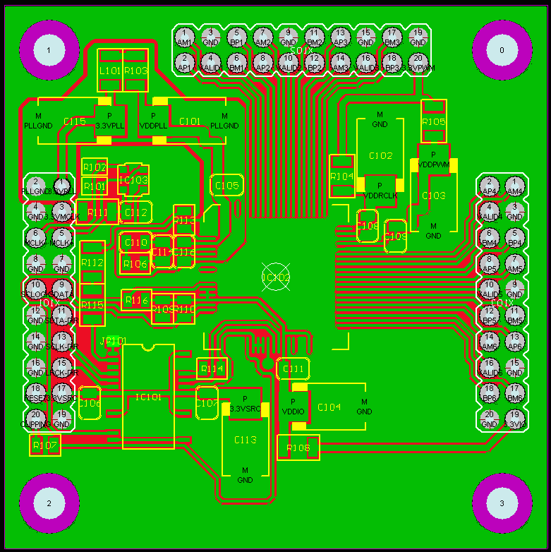

Attached is picture of my TAS5076 modulator board. I have decided to use modular approach, so this little board has only TAS5056 and SRC4192 with decoupling capacitors. This little module will sit on a larger motherboard which will contain clock, SPDIF receiver, power supplies, micro controller for TAS5076 control etc.
I intend to experiment on motherboard with various clocks, power supplies etc. As John has pointed out, clock performance is major parameter in achieving good results with digital modulators. So I have decided to route balanced signal (LVDS or PECL) for clock to my module and have balanced to TTL converter on the module.
The problem is, I have no idea what to use for balanced to TTL converter. Clock frequency will be 25MHz, since TAS5076 uses internal PLL. So far I think my possible choices are:
fast comparator like AD8611, LT1719, MAX999, LMV7219,
LVDS receiver like TI SN65LVDS34D, MAX9130, MAX9111
PECL to TTL translator like ON MC100EPT21D.
Comparator would be the most universal possibility since it would allow also unbalanced (sine wave) clock source, but on the other side PECL to TTL translator has 500ps rise and fall times and 0.2ps typical jitter. Because of internal PLL in TAS76 that probably is not a great advantage.
I would really like to have some advice, since I have zero experience with clock sources.
Best regards,
Jaka Racman
Jaka,
I used the TI LVDS SN65LVDT20 & SN65LVDS10 SOT23 TX & RX devices on a recent design. I found there Phase Noise performance @ 100MHz to be poor. Despite data sheet claims for sub pS jitter performance, it is not stated how this was measured, over what frequency bandwidth & what form / length of interconnect was used between the devices.
LVDS is EXTREMELY again read !!EXTREMELY!! sensitive to coupling from secondary sources such as Fast edge CMOS signals – even on a well designed / ground plane 4 layer PCB. The LVDS devices I have tried have VERY poor LF noise performance – i.e. close in carrier noise. Maybe both issues are due to the Low Level signalling current used in LVDS technology.
Due to the poor performance of LVDS on the design, I hand modified the PCB to UHS CMOS clock distribution and gained an extra 5dB to 6dB dynamic range.
During the design of the above board, I used a TEK 11801C & SD24 TDR system to optimise the PCB termination components – with very little benefit, so this can be discounted as a source of error.
I also found that the performance of the above LVDS logic quickly fall apart with increasing clock rates – maybe they will work better @ 25MHz, but you would still have the LF issue.
I would VERY strongly recommend that you place your clock oscillator on the modulator PCB, as this is the critical node. Distribute the clock from the XO in two separate buffered paths with Fairchild UHS tiny logic inverters – I use the NC7WZ04P6 Dual inverters – supplying a separate clock path to the modulator and the SRC.
Although the TI has an internal PLL, its still good to know that you have provided it with the best clock you can – I guess no argument here!
To reduce noise on the PCB I would strongly recommend squeezing 27Ohm series termination resistors on all of the PWM outputs. This really helps to reduce ground noise / EMC - Good Luck!!
