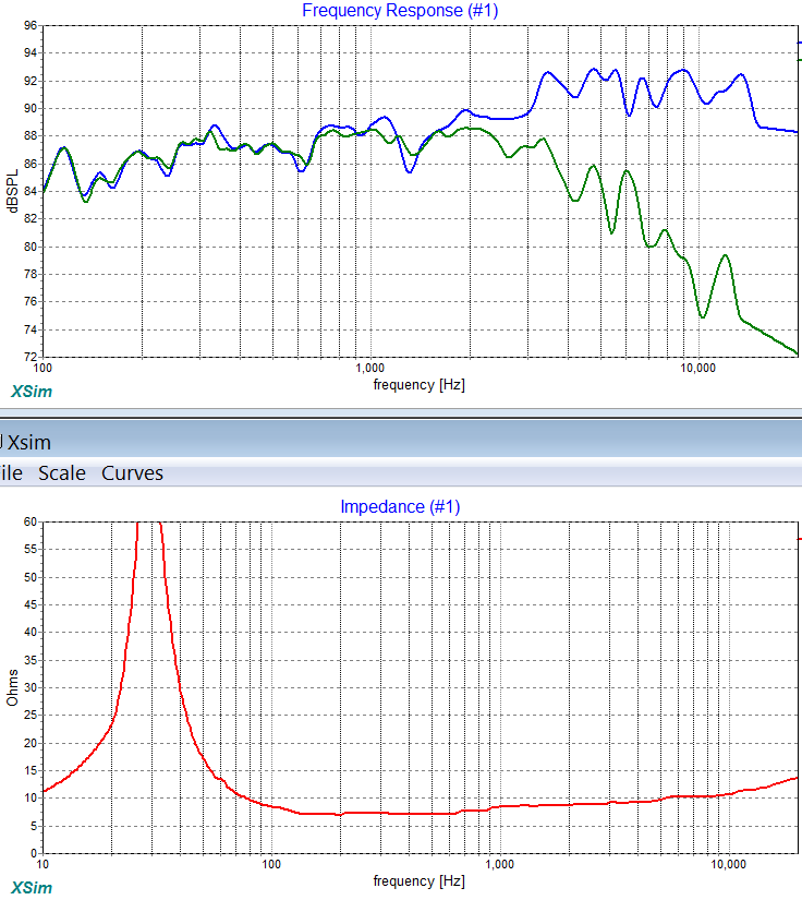

Anyone have frd and zma file for MW16P-8

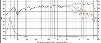

Those automatic tracers sometimes have a mind of their own, but some can be constrained.
I used to use something called SPL-Trace, which would step you through frequency, and you'd click on the level at that point.. hundreds of times per plot. Plenty accurate until arthritis sets in 😉
I used to use SPL trace which was a PITA since I the info provided by manufacturer was hard to follow especially the impedance plot.
I then tried other tracers that are "auto" and they would only trace certain segments of the graph acceptable then go beserk on other sections rendering it useless.
I recently was told by someone online that my traces must not be good because they saw something that was unusual. I havent looked at them in awhile but figured since these are popular drivers someone must have a zma/frd of them.
uploaded. if you notice the impedance scale is weird.

The impedance scale is linear. You'll find both types and the tracer needs to know the difference.
Yes, this image was a real challenge. I think perfection could be had if it is cleaned up first, which would take longer than using spl-trace 😉
