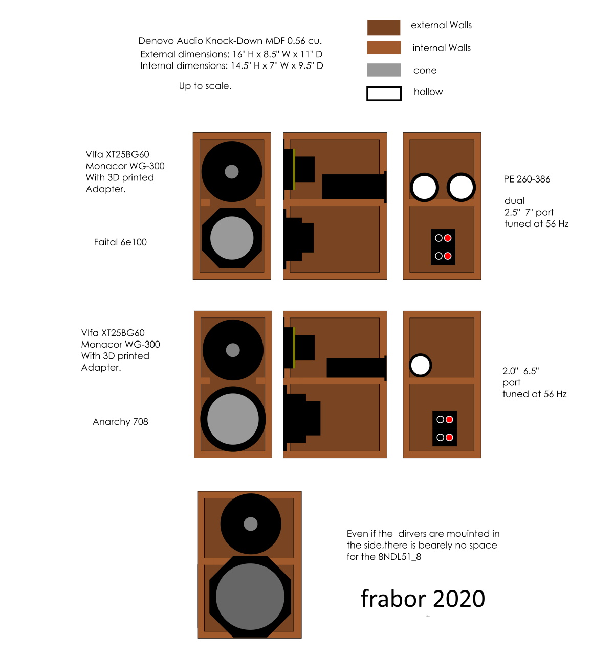

Tks Patrick, Ill look for them. Even half *** files will let me improve my quarter *** Vituix proficiency. Thinking about making a two way Anarcy .5 cuft with the Vifa XT25BG60 with the Monacor round waveguide. Wish I could use the BC B&C 8NDL51 but will not fit on the .5 pe box. Do you think this combo may work well. Tks in advance.

I understand that the B&C needs a sub while the Anarchy does not, and that can play close to 10 dB higher, at a similar efficiency range than the XT25. Yes decision at the end is to use a sub or not. I have modeled the size and in the premade enclosure I want to use (almost no woodworking skills), it's borderline impossible to install the B&C 8NDL51, drivers will be too close to the edge.
At this point I am gearing towards the output. In the "higher" efficiency range that can fit the PE .5 ft3 enclousure, and with a fs below 70Hz, all I can find that fits is the FaitalPro 6FE100-8.
All sizes of ports are just quick sim to see what can physically fit on the box.

oh, lol, yeah, if you're using a box that size it literally won't fit.
I would probably look at some 6.5" or 7" woofers from SB Acoustics.
The cheap Faital drivers are good for their price, but the SB drivers are a step up.
The SB woofers are a great middle ground between the Anarchy and the 8NDL51. All three are great. The Anarchy is the least efficient, but has the most bandwidth. The 8NDL51 has less bandwidth but the most efficiency. The SBs are right in the middle.
Of course, if you've already purchased the 8NDL51 and the Anarchy, I'd go with the Anarchy.
I know how this analysis paralysis works, I have four of the 8NDL51s here, along with both the 6" and the 7" Anarchys, the SB Acoustics in 7", 5" and two different cone materials (paper and aluminum.)
Decisions decisions decisions...

Your box seems a little small. I went with .9 cf per driver, this is taking account for the space consumed by the driver and vent. I used a 3 inch by 9.25 inch tube for the vent tuned to 38hz. I like the driver, maybe look at it sealed in such a small enclosure? I realized my thread was on a different forum. Here is what could be a link. I chopped it up a little but is is on AVSforum and you could search for
