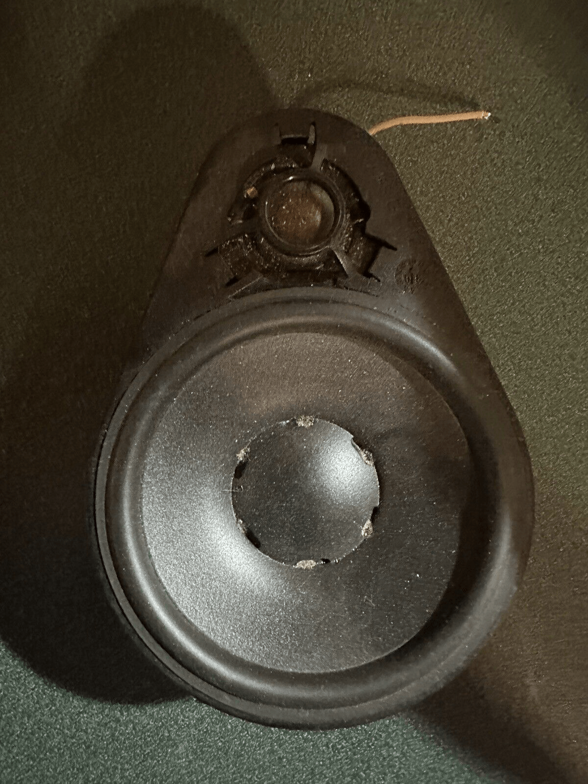

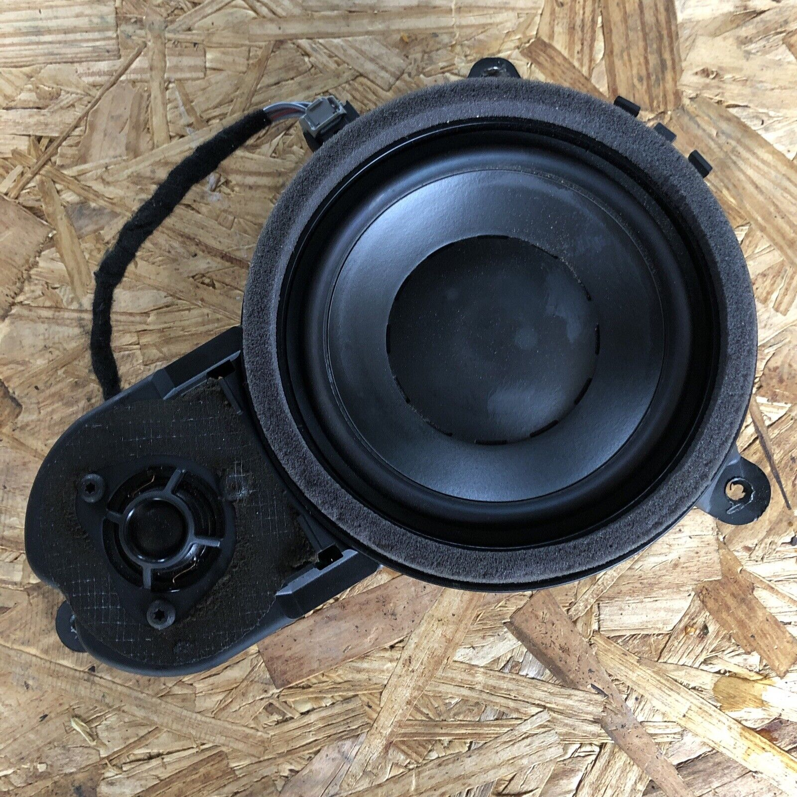

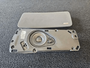

I would look for these (Check the ohms- some car speakers are 2 ohms):
(pictures 1 &2) Volvo C30 C70 Dynaudio Center Channel Speaker Mid + Tweeter OEM 30772942
Volvo OEM Passenger Dynaudio Premium Front Door Speaker XC90 30752353

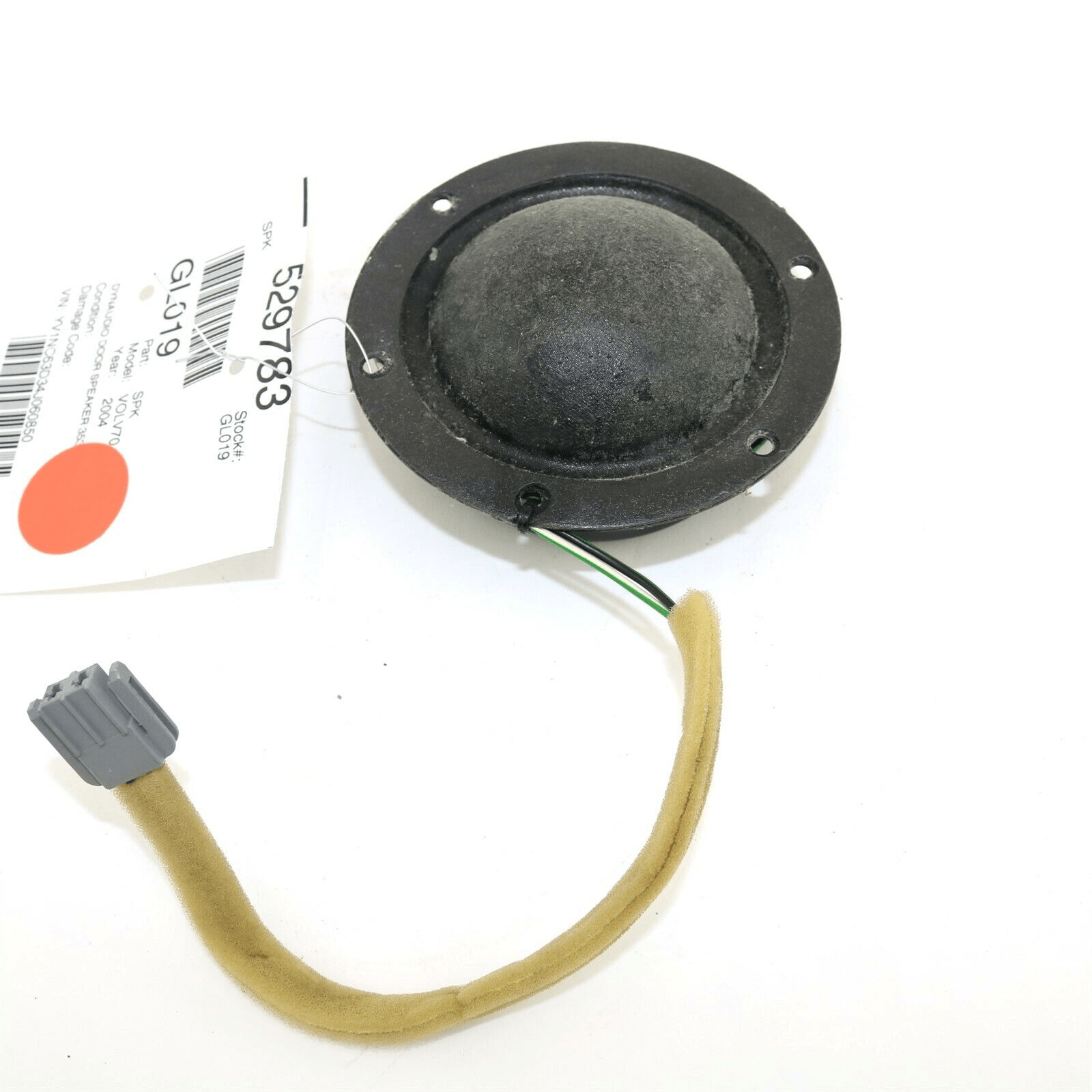

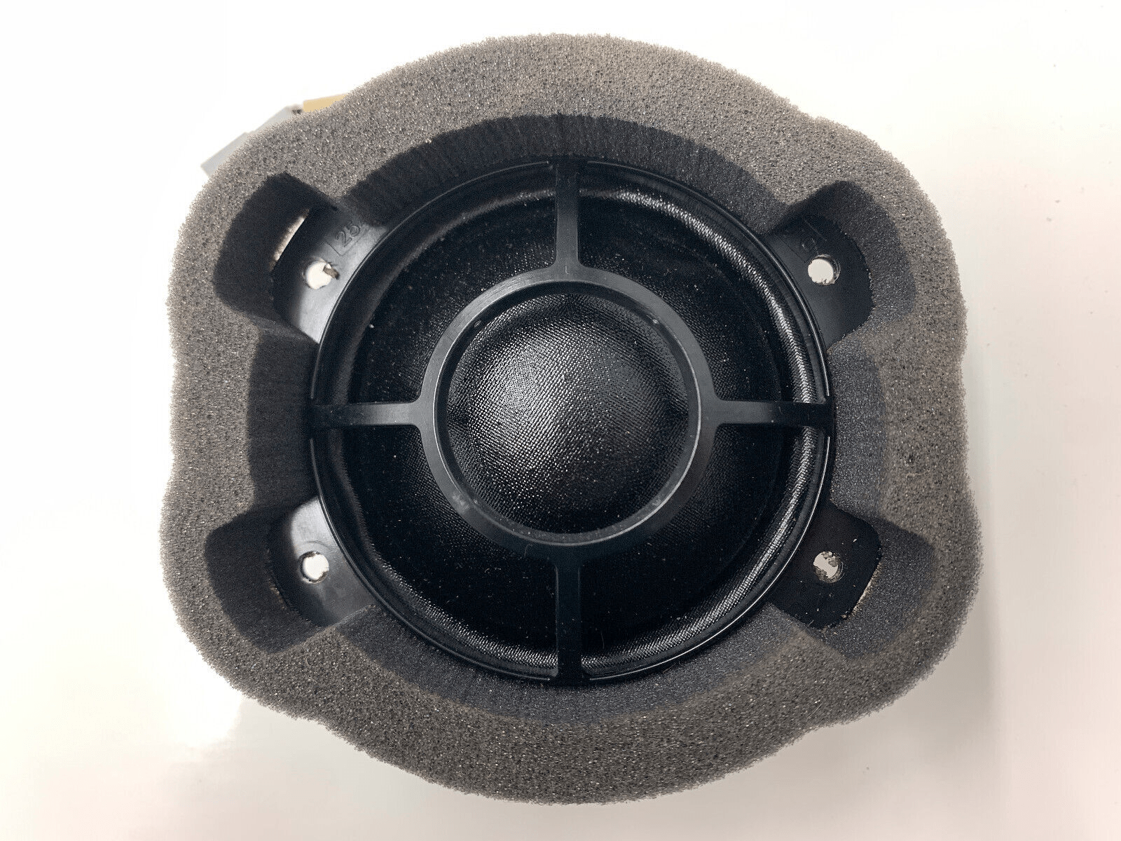

Dome Mid
Volvo OEM Dynaudio Mid-Range Dome Speaker 3533792 for C70 1998-2004
06-13 Volvo C70 Dynaudio High Performance Mid Range Speaker 30679365
