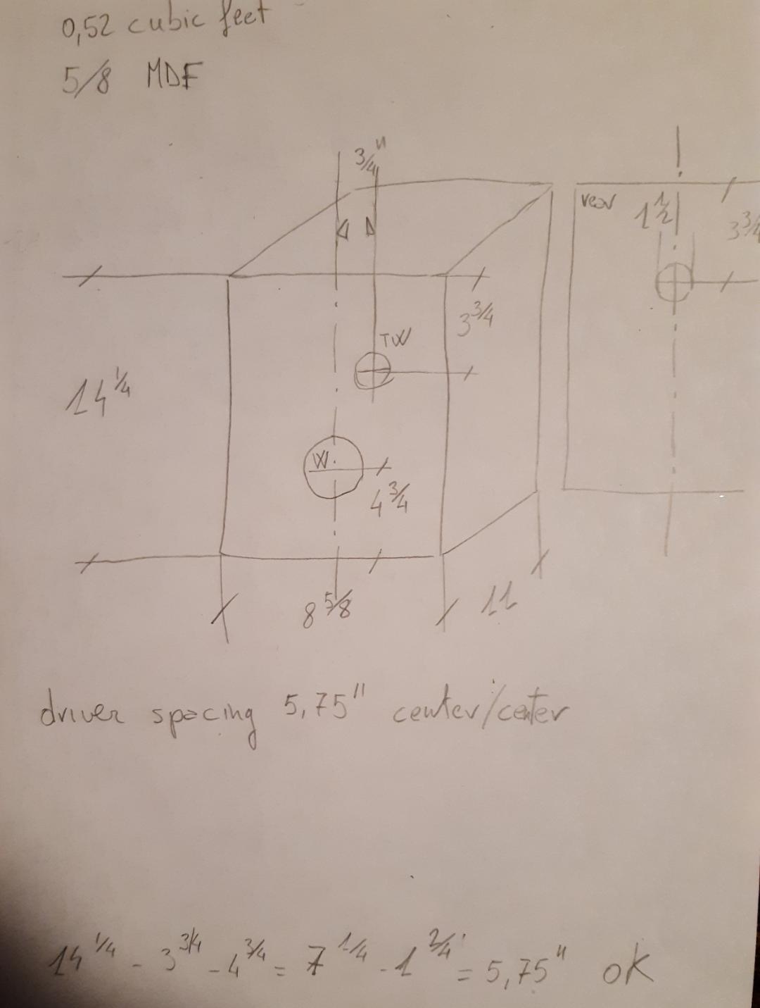

Here are my BR-1 cabinet measurements:
  • 8 ¾” W X 14 ¼” H X 11” D
  • Tweeter center is 3 ¾” from top and offset ¾” horizontally
  • Woofer center is 4 ¾” from bottom and centered horizontally
Remember the Left – Right tweeter offsets are mirror images. Over at Parts Express a couple of people said the cabinet is 8 5/8” wide, not 8 ¾”. So I re-measured with digital calipers and got 8 47/64. That’s close enough to 8 ¾ for me.
Hello,
I made a sketch on a sheet of the known measurements and the distance between the centers of the two speakers is the one indicated in the manual so I would say it is perfect. I placed the central reflex at the same height as the tweeter. Sorry, I am starting to be a bit old, no CAD at the moment.
