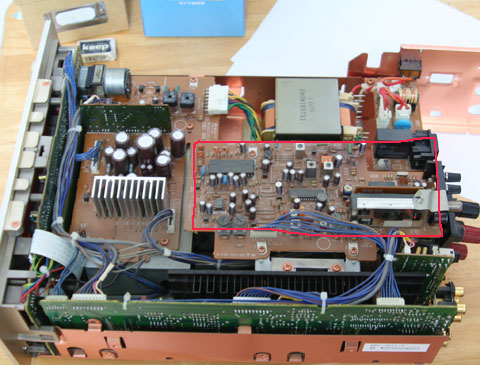

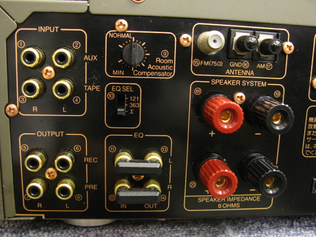

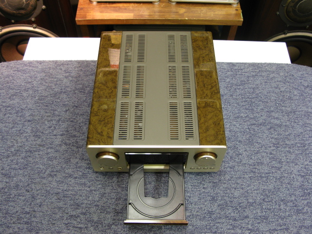

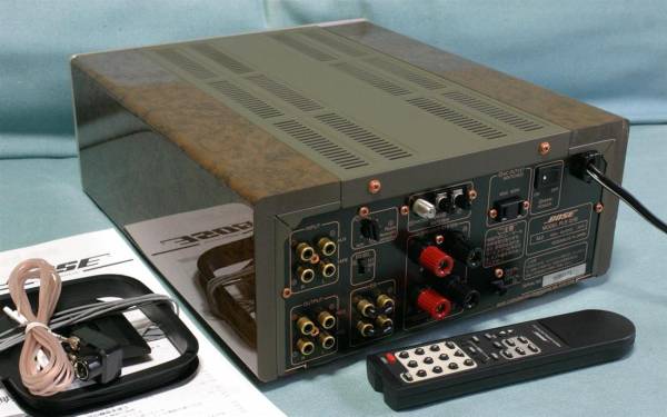

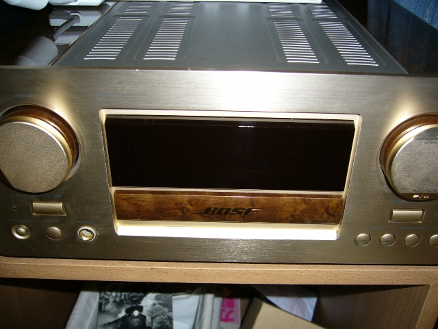

My bose aw1 radio also arrived DOA, but @ $5 I wont complain and the wife has wanted one for 20 years. Ergo I fix this one and give it to her as a B'day present if only to prove her wrong ... OK fine that's the beer talking ... OK.
Now I have the manual, except I cant edit it, and I cant post just the schematic.
Has anyone fixed this issue in a bose wave radio - no display and no sound - except for a faint hiss when plugged in and a light pop when unplugging, and none of the buttons on top, on/off, volume, channel up/down etc etc has no effect.
I will post a schematic as soon as I figure how.
