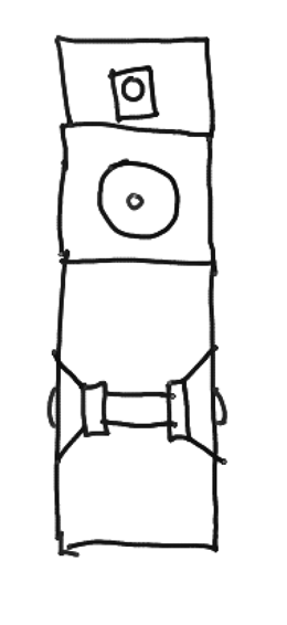

Precisely! That is why two drivers mounted back-to-back - and rigidly coupled - is the answer to this longstanding problem! (At least, for the woofer.) The reaction forces cancel, thus eliminating the driver movement, and enabling a "soft" coupling between the driver frame and cabinet. Thoughts?

Twice as many drivers and poor directional characteristics. It works as you say, but the resulting system now has more problems that the one you solved, which was not that big of a problem to begin with IMO. Enclosure radiation is just not that big a deal and its easy enough to make a well damped cabinent that doesn't exhibite any significant issues. But you can't do anything to the system that sacrifices directivity control - thats everything, or at least the single biggest problem. Solve that first and then nibble away at the remaining problem. You'll find that cabinet vibration and driver coupling are far enough down the list that you won't actually get arround to them.

There are a couple of manufacturers who have used your idea of back to back mounted drivers with success in the very low frequencies. But as far as I know the drivers are still rigidly mounted to the cabinet. As well as each other.

push-push drivers work best at bass frequencies so it may also be that one needs different approaches for differnt frequency ranges.
For example a push-push bass with a stiff, damped, heaviily braced cabinet mated to a widerange/midrange in a lighter (but equally stiff) tear drop shaped cabinet maed to a tweeter that has no cabinet.
Agreed. I am only advocating this approach for the woofer or subwoofer (see awesome picture).
