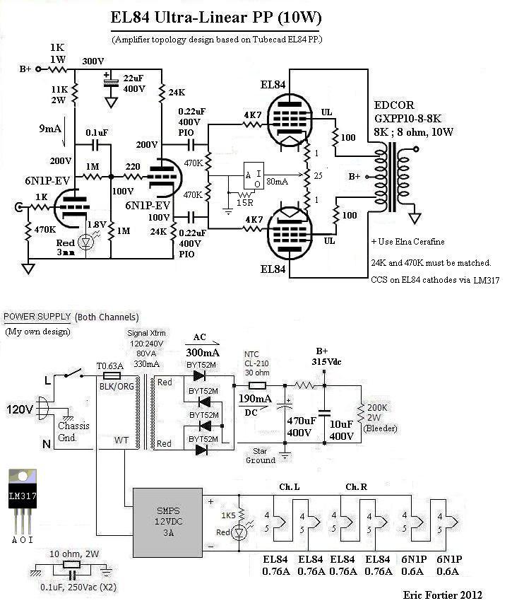

I took some measurements and am not sure how to calculate the dissipation of the cathodyne section. You are really just changing the drive characteristic. I say try 24K and see how it sounds. Presumably it would be driving a little harder than 30K...
If we use the original design by Tubecad it's a typical PP Class AB output triode strapped EL84. Would it be very difficult to modify the amp to a Ultra Linear output and have lets say the first 3-4W in Class A and the remaining 4W-11W in Class AB.
Easy listening (low power) would be in Class A and when more power is required the amp would switch over to Class AB. This can easily be done with SS but what about while using tubes ?
6BQ5 spec sheet recommend 130 ohm for both tubes or 270 ohm on each EL84 while using a B+ of 300V, I believe changing the value for Rk on each EL84 for a specific value (which I ignore) will provide what I'm trying to achieve. Does anyone has any clue and how do I get there.

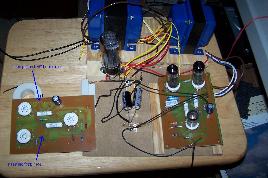

the reason I'm asking is because I'm putting together an amp using a PC board I made. I have one 6BQ5PP with p2p, and now this one. i have the pc board made up so that I can use either a resistor/cap or CCS. I just want to get the best bang out of it.

I have attached my schematics to visualize it better.

The key with the CCS is to make sure your PT allows for serious bias. I am at 81mA per channel ~ 40.5 per tube. I am using a balance pot to keep them idling the same.
Someday I will see how close I can get to 100mA per channel without redplating.
Also, beefy OPT's are key...the Edcors are great...Going off memory I think mine are the 25W 7.6K. Not sure I would go beyond 8K.

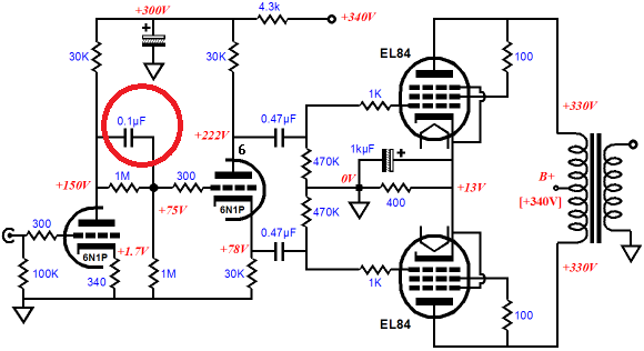

Could someone tell me the role of the circled cap on the attached dwg. Should this be a good quality cap like a PIO or an ordinary non polarized will do ?
Does the signal goes through it or is this just an AC bypass ??
BTW, I used a LED on the driver's cathode and a CCS (80 mA with LM317) on the EL84 cathodes (without bypass cap). I'm using UL connection, not triode.
Output power (before clipping) with B+ of 300V on anodes of EL84 is
6W rms (Class A) and if I use a 135ohm, 5W resistor (Class AB) instead of the CCS I get 10.5W rms.

See this thread, starting with post #2. A good metallized polypropylene would be fine used here.
http://www.diyaudio.com/forums/tubes-valves/121693-direct-coupling-question.html
