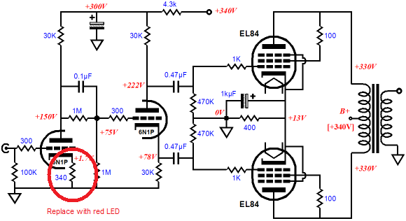

Yes, there is an error in the schematic. 200 would get you closer but I ended up with an LM317 CCS biased to ~82mA per pair. Highly recommend this mod... YH's Lazy Man Constant Current Source
My PSU is the Tubecad PS-4. Its a CRC with 47uF at each C. R is 150ohms (2x300 parallel) B+ is spot on 340V. Heater voltage comes by a voltage doubler rectified to 12.6VDC - the 6n1p's are in series and each el84 pair is wired in series.
The Edcor transformers perform flawlessly.
I just started messing around with LED cathode biasing at the front end where you only need 5-10mA of current...I may convert this amp next once the 300b is "done"...
Yeah I guess for one extra component, the CCS is the way to go, I'll read up on that.

Can you get some voltage measurements on the Vin and Vout pins of the 317? I'm curious about the differential...
I have an amp that I want to try this on, but it has individual cathode resistors, so I would need the YHLMCCS set to 40ma (requiring 4 in total and probably 30ohm resistors)
Would the Vin to Vout be higher or lower with the current set lower?
Do you still have the cathode bypass caps in the circuit with the YHLMCCS ? Or are they removed?
Would it be possible for you to draw a schematic of what you have right now? That would be really quite helpful.

I will dig in tonight and post my findings...I forget how I last had it set up.
The beauty of adding pots and sharing one CCS for the EL84 pair is it makes tube matching not a major issue as you can tweak so each tube draws the same and reduces complexity and cost.
You can always count on the LM317 to drop 1.25V so a 31.25 ohm will give you your 40mA. I guess dedicated CCS per cathode would also address tube matching...

The biggest reason for the individual CCS is to keep the existing wiring as intact as possible...
What about the cathode cap? is it removed with the CCS?

I finally got around to trying out red LED's on the first section cathode of the 6n1p. The bass appears "cleaner" and I think gain has increased a little most likely due to there being no bypass cap on the cathode on the original schematic and I never tried one...
Definitely worth a try!
The schematic calls for 1.7V across that resistor so I just replaced the resistor with a single red LED. While 10mA might be a little "hot" for a 6n1p it ran all weekend with no red plating - and sounded GREAT.
I did not use a bypass cap either. I have tried with and without on my 300b experiment and it seemed to make little if any difference with and without a cap.
Also there are many tubes out there that like to run at 10mA so I think this makes tube rolling a little easier without having to change the cathode resistor all the time...

Have you tried to wire the EL84s in UL mode? I know the Edcor OP that you use with a 40%
UL connection.
UL connection.
Actually I am running in UL mode...that is how I initially wired it up and just kept it that way. It sounds good enough that I do not desire to try any other modes...yet anyways...

Have you implemented the LED bias to the input stage? If so, you wouldn't happen to have a schematic...? 🙂
