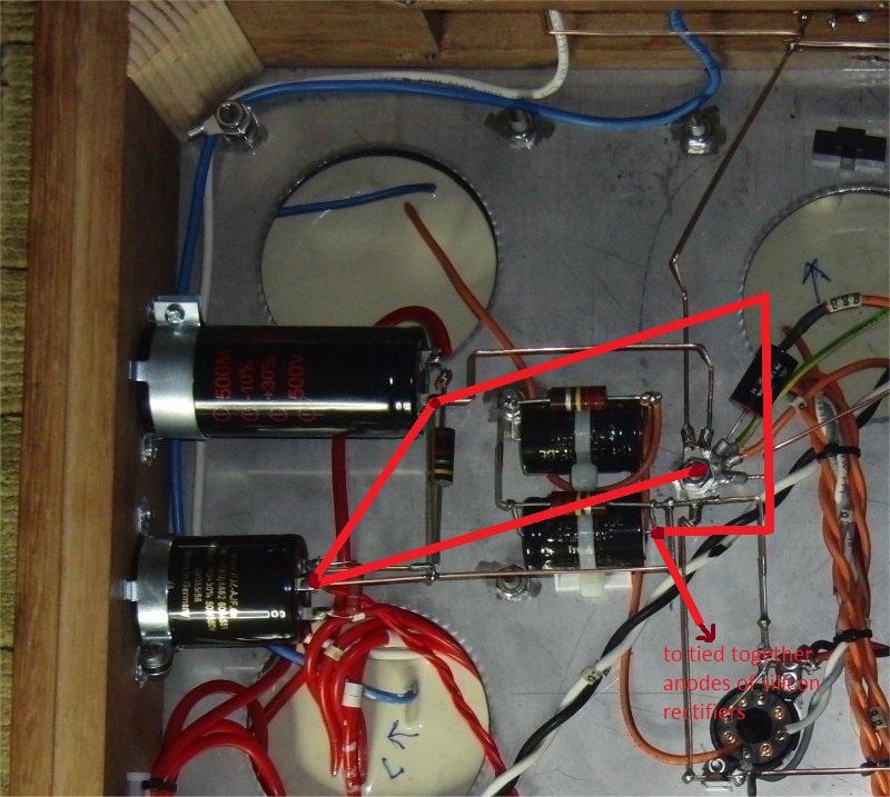

When I said all the grounds of rectifier and caps, I meant per channel of course.
Sorry couldnt edit on my ipad...
And do i see this correct? Are your big powersupply caps grounds connected to each other AND both to the starground? If so, start with cutting the connection from the cap closest to the rectifier. The ground to starground connection that is....
I can't see the diodes in the picture. Anyway, if the diodes for each channel are connected directly to the reservoir capacitor -ve for each channel (the correct wiring for separate secondaries) then this could be the source of the hum. Remember that the common secondary and the common star point mean that the two diodes conducting (one per channel) are connected in parallel. They won't be perfectly matched so one diode will take most of the current. This means that the ground connection between the two reservoir caps will carry ripple current. On the opposite cycle it may go the same way or the other way, depending on the diode matching/mismatching. These two ground connections are thus dirty and must not be used for anything else. You seem to use them to connect to the -ve on the smoother cap for each channel. Thus you are injecting ripple into the smoother cap ground. Bad hum is inevitable.
You need to rethink your grounding. Think about where the currents go. Regard each piece of ground wire as having a significant resistance across which a current will generate a voltage. Also, the +ve lead to the reservoir caps should follow the -ve lead so it minimises the loop area enclosed by charging pulses.

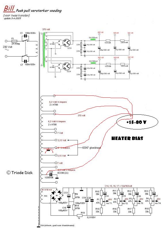

Is there a reason for the diodes to be connected to the reservoir caps or could the go directly to ground instead? I mean so that the diodes and caps dont share the same ground lead.

No they should be connected to the cap, and in my opinion, the only connection from powersupply chain (xformer, rect, cap, choke, cap) to star ground should be at the last cap. The one closest to the ampifiercircuit, the same one you pull b+ from...
But really look good at your grounding across the caps, I can see two loops already. (as i tried to exlain earlier). Maybe I wasnt clear? Its often difficult to rephrase my thoughts in english....sorry for that.

The problem isnt in the schematic, its in how you build it. All grounds are connected.always.
But sometimes you have to split them up, and make 2 or more star grounds in an amplifier. But there always remains a connection between them so they have to same potential (v)

The grounding going of to the right goes to the bias supply. I guess this should have a separate ground going to star ground.
Come to think of it the groundwire from the bias supply is possitive and connected to ground at the 500uf cap. Could this be the reason for hum? Maybe the bias supply should have a separate grounding to star ground??

No definitely not! if the positive of the bias supply isnt grounded, it has no reference to ground, ie it wouldnt be a negative voltage, which is required for biasing, so it must be grounded.
You should give it a direct connection to star ground, however, only one per side, and only from cap ground to star ground.

Youre right, I understand that the cap nearest to amp circuit is to be grounded to star ground, in this case the lower double cap in the picture.
Here are the diodes

1. Get rid of one pair of silicon rectifiers. There is no point in paralleling them.
2. Connect the -ve of the two reservoir capacitors directly together.
3. Connect the 'ground' connection of the diodes to somewhere on this -ve link.
4. In one channel, connect the diode ground point to the smoother -ve and then from there to the star. In the other channel, just connect the smoother -ve to the star.
5. The bias supply should be grounded to the star (at the bias supply output only - you don't want to inject bias rectifier ripple into the ground).
You then have the output of your dual PSU connected to the star. Charging pulses are kept away from the star. You still have a minor problem of smoothed ripple from one channel appearing in a ground connection for the other but I don't know how to avoid that with two PSUs driven from one secondary. Personally, I would either change the transformer to have separate secondaries, or make a proper combined PSU (which could still have separate smoothing/decoupling for the earlier stages). You seem to be trying to change horses in midstream!
Remember the golden rules:
- each grounded point (or bus) should have one and only one ground connection (no loops),
- a ground connection should carry signal or PSU currents, never both (no noise injection).
- a ground connection should carry input or output currents, never both (no unplanned feedback).

This is worth a try, since it's so easy. Along with the other suggestions above, simply connect the 470V B+ from each supply together. I've never found much benefit to separate supplies for each channel in a stereo amp with adequate filtering.

What exactly have you done? "Rewired the grounds" is too vague. The sort of hum you are getting strongly suggests that you are injecting ripple into a signal ground.
I suggest you redraw the circuit diagram, showing the grounding as it actually is. Include the safety ground too, as that might be relevant.
