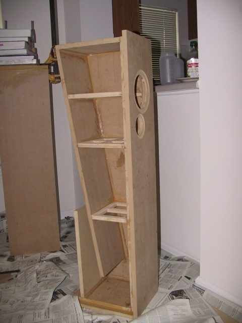

I almost have the Peerless Pipes done, I have to finish stuffing them, and glue on the sides and top. I was going to do it tonight, but went to the movies instead, and I can't find one of the crossover components that I bought... I will look tommorrow.
They both look like the below picture, except that one is stuffed and wired. Construction pics at: http://brian.darg.net
Construction was done with biscuits, yellow glue, then I put Silicon II in the corners.
Brian

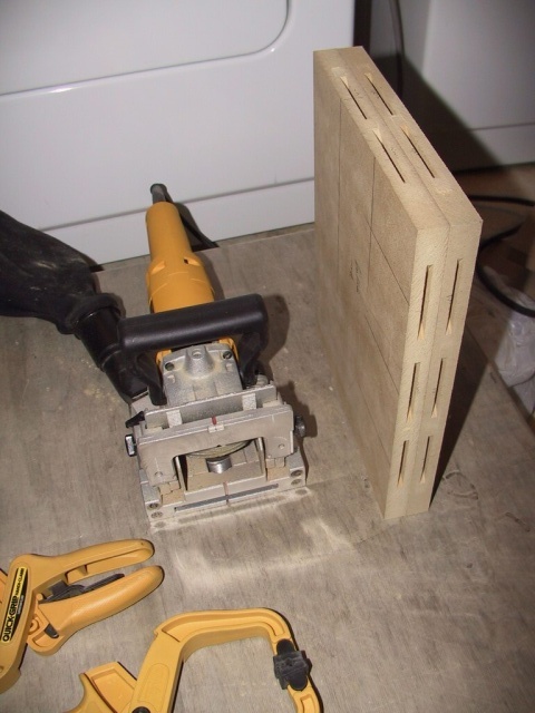

Involves using a plate joiner, then using a wooden "biscuit" to go in between the two pieces, and it expands with the glue to make a good joint. It also makes it easy to line up pieces when clamping.
Here is a picture of the top and bottom, ready for gluing, after being cut with the plate joiner.
Brian

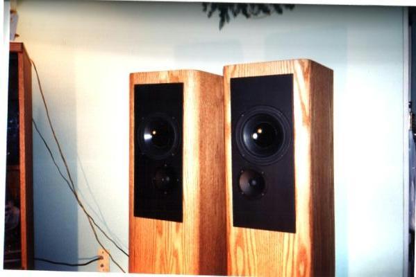

have my Peerless TL speakers playing
I got the speakers playing, with the side panel clamped on for now, the tweeter held in by masking tape, and the crossover sitting along side the speaker. My first impression is that the bass is quite there, going much lower then my jordan jx92s, and the highs seem a bit laid back. I will let them break in, then compare them to my Thor TL speakers, and my other speakers.
I went back and forth between the Jordan JX92S speakers and the Peerless TL speakers, and the Peerless speakers bass really stood out, and the mids and imaging really stood out with the Jordans. Definately not a thorough comparison thus far.
Overall, I am satified with the new speakers. Once they break in, and I do some more listening, I might change the tweeter to a Seas 27TFFC instead.
