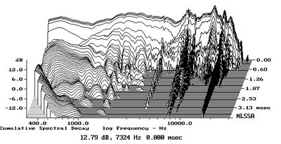

I found some measurements on the Martin Logan Aerius, that (fig. 7) does not look very pretty indeed. Then again we all know how hard it is to do good measurements on big panel speakers...
I hope this isn't too much of a distraction from the original intent of this thread, but since the issue of measurements of large panel speakers came up I'd be curious about other people's opinions. Atkinson (JA) wrote the following in the "Measurements" section of the link arend-jan provided:
The high treble is similarly hashy, however, while the low- and mid-trebles feature a number of resonant ridges.
Fig.8 MartinLogan Aerius, cumulative spectral-decay plot at 45" (0.15ms risetime).
As I explain in the Quest Z review, this kind of waterfall behavior is typical of panel speakers in that a large, uniformly driven, low-mass diaphragm appears to exhibit chaotic behavior. While the diaphragm's average position responds uniformly to the driving force, there are small areas which move more than the average and others that move less. I believe that such behavior is often mistaken by audiophiles for "clarity," "fast transients," and "transparency." I also believe that it tends to accentuate/exaggerate detail by surrounding each transient edge of the music with a little halo of hash.
It strikes me that the explanation is quite a stretch given the information available in the measurement. How can you determine from the SPL at one point in front of a speaker that some areas are moving more and others less, and doing so chaotically? And a "halo of hash"?
My main question, though, is why it is that crappy looking cumulative spectral-decay plots often do seem to be associated with large panels that many listeners think have quite clear transients. Can anyone shed any light on this?
Few
The explanation given is indeed completely bogus especially the 'halo of hash' for each transient which simply does not happen. On the other hand this panel has some serious problems if you ask me, that waterfall plot looks plain ugly. I have never seen such bad performance for the panels that I have measured myself. So I don't think it's that typical at all.

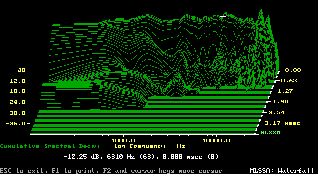

Few
See if you can find the one he did on a Quad speaker , I'm sure it was cleaner than that . The Hash is bad due to the early reflections from using a closed curved stator as opposed to a more open wired stator .
I had discussed this in the past with those that favor "holey " stators 😀
Good suggestion. While I was at it, I decided to explore a few other reviews of panel speakers and found there is more variability in the CSD plots than I had recalled. To save others the hassle of searching through the reviews, here are some of JA's published measurements of ESLs and one Magnepan:
Fig.8 Quad ESL-989, cumulative spectral-decay plot at 50" (0.15ms risetime).
Fig.11 Innersound Kaya, cumulative spectral-decay plot at 50" (0.15ms risetime).
Fig.13 InnerSound Eros Mk.III, cumulative spectral-decay plot at 50" (0.15ms risetime).
Fig.8 MartinLogan Prodigy, cumulative spectral-decay plot at 50" (0.15ms risetime).
Fig.7 Magnepan MG3.6/R, cumulative spectral-decay plot at 50" (0.15ms risetime).
These plots suggest to me that the curved stators of the MartinLogan panels may be more responsible for the hashy CSD plots than is the percent open area. The Aerius (see my previous post) and Prodigy seem to have some features in common, and that differentiate from the flat panel speakers. Of course, it could be some other ML design feature that's the real cause---the curved stator just strikes me as a likely culprit.
Stator construction and framing will be the determining factor in this, but your explanation 'early reflections' is highly unlikely. Think about the spacing between stators, which is typically a couple of mm, and calculate the wavelength.
These plots clearly show stored energy, which means resonances. This means material choices, dimensions and construction.
Here's a plot of the Quad ESL 57, also a flat plate stator but made from PVC.

Thanks for posting those measurements, very enlightening.
Thanks Few,
I would put most of the issues on early reflections and curve panels. Notice how clean the quads are in the middle vs the rest . Is there anything on the 63's, would love to see how the 63's compare...
Arend-jan
agree , now look on the panel as a whole and it's accumulation of such. Now perform the same test on a smaller panel open wired and closed perf.
It is not coincidence the quad is pretty good in the middle vs the rest and bad on the top ...
The maggies have the same issues as the perf stator ESL's with it's frame and grille structure make them naked and rejoice ...
I'm having a harder time coming up with good clear measurement results on the ESL63. Here's something extracted from Martin Colloms Nov. 1991 review. Unfortunately, it's just a badly scanned image of the results. An OCR-ed version of the review (with slightly easier to read plots) can be found here. Note that the two CSD plots differ in the dynamic range they span--the upper one is 30 dB and the lower one is 60 dB--and these are to be compared to the 24 dB range displayed in the previous plots. Varying the vertical scale makes a big difference in how clean the plot appears.
For what it's worth, I agree with aren-jan that the typical stator spacing (1 - 2 mm) makes it unlikely that reflections between stators cause the hash.
Somewhere I saw a nice explanation of the sources of features in CSD plots. The point, as I recall it, was that ridges along the time axis can have several causes, not just resonances. I wish I could recall where it was; I'd like to reread it. In any case, has anyone ever seen a CSD plot from the back of a curved stator ESL? I'd be interested in what you get if you put the microphone at the focus (center of curvature) of the diaphragm. I'm curious whether making all points on the diaphragm the same distance from the microphone yields a cleaner result. Of course this would only work for all points that are also the same height above the floor, but maybe it would at least hint at whether the panel curvature is responsible for the CSD behavior.

Guys ,
I'm not pointing to stator spacing as the culprit , never said that , I'm stating that the accumulated baffle (stator ) is creating so much reflections , this reflective energy is creating the hash . A perf panel will do so more that others unless the panel is pretty small . Nothing to do with stator spacing .
@Few
Were you thinking about group delay showing in CSD plot perhaps?
@Wayne
If not reflections between the diaphragm/stators, what reflections are you talking about then?
@Wayne
