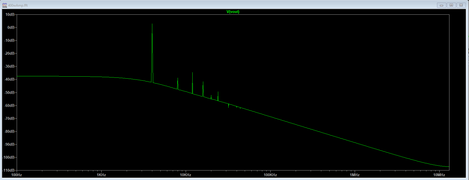

I translated this board to ltspice and I am getting 11% thd on it. Can someone confirm this for me. My asc file is attached. I am new to using ltspice so although I have checked my settings several times, I may be doing something wrong.

The tails of the long tailed pairs are shorted to ground at AC, one of the zeners (D4) is reversed, the values of R23 and R24 are far too small and preventing Q9 and Q15 from ever conducting - likely to be more issues that fixing those should get the feedback loop working.
I think you invented R23 and R24, just remove them. And some of the 330 ohm resistors should be 220 in the current sources I think. The only 330's are in feedback and input networks.
You may have the topology wrong, I don't see enough gain for the feedback to use. Shouldn't they be current mirror loads?

Removing 23 and R24 Brought the THD down to 1.8% I corrected D4 Also.
You were correct about the Q19 and Q7 Resistors. They are supposed to be 220 not 330.

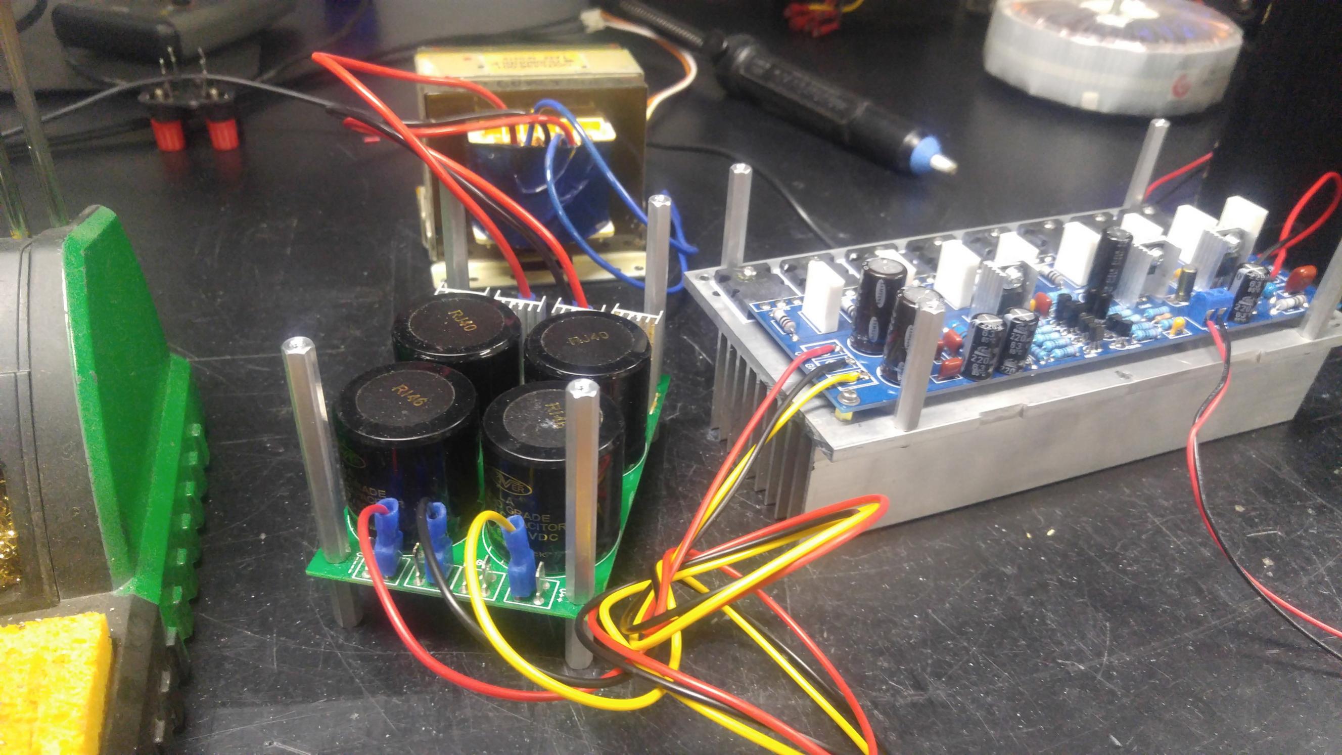

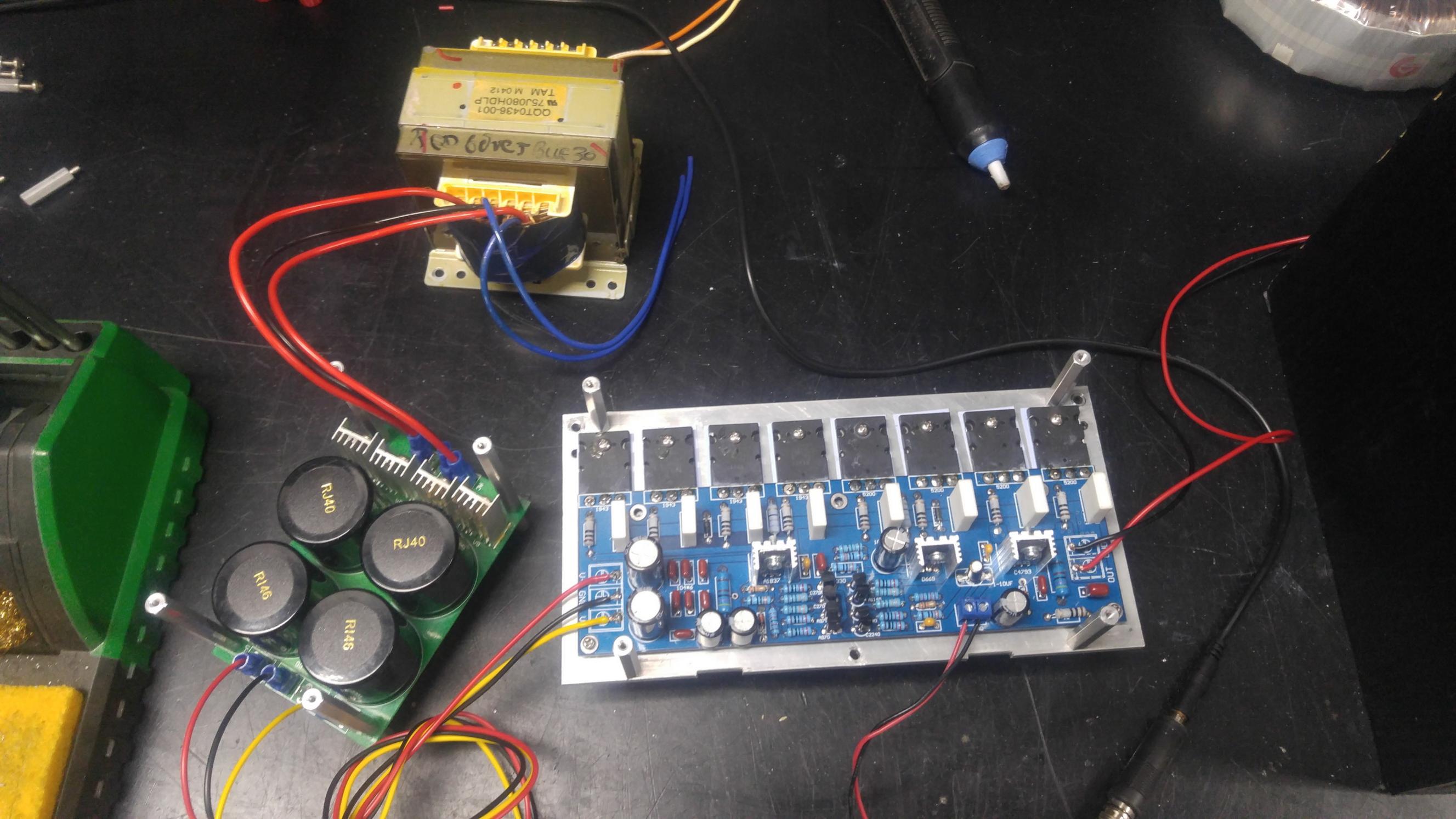

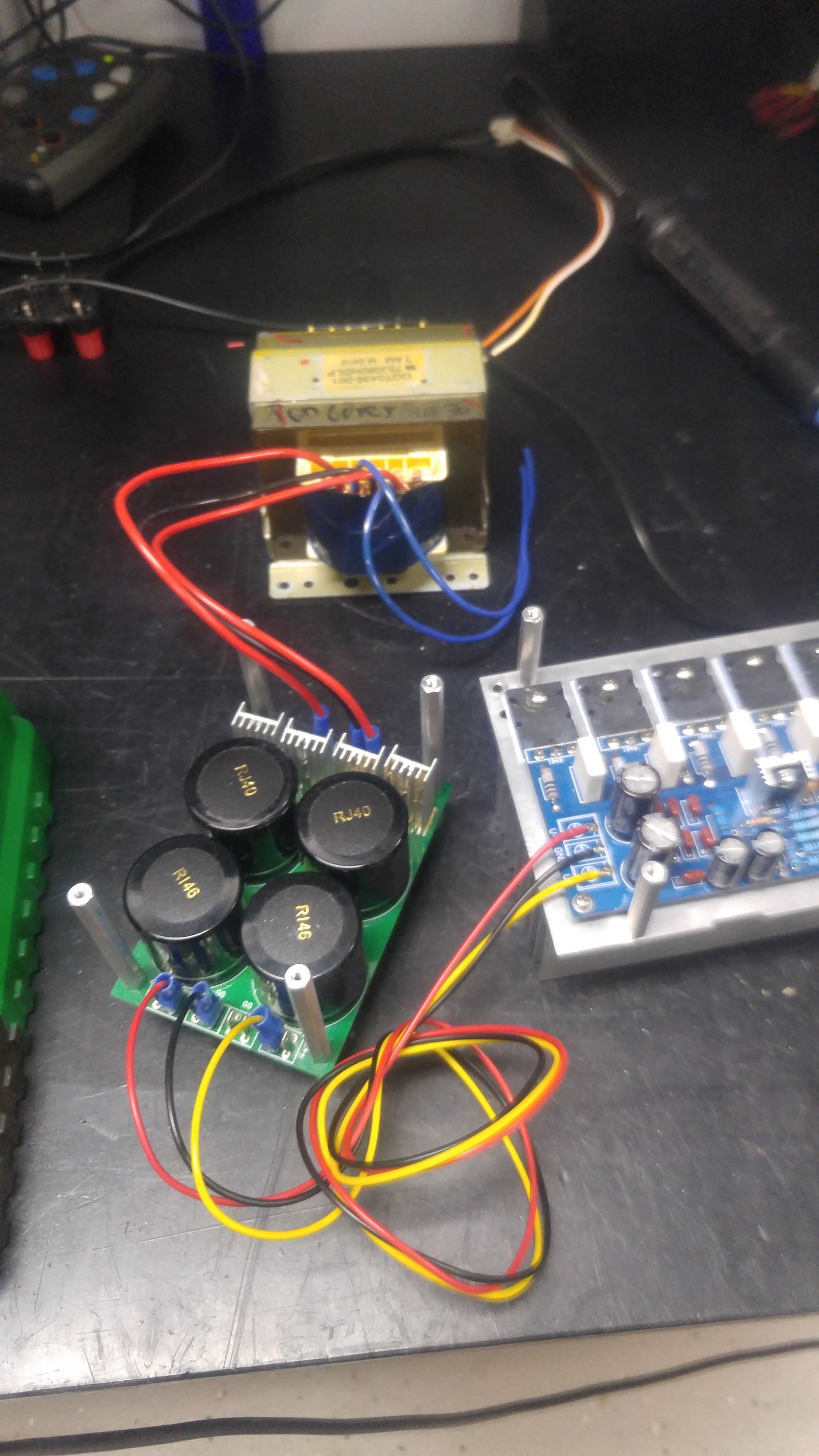

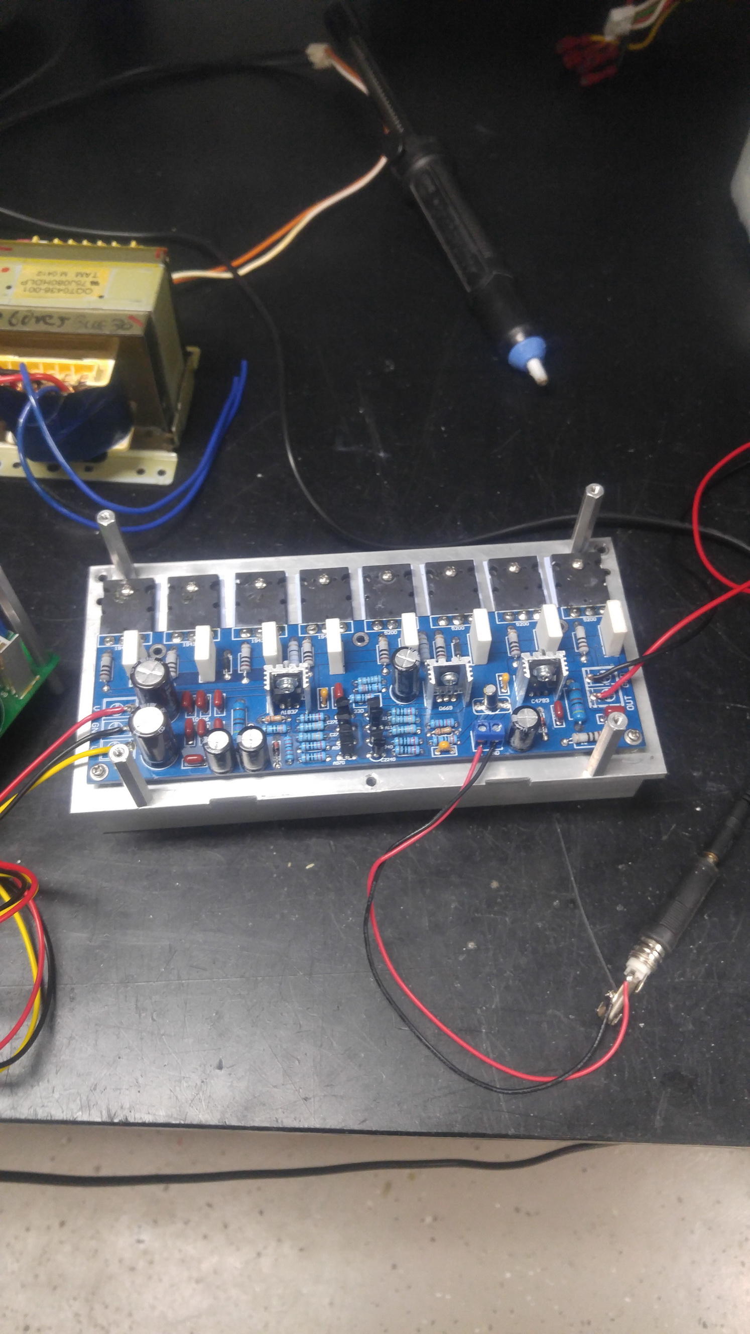

OKY DOKY... I replaced the 2SD669. Check for DC Offset and fired it up again. It actually sounds half way descent but it crapped out after about 1 Hour. It started getting too hot. Way beyond the 3 Second rule... I couldn't hold my finger on the heatsink at all. I think it may require a lot more heatsink and possible some air flow. I think the forward bias is too high too. I still need to verify where it is at. But I need to let it cool off some first.
Pics attached.
Do you guys think this heatsink should be enough?
What would you shoot for on the forward bias? Most of the amps I have worked on it is about 600mv.

With input shorted together, measure voltage drop across an emitter resistor and divide by the resistor value to get the bias current. Example: 19mV DC measured across 0.22 ohm emitter resistor = 0.019V ÷ 0.22 ohm = 0.086A. For class A/B, bias current should be from about 25mA (cool) to 50mA (warm) up to 100mA (hot). Check all separately to see if they are balanced and adjust accordingly so none are over biased. You should be able to adjust the bias current down and get a definite change in heatsink temps.
Not Measured across resistor due to access issues. Measured from emitter to speaker out terminal so values will be a little off. There is not an on board coil. The coil is on my protection circuit.
A1943-1 4.3mv 0.22ohm 19.55ma
A1943-2 4.2mv 0.22ohm 19.09ma
A1943-3 4.3mv 0.22ohm 19.55ma
A1943-4 4.5mv 0.22ohm 20.45ma
C5200-1 4.7mv 0.22ohm 21.36ma
C5200-2 4.6mv 0.22ohm 20.91ma
C5200-3 4.8mv 0.22ohm 21.82ma
C5200-4 4.9mv 0.22ohm 22.27ma

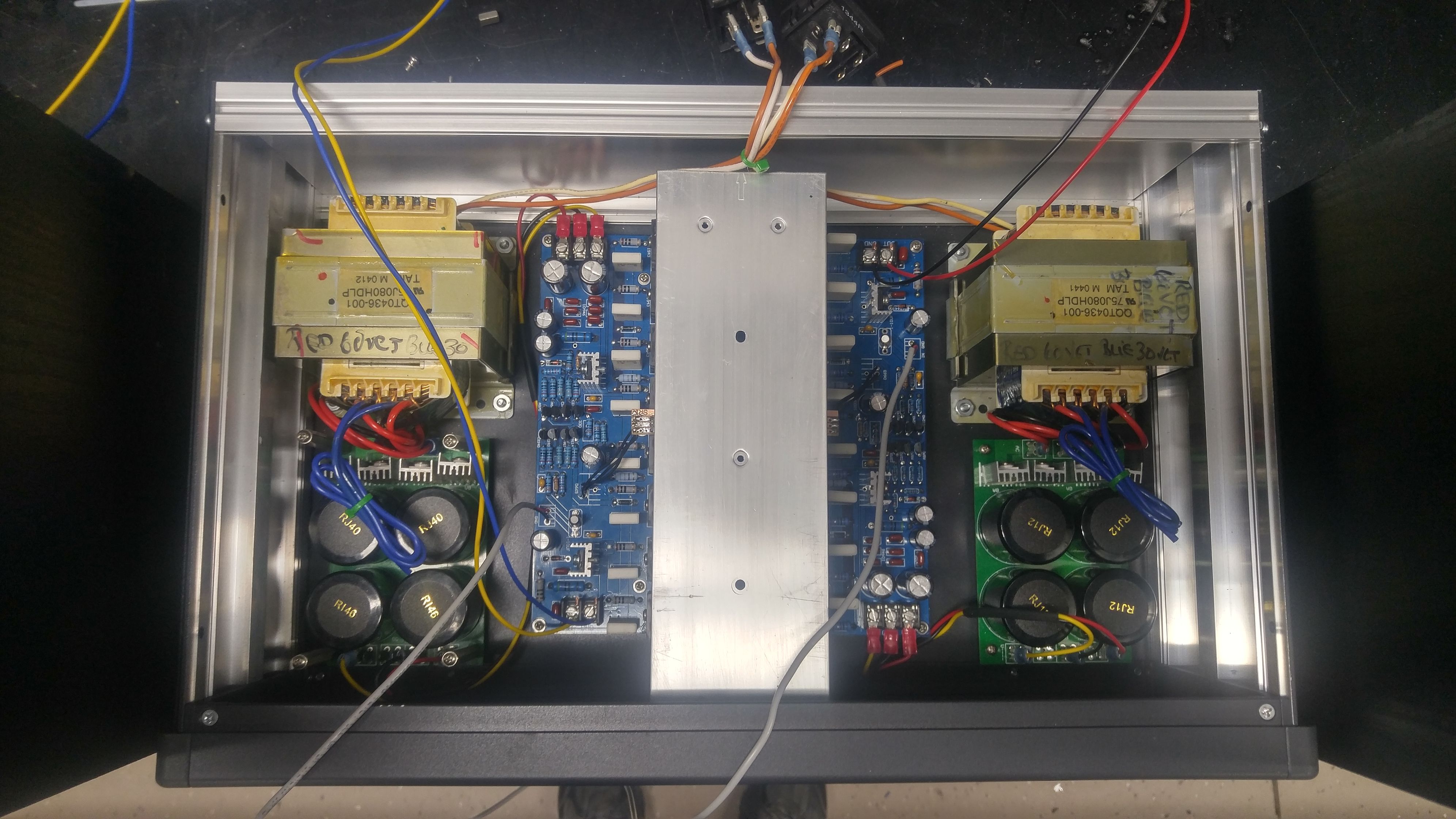

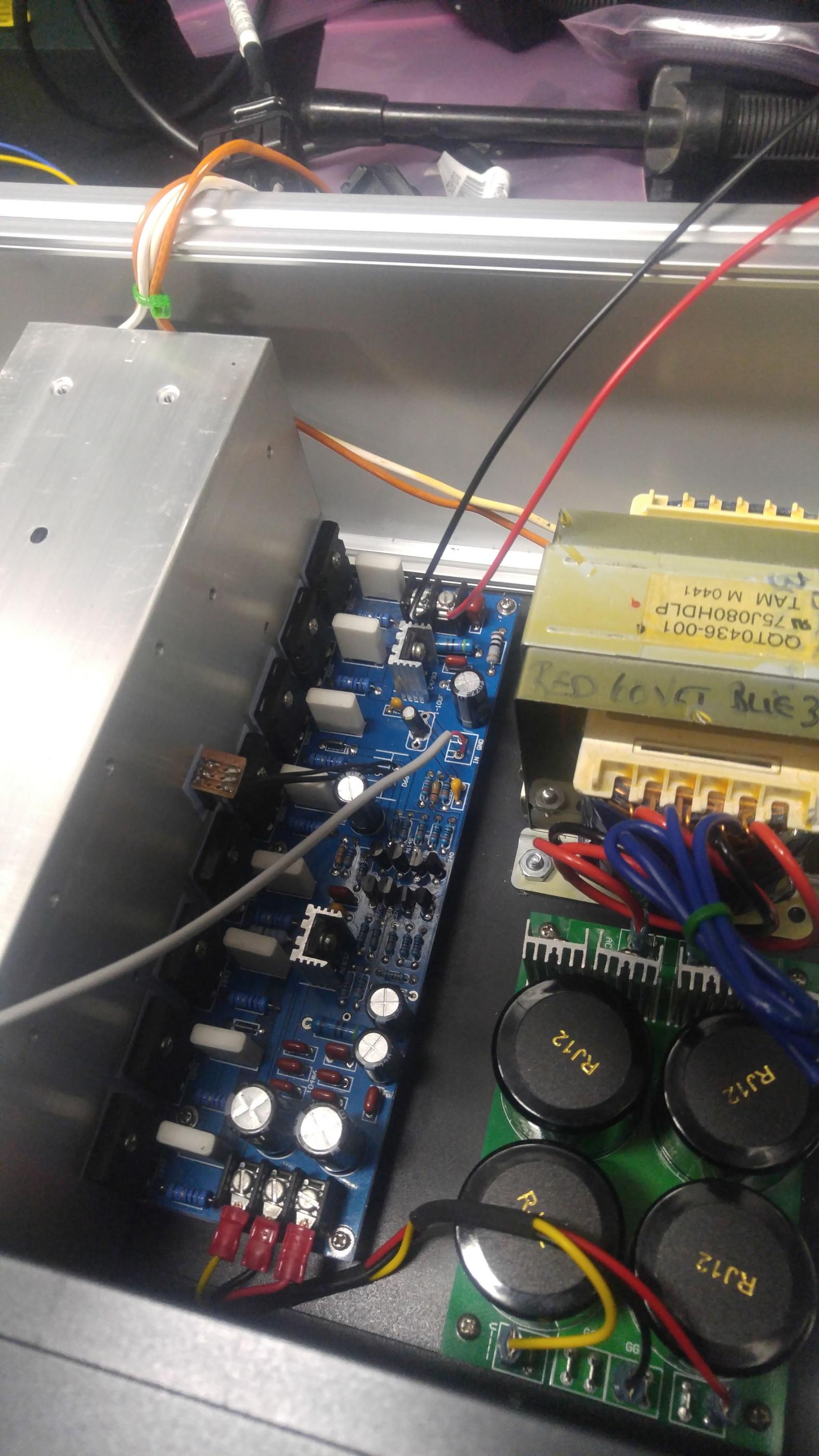

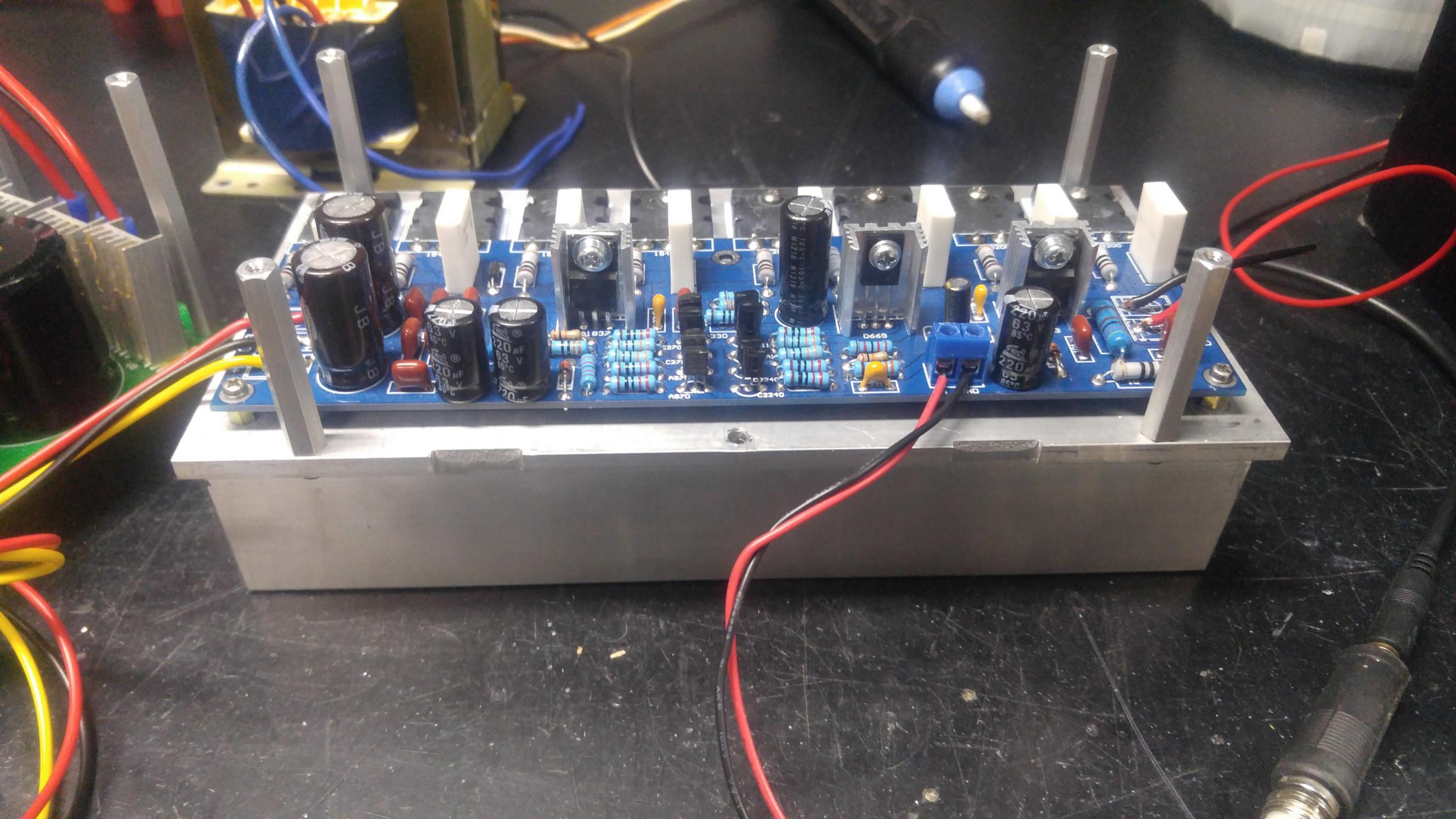

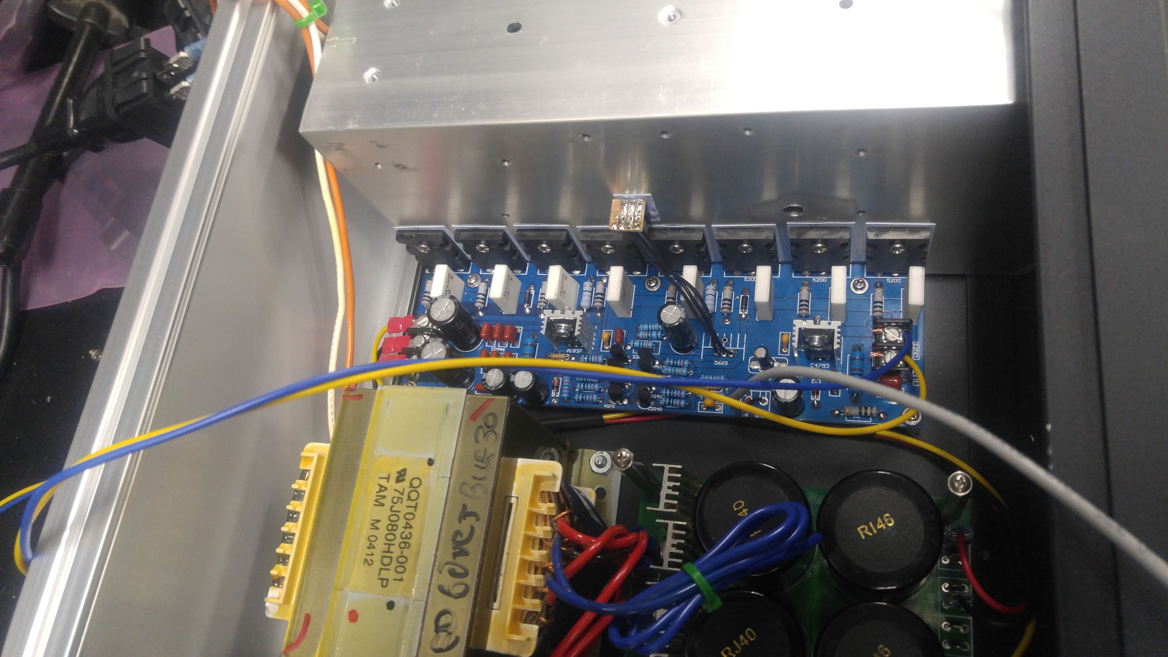

I have been looking at some videos on amp design and I am finding that I really need to move D669 to the same heatsink as the outputs. So that as it heats up it will change the bias characteristics. I am just trying to figure out where to mount it. Not much room.

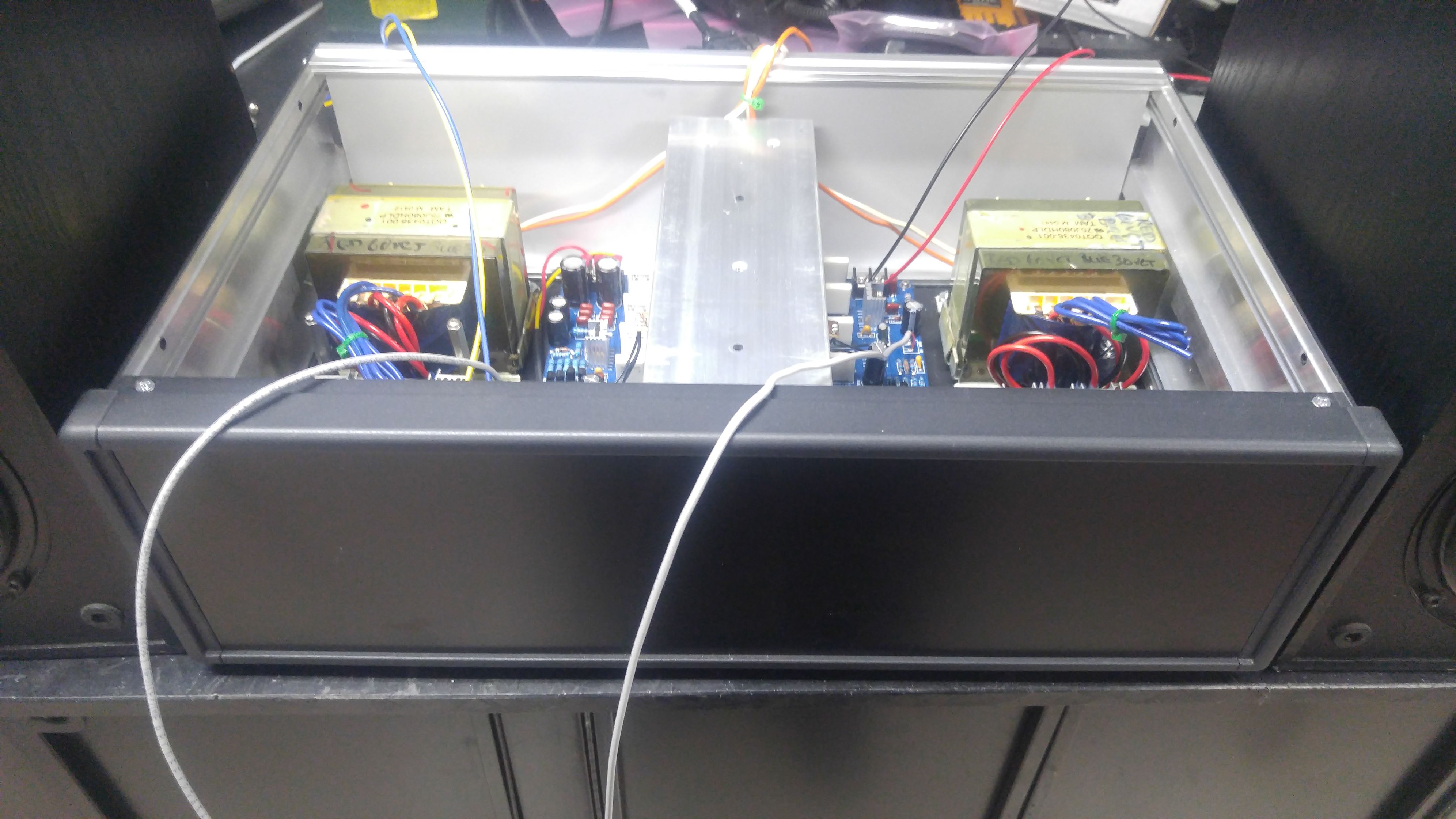

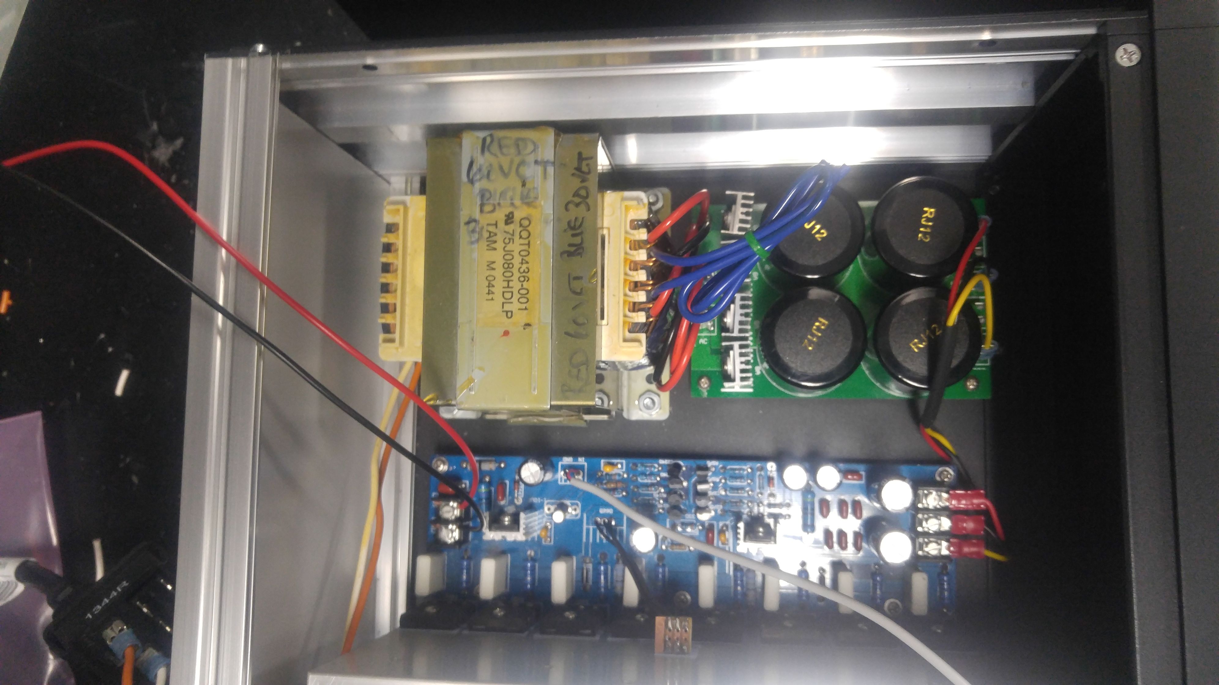

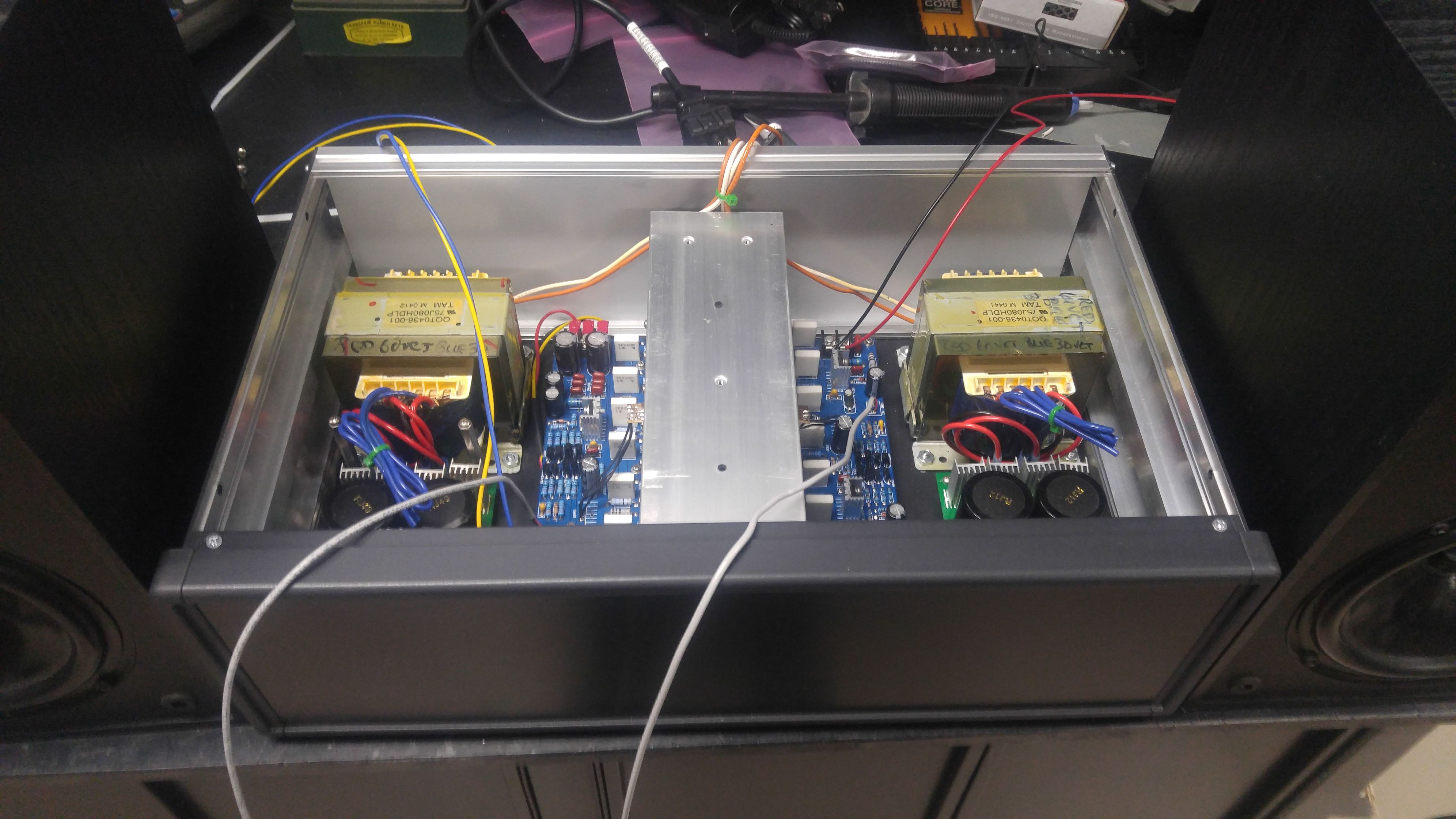

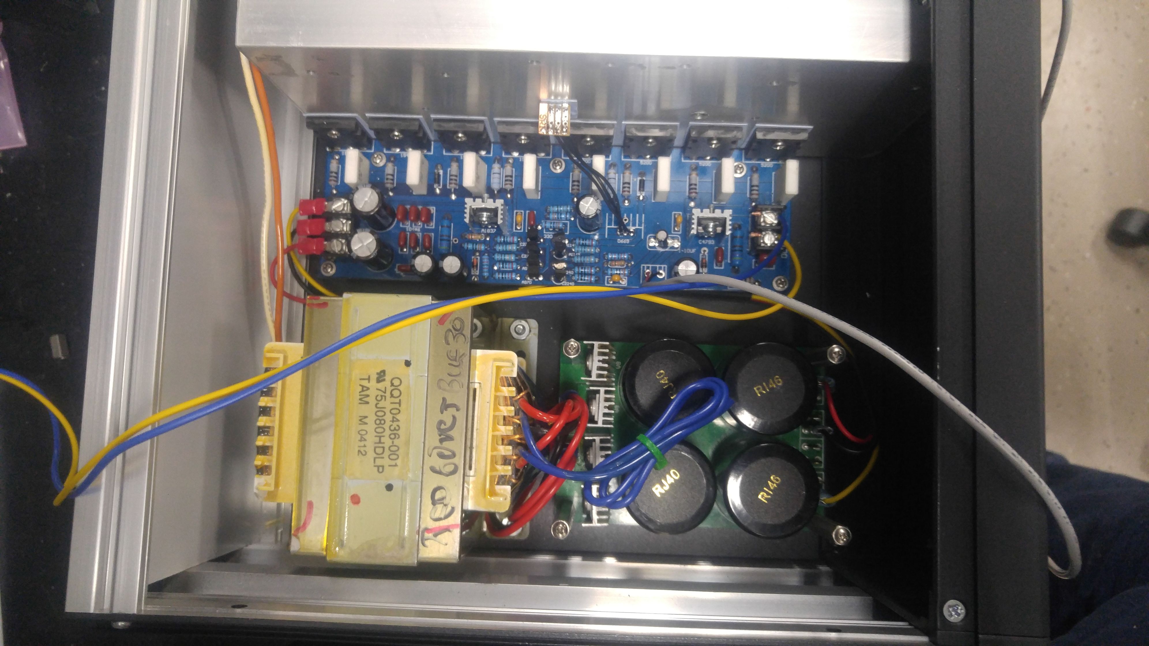

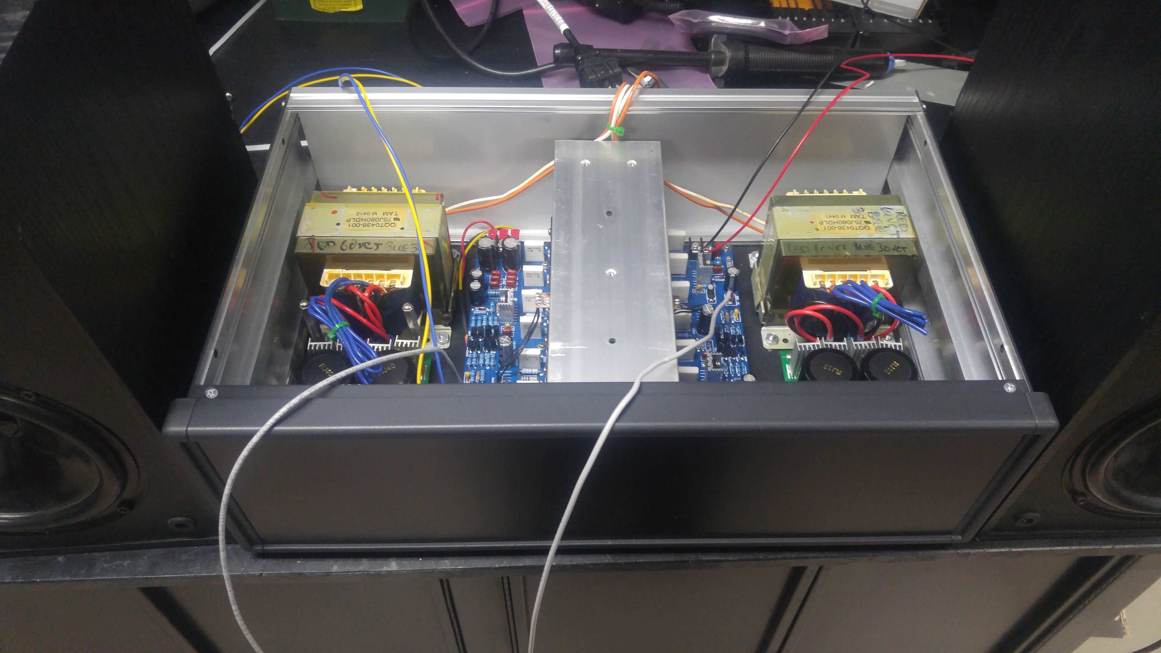

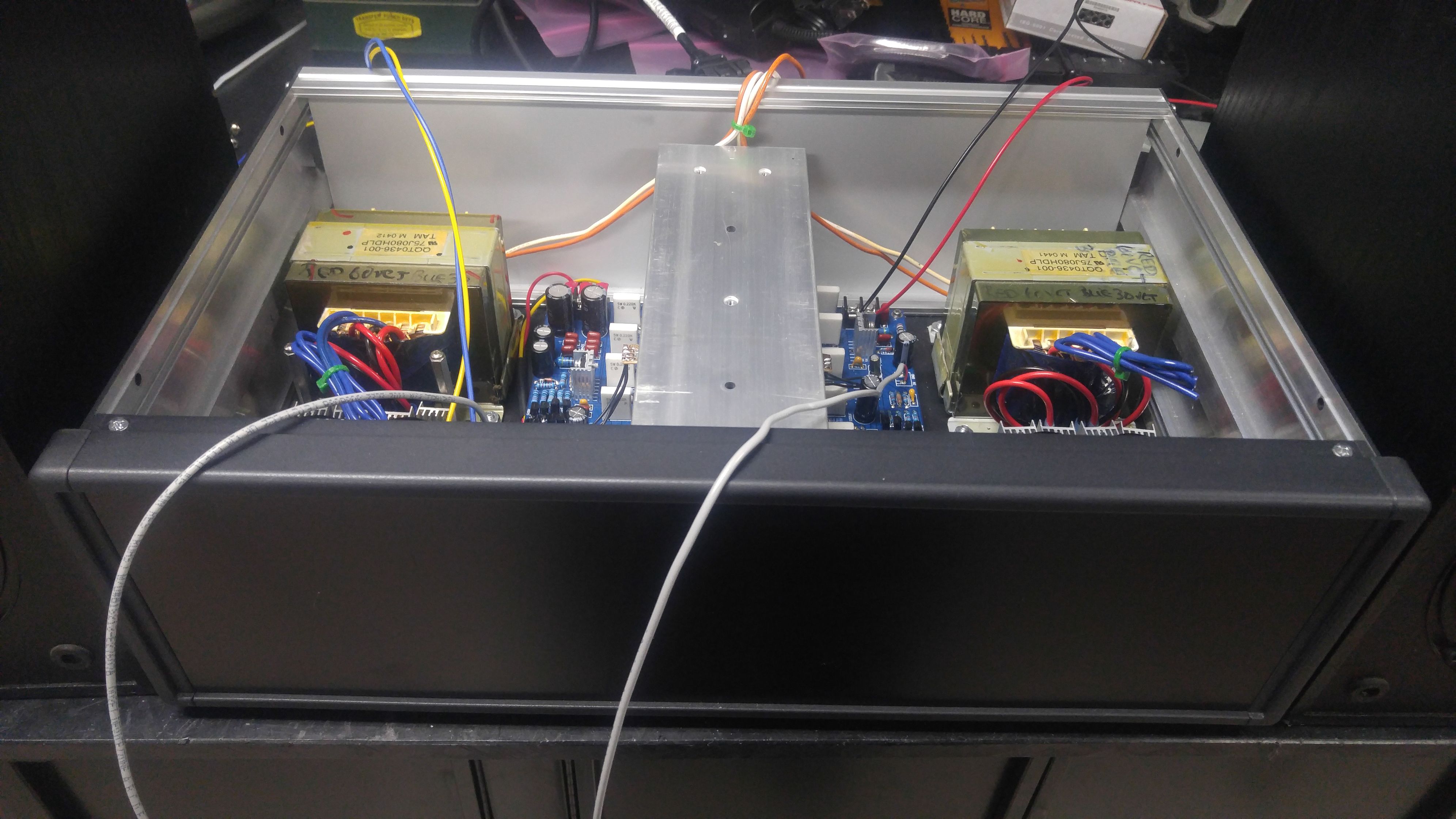

I relocated the Bias Transistor to the heat sink. It has been running for about 1 hour and is not even warm. Still working out details of build but here is what I have so far.
Not too bad for less than 75 Bones. Keeping in mind there was a lot of scrounging parts involved.
Heat Sink is rescued from my Ramsa WP1400 that was totally fried.
Transformers are from a couple of old JVC Subs.
Case was a excess from work that there were scrapping out.
I still need to add Zobel network, Speaker protection and mount everything in the panels.
