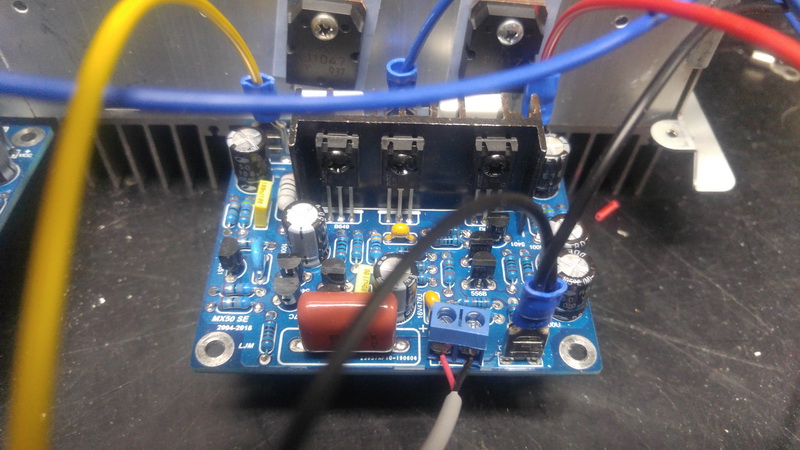

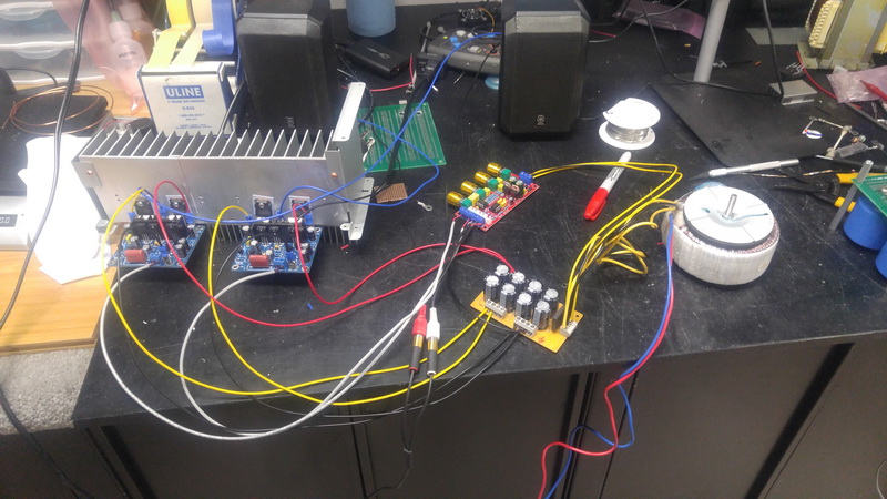

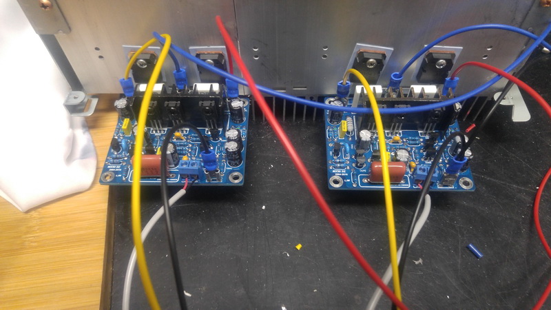

Bias Current is 20ma
Did you mean 20mV measured across one of the 0.22r resistors? 20mA would be 4-5mV across that resistor, which seems low.
Also wondering how hot the heatsinks get after 30-60 minutes of music? Pretty beefy heatsinks, but curious how hot 4-pairs of BJTs get.
Trying to plan out a 5-channel HT build and I'd love to use 4-pair BJTs at +/-65Vdc, but not sure my heatsinks can handle the heat, as cramped as the chassis will be with everything installed.
edit - any turn-on thumps, or weird noises? Hum, hiss, etc. when it's on but not playing anything?

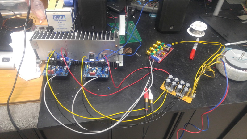

Measured the across the 0R22 resistors. It was 20ma not 20mv. I did not use an adjustable bias potentiometer. I might try replacing the 330 ohm and play with that. I am keeping the bias low until I prove the circuit is stable.
Ran it for 4 hours today with the volume up enough that you could not carry on a conversation with it playing. It barely got warm. You could feel a little heat from it but not even close to be of any concern. There is a slightly notable noise floor that you can hear if you get your ear right up to the tweeter. No turn on thump. When you power it down with a signal applied it will run for 30 to 45 seconds before the filter caps drain enough to shut down.
I had a heat issue to start with. I relocated the D669 Bias transistor to the heat sink and it cured the heat issue.
Noise floor could be from the 12 foot cable I have running from my laptop to it. I think it is in the amp though. I actually think is has to do partly with the cap boards I used. They are just the bridge and 4 filter caps. There are no bleeder resistors or .1uf cap on them. Not the best filter board. However it is 40,000uf of capacitance per channel.
Next step in my tinkering with it is to hook it up to a 4 ohm 200w load resistor and see if I can get it to heat up running hard.
Then add some bleeder resistors and small caps. See what that does to the noise floor and shutdown time.

Thanks for temps, very thorough.
What about hiss/hum noise? Did you get that resolved or lessened?
Most important - how does it sound?
It sounds very good. I need to hook it up to a sub-woofer and see how it does with low bass.
Noise was a really dumb. It was my Cable. I moved it and the hiss went away. New cable solved it.
I am currently working on the other 4 Channels. MX50SE. Still in the messy stage.

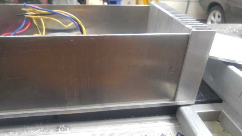

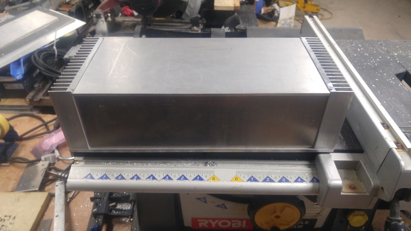

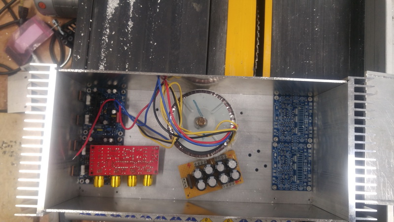

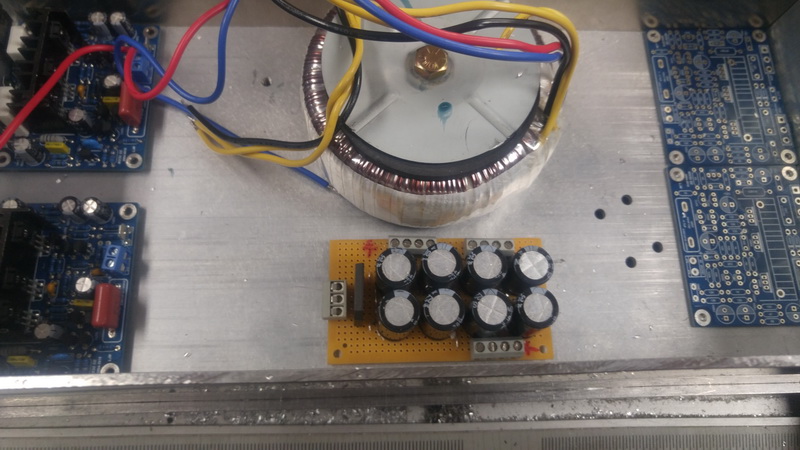

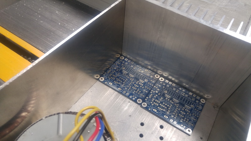

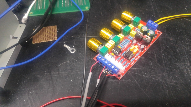

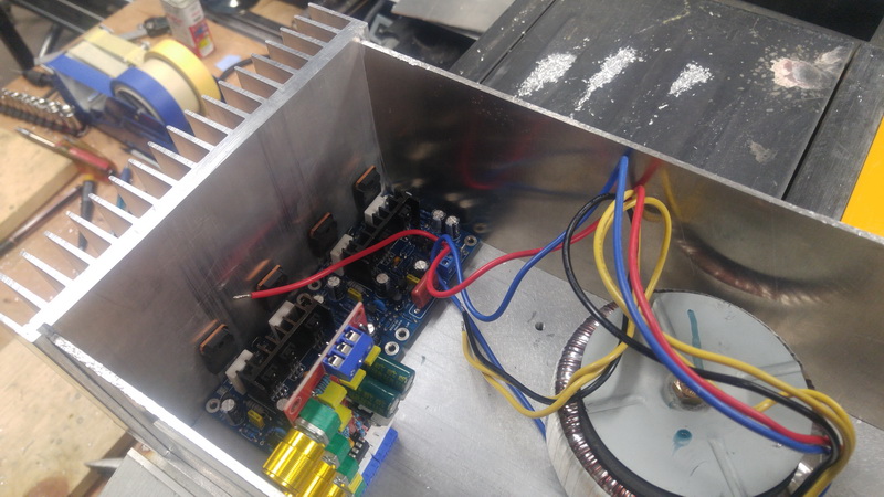

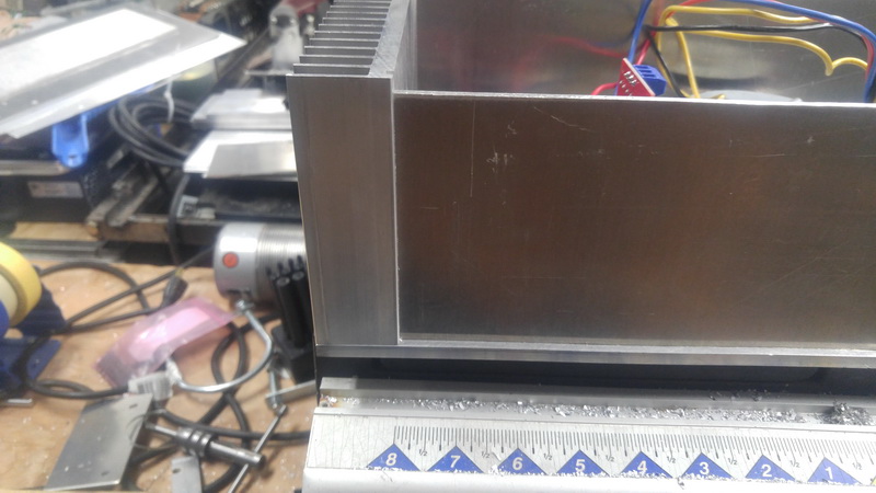

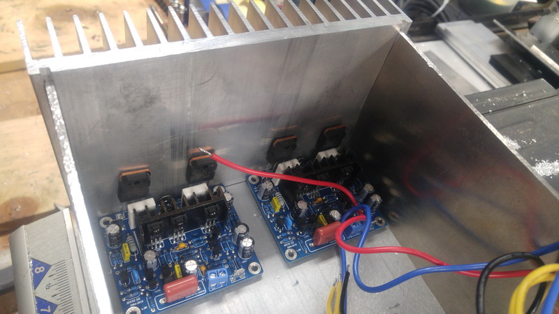

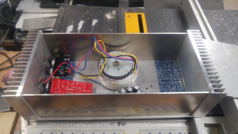

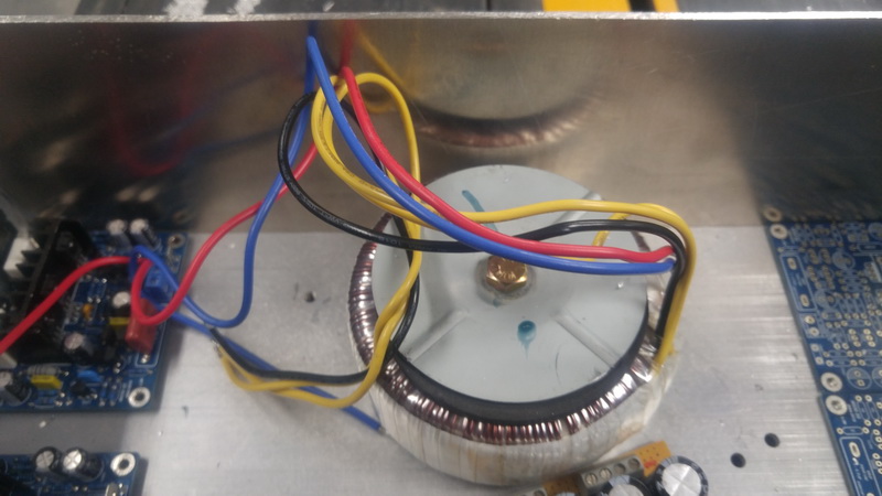

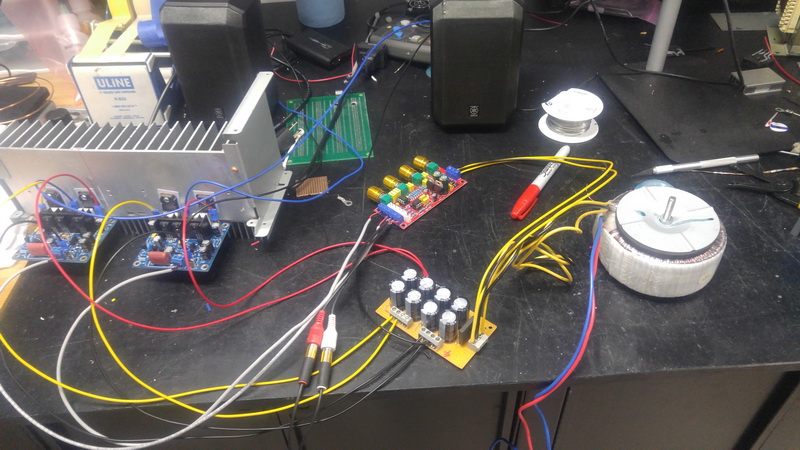

Update on the MX50SE Case. Work in progress.

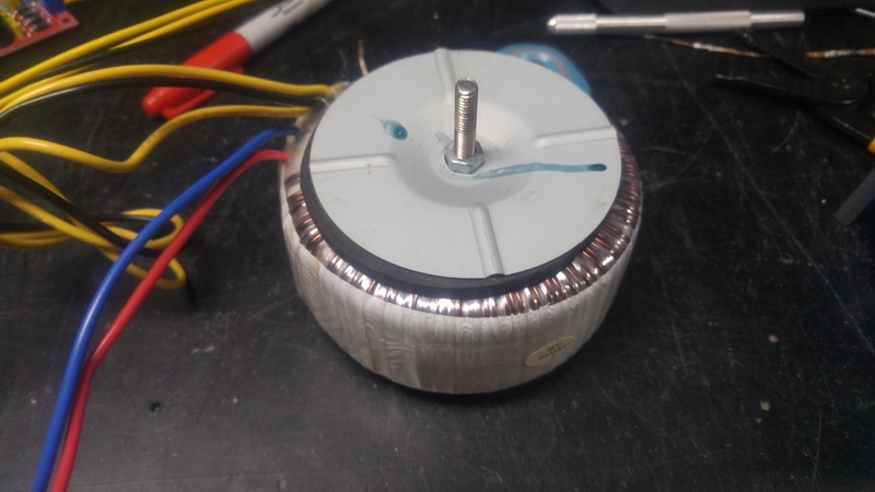

Hoping to find a bigger transformer. This one is on the small side. It is 250VA 48V (24 0 24) After rectifier.

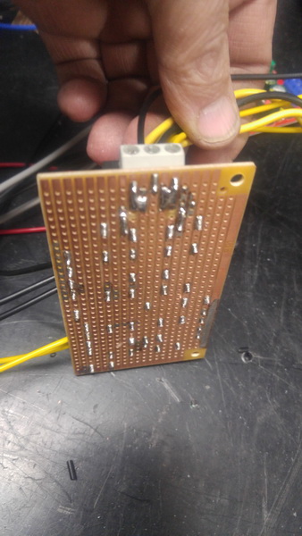

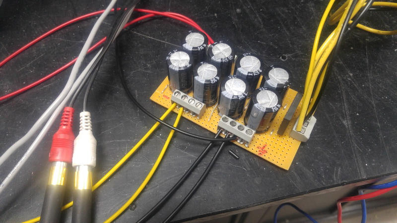

MX50SE is a pretty nice kit. Sounds and measures better with the Sanken transistors, but KEC is ok to. Cranking up bias makes it even better when listening at normal levels. I would recommend a bigger input cap if you plan to use them for bass too.
Caps in PS look a bit small?
The cap board was tossed together with what I had laying around. It is definitely not the final one. It is the bare minimum to test the boards with.
Caps are 2200uf at 35V (8800uf per supply) I will probably change the caps to 4700 @ 50V and upgrade the transformer to a 600va at 30-0-30. Or add another toriod just like this one that I have in a box somewhere.
I want to see how it would do with Toshiba A1943 C5200 but that's a project for another day. Plus I need to see if anyone has any luck with them.
Which Sankens are you referring to? Do you mean the 2SA1494 2SC3858 Pair? I think I have a couple of those laying around somewhere. I definitely have several pairs of the Toshiba's
The bigger amp earlier in this thread is for my subs.
Ok.
I mean 2sc3264/2sa1295, they have been sold as a kit with mx50se too.
I'm testing MJL 1302A/3281A, and they seem to measure good on distortion too, and seems stable. Iq for lowest dist, more than 0,2A, you can try up to abt 0,6A if you have enough heat sink capacity.
